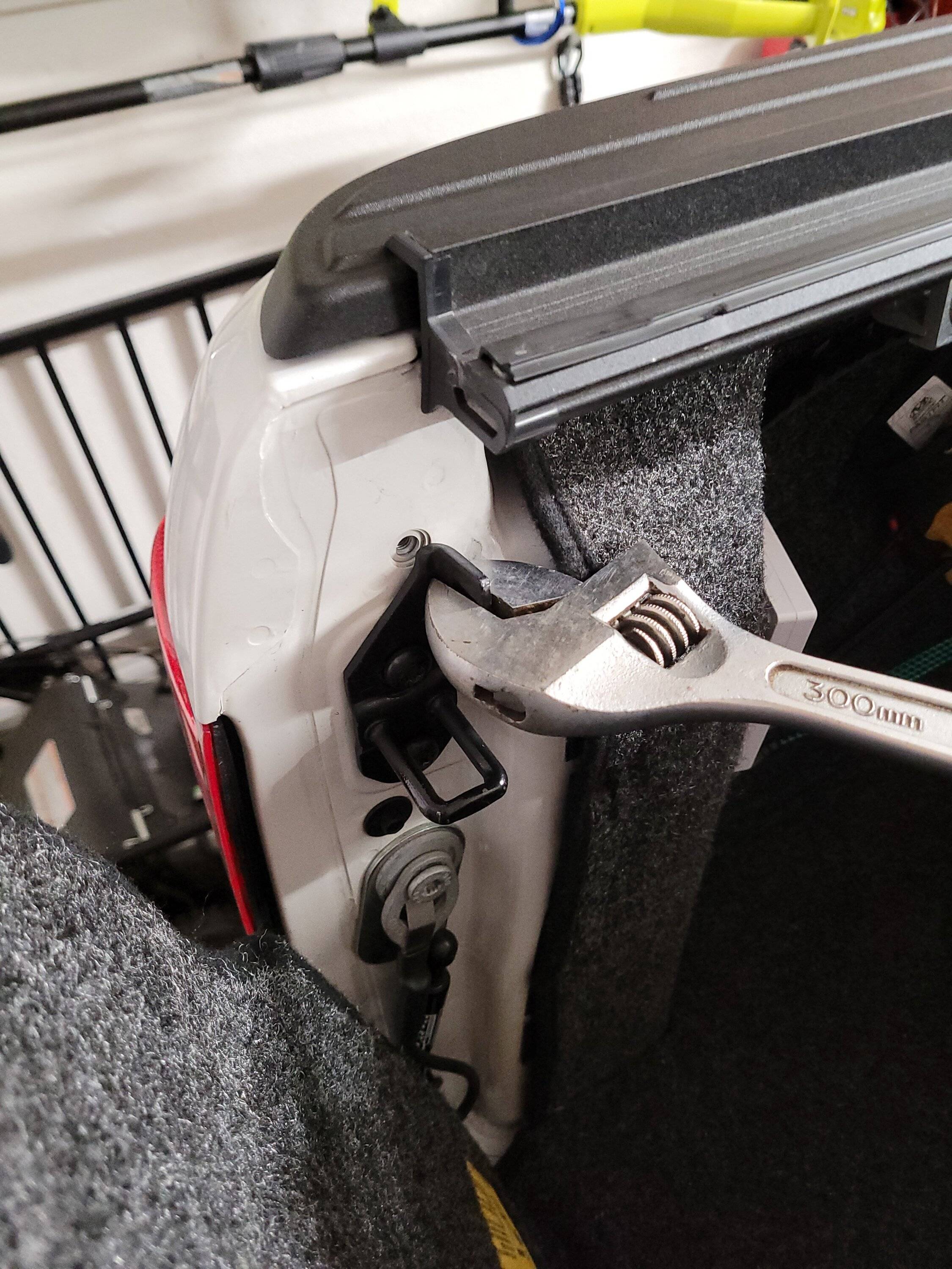

Bump... my tailgate won't open. Same symptoms as OP prior to today but today it just will not open... Any ideas from the members?

Have you tried the key? Probably did. Push hard like you’re shutting then pull open latch handle and release suddenly. It happened to me once and took a few tries but it hasn’t happened since because I started shutting it more solidly.

I had similar problem after my first post. I tracked it down to the left cable getting trapped by the Dee Zee tailgate damper. So my fix was to make the cable fat with sticky velcro at the tailgate damper and have not had the problem since...

Yes I did... luck, I need it I will have to cut through the torno

See if you can release tonneau cover first, I hate you’d have to do that. Some sneaky way. Try a few different approach methods…frustrating as hell I get it. If you must cut then it would really suck.
