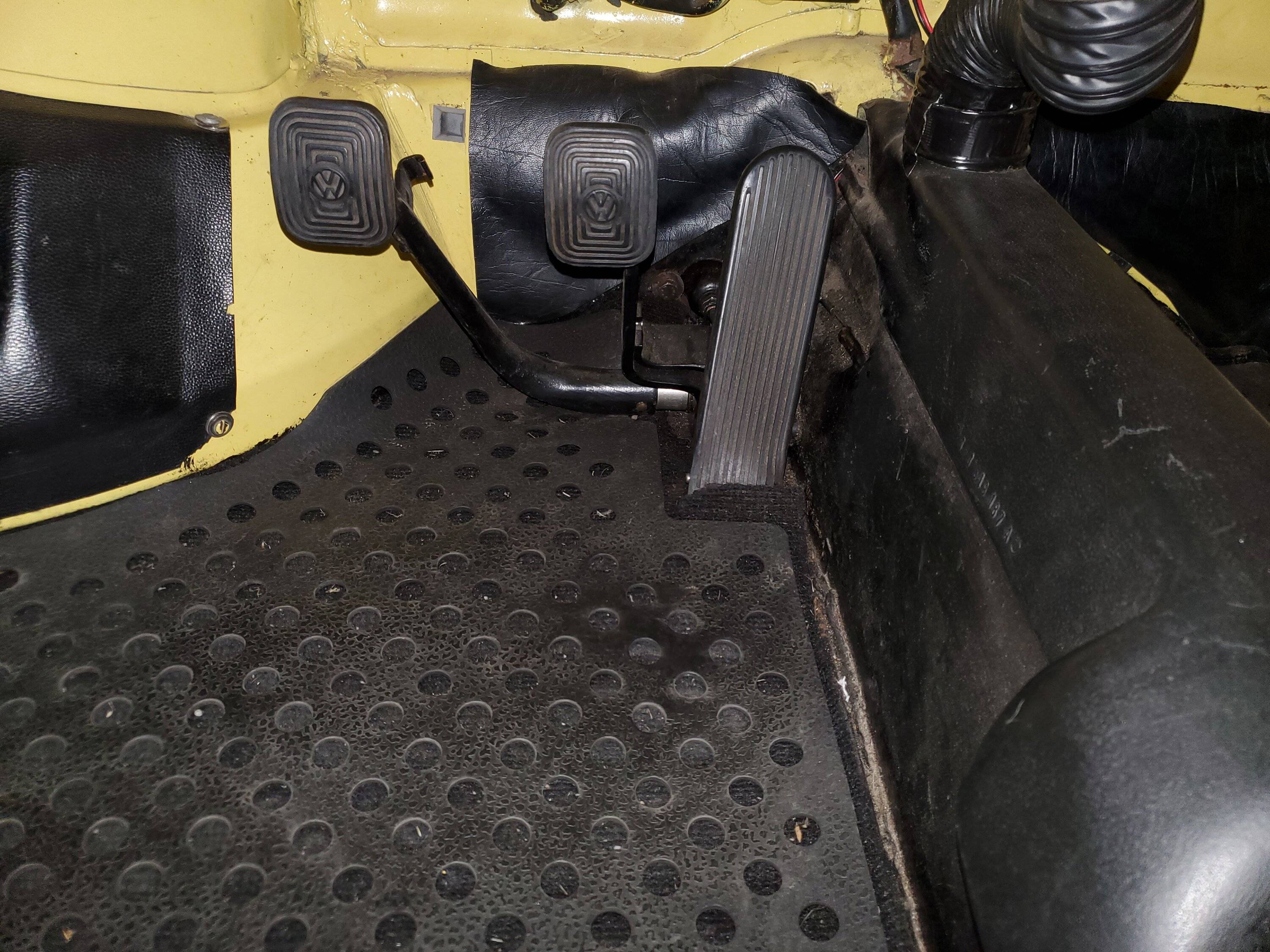

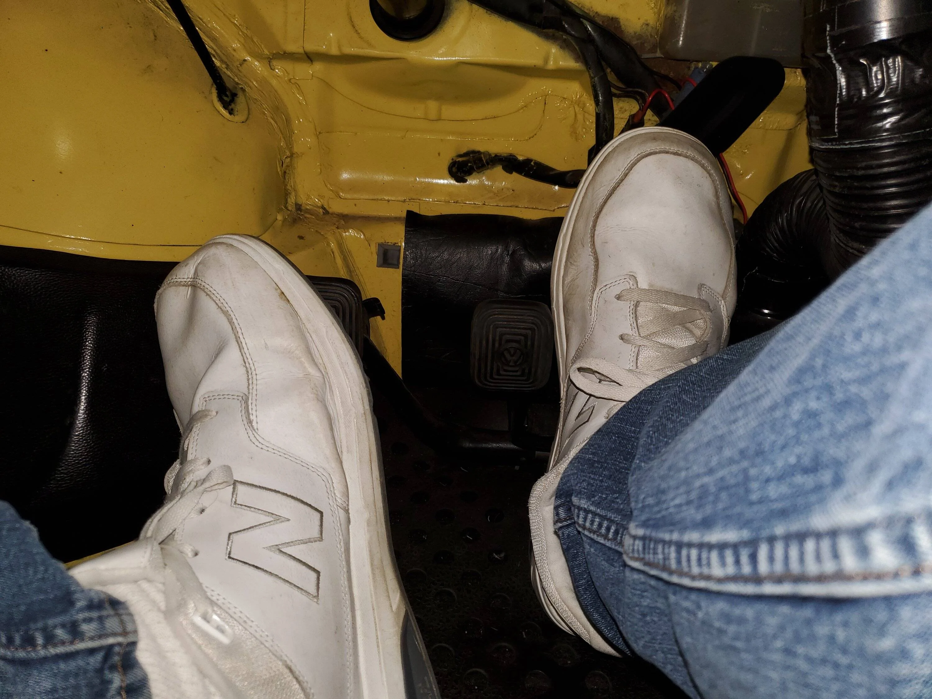

I have had my size 16s on both the gas and brake too. Have learned to not be lazy with my foot movement.
You want to see some difficult pedal placement...
Try getting a size 16 shoe off the gas and onto the brake with this spacing. I can't wear boots driving it and usually go bare foot once the weather gets warm. The clutch has been moved over about 1" to allow better control. You can see the silver spacer next to the gas peddle.
And yes, white NBs. They are the most comfortable shoes I've found that fit.
Nope, Converse Chuck Taylor All-Stars. They have a few styles I can buy in a wide size, they are the best driving shoes I have, very good pedal feel, but I've not bought actual racing shoes yet.
