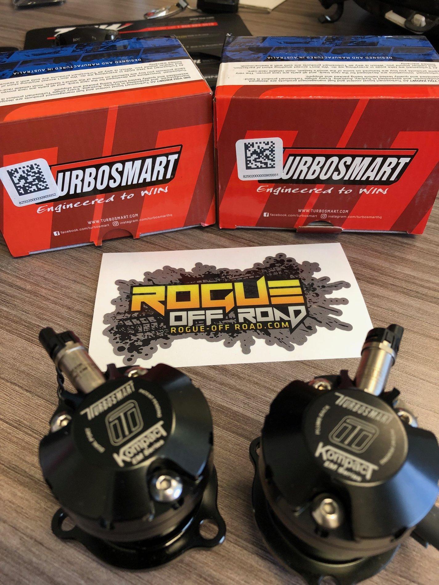

What’s the difference between the two? Just the sound or is the duel port actually better?
one is a full recirc unit and one is a dual port which vents to the atmosphere
The difference is that the re-circ operates just like stock venting only to the re-circ port back to the intake and is quiet. The dual port has progressive ports so that up to 50% lift it is re-circ only and after 50% valve lift (higher boost/throttle) the atmospheric port is also opened doubling the flow and allowing the vented pressure to be heard - whoosh.
