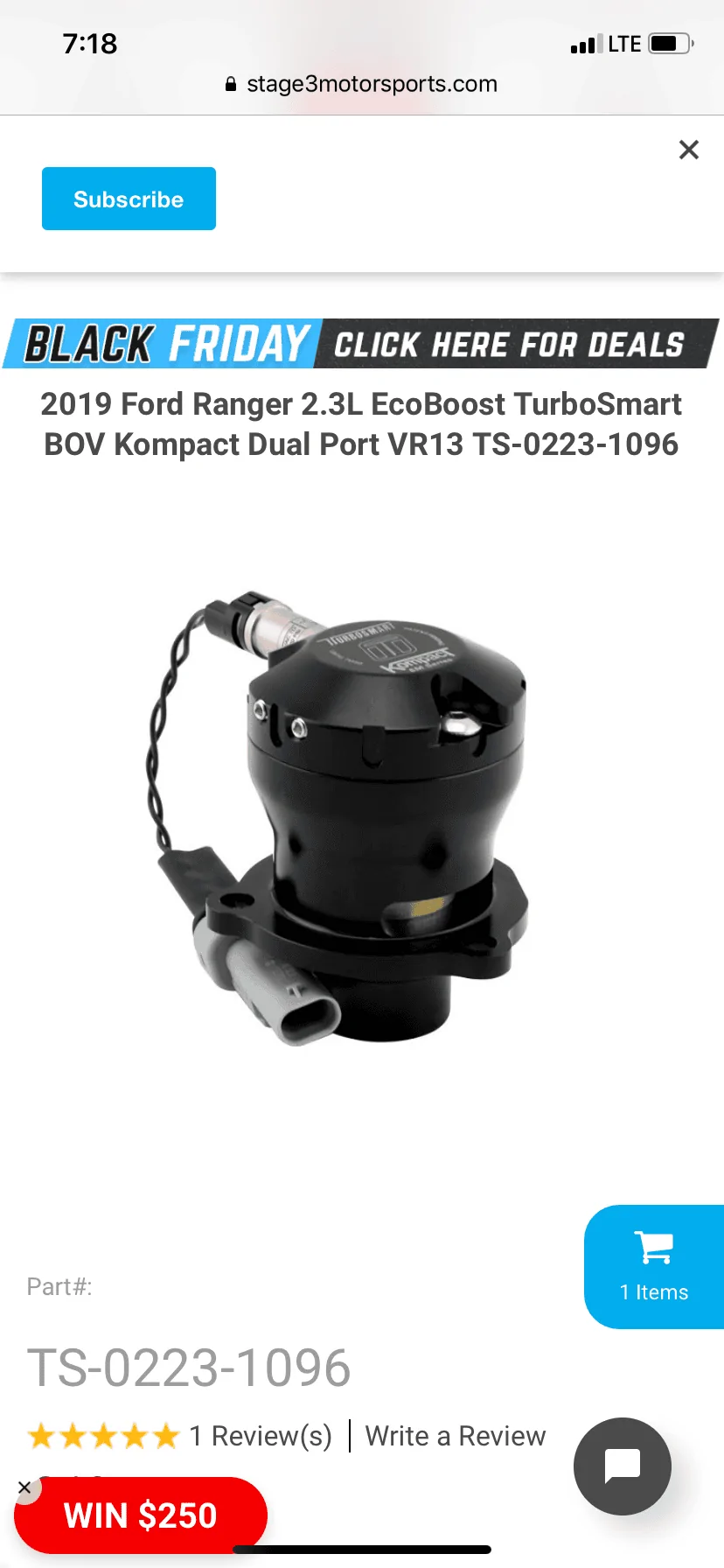

Has anyone tried this over the GFB DV+? I'd like a replacement rather than modifying the factory part. I did install a gfb dv+ in my 2017 Fusion Sport and liked the results but if I wanted to go back to stock id have to replace the whole unit.

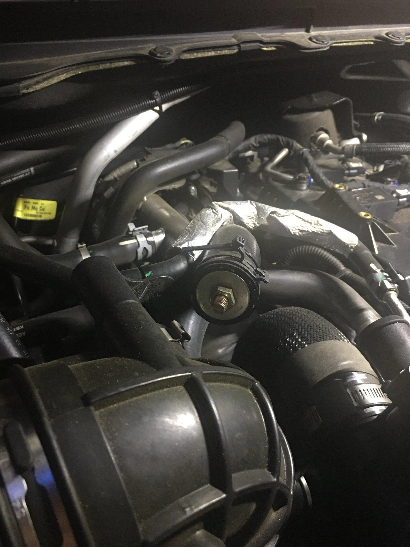

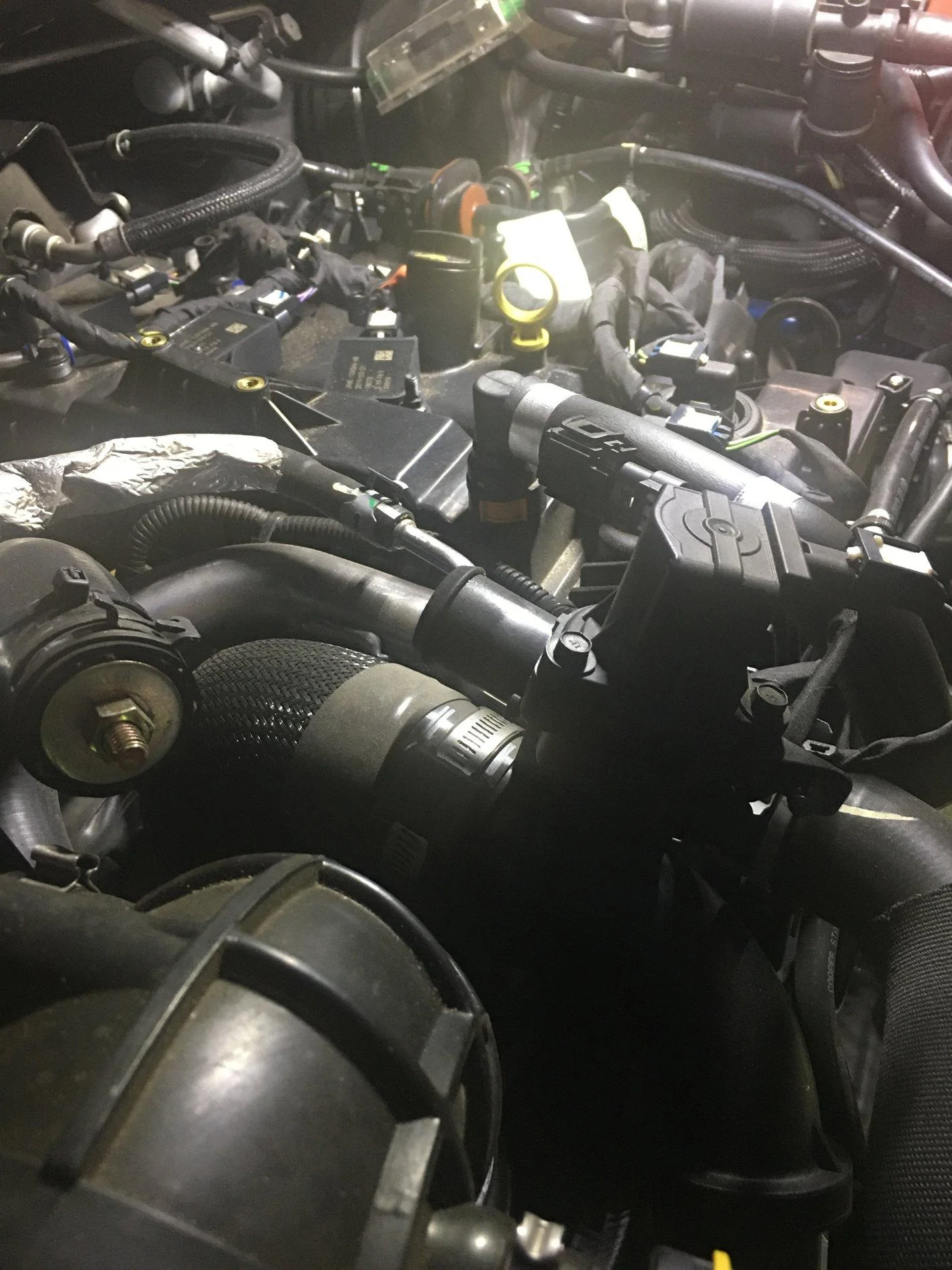

I just vented to factory BOV to atmosphere. $3.99 bolt tightened plug from autozone for the factory vent tube to keep debris out, and now a nice swoosh blow off sound. Zip tied the vent tube to the side and we are good.
