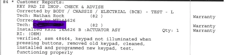

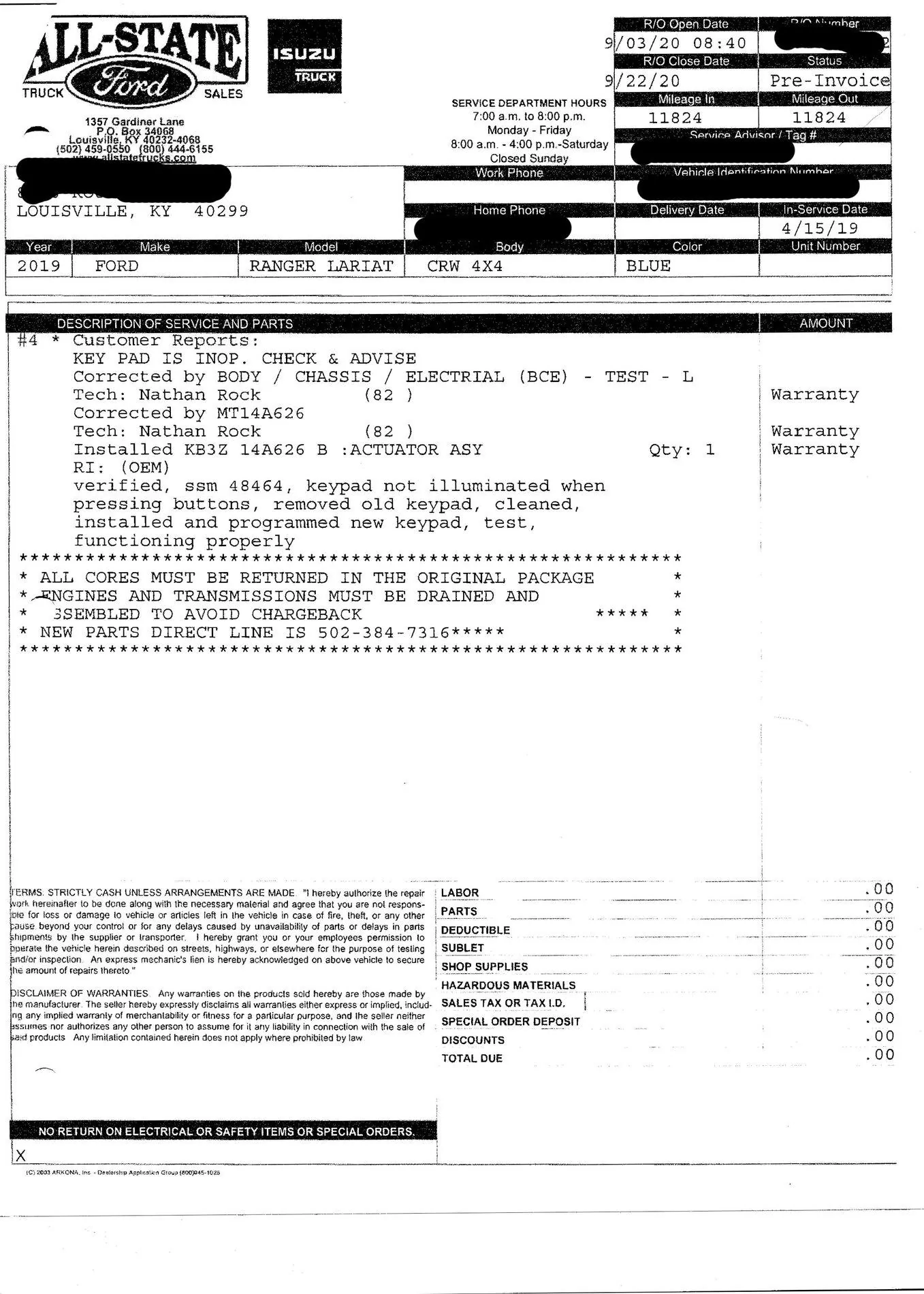

Mine lasted just a little over a year before it started eating batteries. Hopefully this one lasts longer. No big deal.
Took about an hour for them to replace.

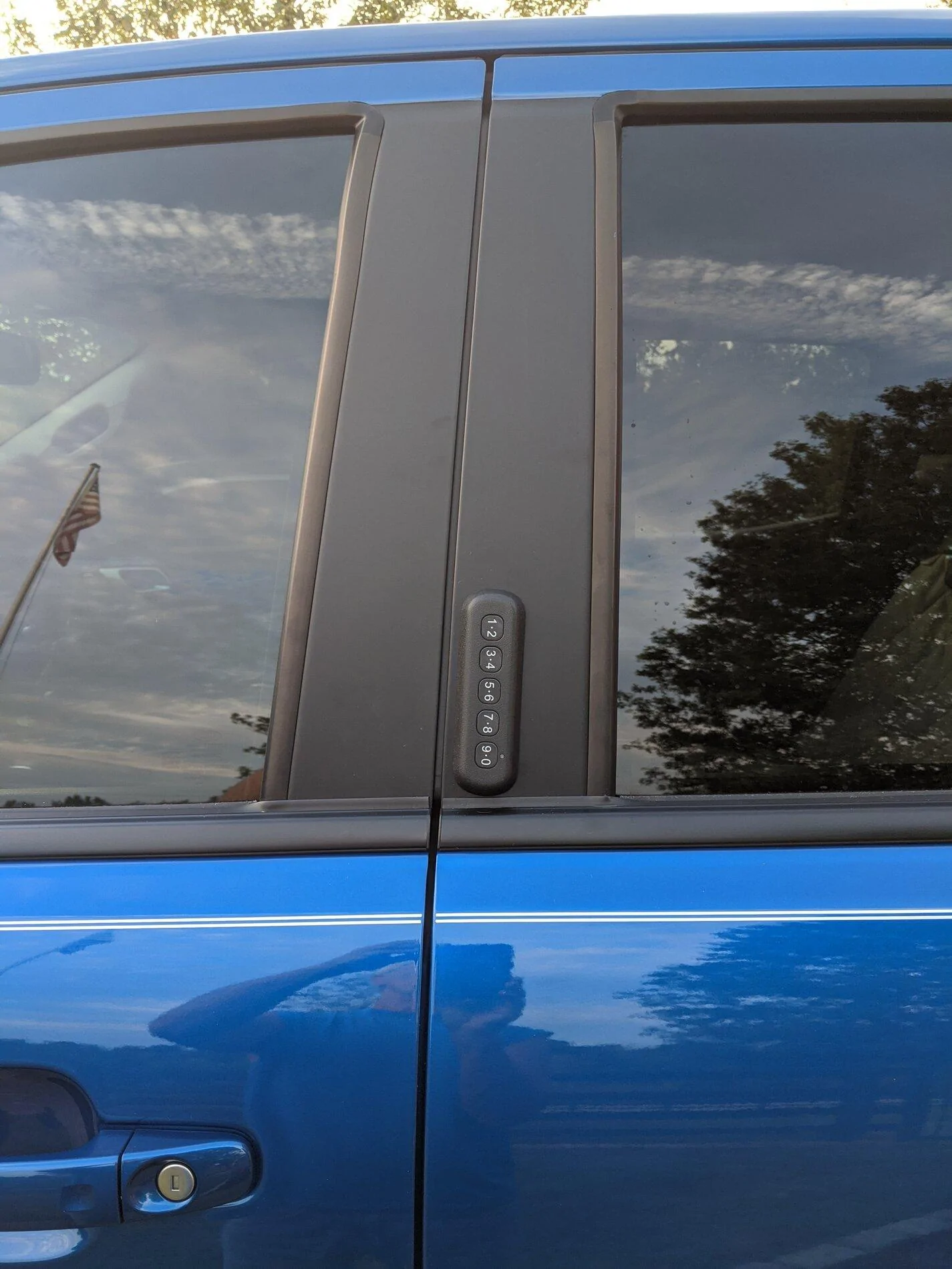

And they put back where I had moved it to. They didn't give me any grief about the relocation. :) ?

It doesn't matter, factory or dealer. If its on the window sticker, it is covered. Many of these were defective. I think there was some sort of service bulletin. This dealer replaced mine no questions asked. I had even moved it from its original location on the door to the B pillar. He replaced it to the new location.
Gregg, is the key pad staying tight to the vinyl on the door pillar ? I like it in that position. Bret
Yes it is staying put no problem. I put it on the back door so it wouldn't would take as much shock, but I don't think it would be a problem on the front door.
