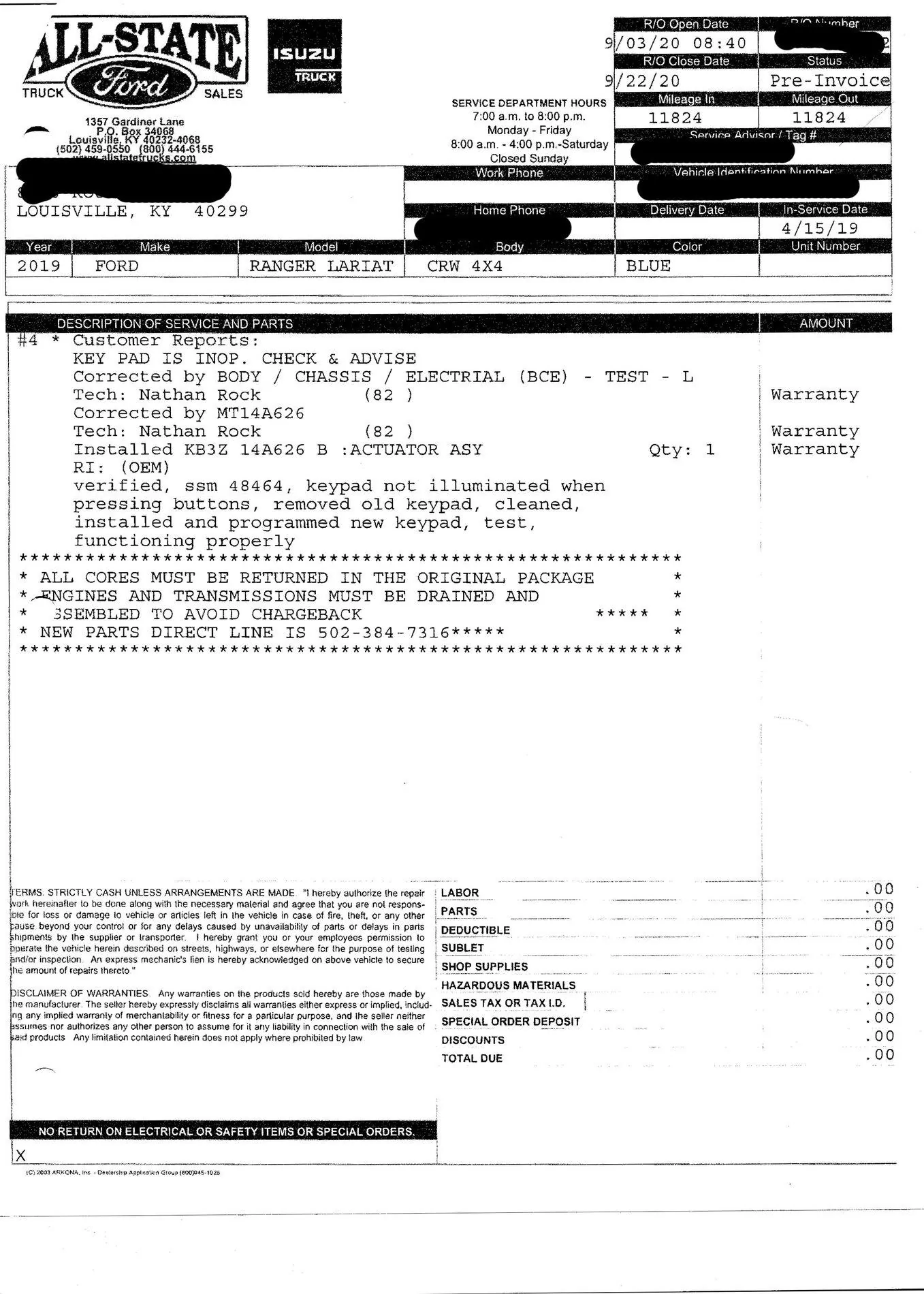

Does anyone have a link to the official keypad SSM?
My keypad was dead when I picked the truck up, so they put a new battery in which lasted less than month. Then I changed it and it failed in 3 weeks.
I'm having a hard time getting my dealer to change the keypad. They keep wanting to "diagnose" it, and then put in another battery. Both the dealer I bought the truck from and a 2nd dealer just give me the run-around.
They don't seem to be aware of the SSM. I'm in Canada, so maybe it's not a valid number here.
If I can find an "official" copy of the SSM it might help.
I don't have the SSM but I can show you that this dealer replaced mine .

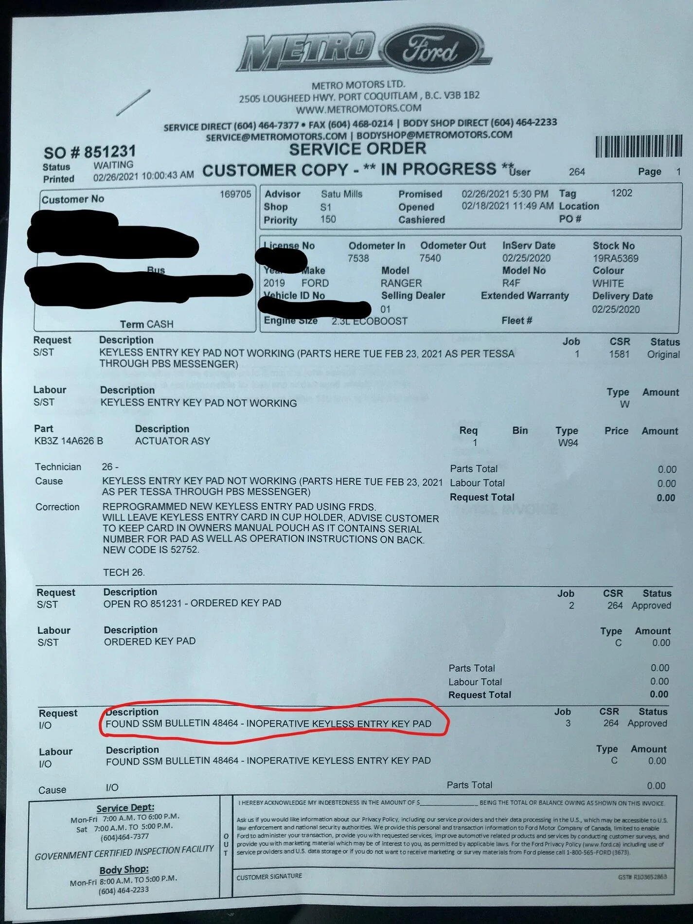

Thanks, but it looks as if that SSM isn't valid in Canada.
I'm on the phone with Ford Canada as I type this and the guy couldn't find that number.
I'm now on hold waiting for a supervisor.
Talk about frustrating. This is probably the cheapest item on the truck and I can't get if fixed.

Well Ford Canada service is all but useless. No help from the initial person and less help from his supervisor. They couldn't even tell me if there was a service bulletin on the keypad? They don't have access to that?!?
So after hanging up on the supervisor, (he just kept repeating the same thing over, and over :explode:) I contacted my salesman and asked him to push the manager to get the keypad replaced.
A couple hours later I got a call from the service department and they said the SSM I gave them was invalid, but they managed to find another bulletin about the keypad.
So they booked me in for Tuesday, so they can "diagnose" the problem.
"Ok, do you have a keypad in stock, so you can replace mine after your diagnosis"? "Uuumm, I'll call you back". Next day I get a call, "So, I've ordered the kepad. Can we book you in for Thursday"?
A major run around, but finally getting it fixed.
Couldn't have done it without the info from this forum! :rockon:

So for those of us in Canada, SSM 48026 is not valid and can not be found by the dealer, but SSM 48464 is available.
This is the same SSM # that gfitzge2 used (and posted).
I probably would have blacked out the code :)

This thread has two SSM numbers, 48026 and 48464. The 48026 was not found when I was at the dealer. I came back to this thread and found the other SSM number. Can someone tell me what code is the one they should be able to look up concerning my 2019 Ranger keyless keypad.
Thanks

This is the receipt from mine being replaced. The ssm is 48464. As you can see it is from 2020. I don't know if it is still valid.
