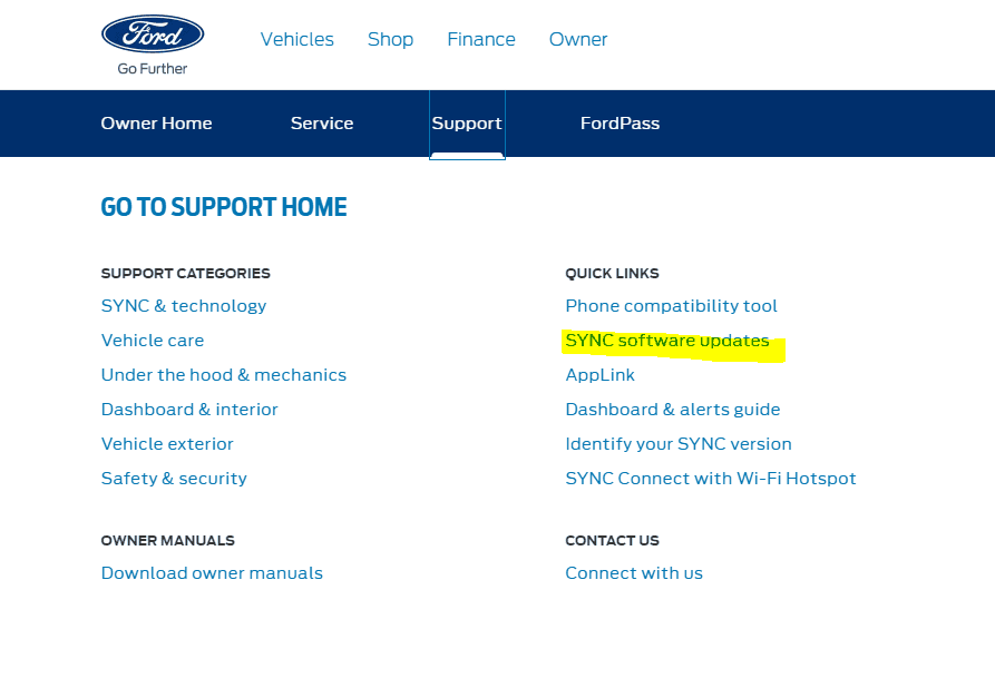

yep got this fun one too. The portal does finally show me that an update is available so i'll roll the usb version.
