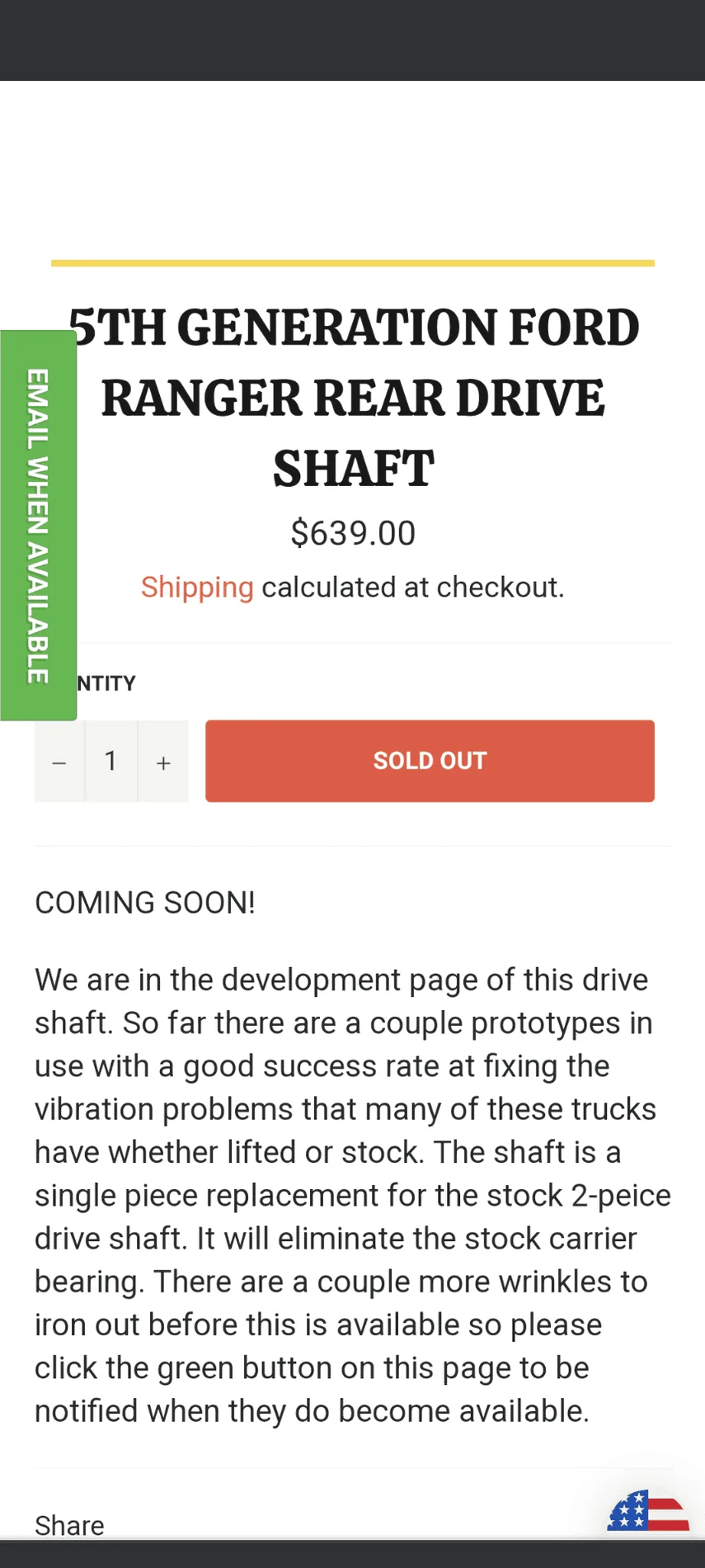

FYI I have been working closely with Tom Woods on this, they would have had one out sooner but had issues with the flanges, they were going to have to make an adapter. Well I was able to track them down for them so they ordered 50 of them. They will now have these out any day now. The only reason I am going locally is because I like knowing I could always go back if I ever need anything addressed. My local shop provides lifetime warranty on their work and have been doing this for 25 years. If interested call Tom Woods and put yourself down for the one piece. Its coming out soon. Their work is top notch.
Can you update us on your one piece drive shaft?
Sure. Not issues so far. Truck drives smooth 90 percent of the time. On occasion I'll get some minor vibration in the rear, but I am pretty sure it's the tires. The NVH app also confirms this. Overall it's greatly improved the ride of the truck. Took the truck on a 4 hour off road trip recently and no issues. Will be doing some off roading today also.
