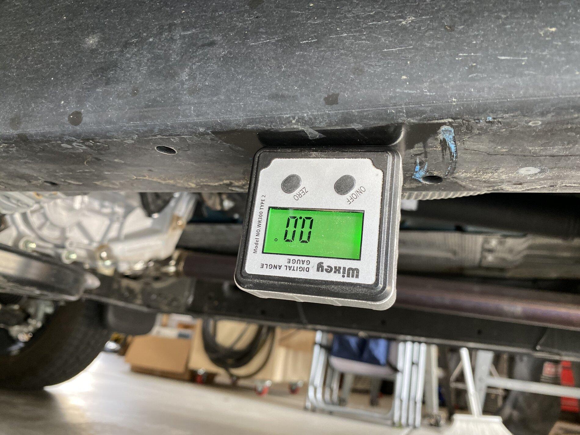

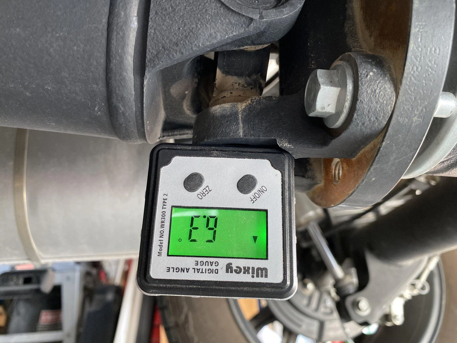

I just went out and followed the first part of the TSB to do the measurements to see how much mine is off. I've noticed a slight flutter on light acceleration from a stop up to 12-15 mph since the truck was brand new. I did install a Rough Country 2.5" leveling kit at around 2000 miles, but didn't notice it make the flutter any better or worse.
Here are some pictures of my exact measurements. First, zero my inclinometer on a flat edge of the frame:
Then measure the flange yoke on the rear diff with it rotated to be parallel to the ground:
Subtract the rear diff measurement from 5.25, and I get -1.05Âş. So it's basically 1 degree off.
Has anyone taken a leveled truck to the dealer to have them apply this fix? Did they balk at the front end ride height?
