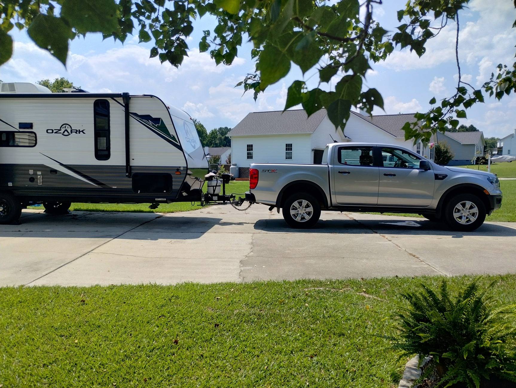

here's my current setup that works pret
ty well.
Really can't judge a setup by a picture. Looks OK trailer is level.
Without knowing axle and tongue weights before hooking up, axle weights after hooking up without bars and with bars. Even then it's still a judgement call. As Grumpaw said every setup is different and constantly changing. What is the load in the bed of the truck, how is the camper loaded, is there water in the tanks, how much. Best you can do is make sure your bars are correct for the tongue weight and your setup does not transfer too much or too little weight to the front axle of the truck. The last thing you want to do is remove any weight from either axle.
