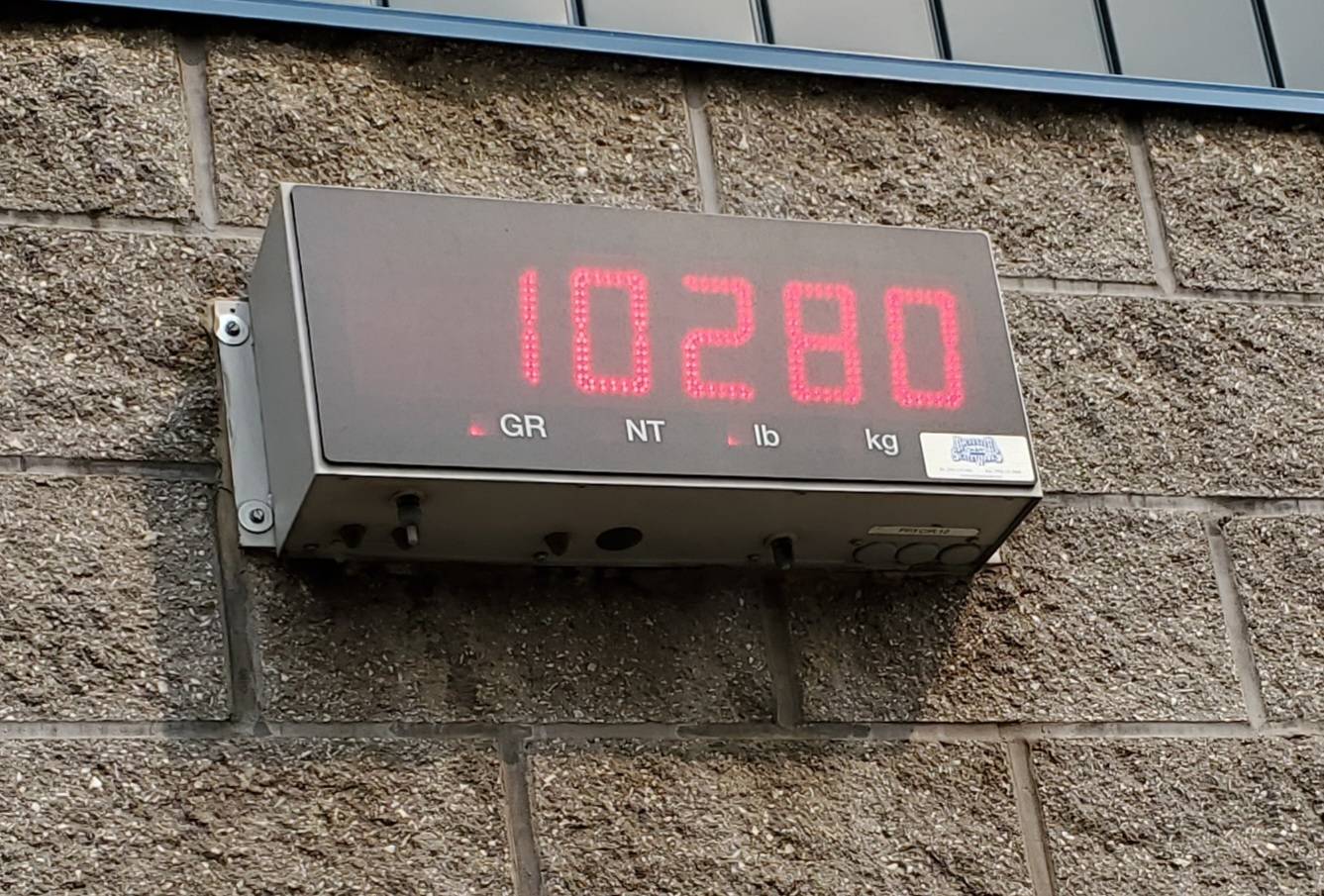

Sounds like it is time to pay a truck stop with a CAT scale a visit. The CAT scale has 3 separate plates so it is very easy to get different weights like trailer tongue and axle, etc. If no truckers are waiting in line, you can unhitch on the scale where you have the truck on one plate, the trailer tongue on plate 2 and the trailer axle on plate 3. I would guess the weigh to cost @ $10 to $12.

Update.... I reweighed the tongue using the digital bathroom scale/pipe and a 4x4 method. The real number seems to be 655. I rechecked it 3 times to verify. 655 makes a whole lot more sense.
