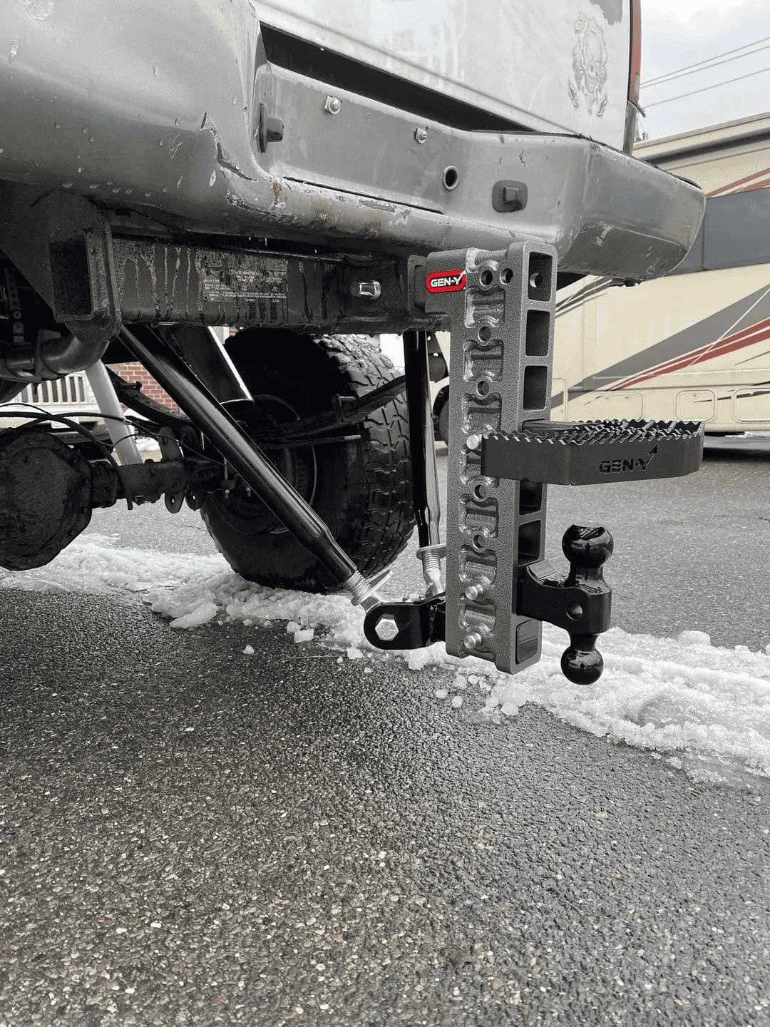

For your question about the lower height and it's use - I think you'll b better off. The bed rake really jacks up the rear and most everyone has to get a drop hitch in order to make for a level tow.
I have a short adjustable drop hitch of 5 inches but could have used a 7 inch once. I suppose the more inline your trailer coupler is to your truck's hitch means less stress on the ball mount.
