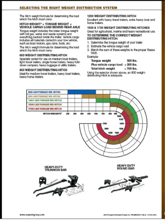

So if om understanding correctly it sounds like you have 2 problems. First is the hitch height(totally understandable and easy to fix) and second the capacity of the weight distribution hitch. Understanding that it came with the trailer does not meant that it is correct. A weight distribution hitch should always be as close as possible to the trailer empty and gross weight.
The good news is these are both fairly easy to fix. I would first recommend getting the correct weight distribution hitch. Second I would buy a new shank for the weight distribution hitch that goes a little lower as needed for the Ranger.
Attached is a general chart guideline for selecting the right weigut distribution hitch.
Hope this helps
