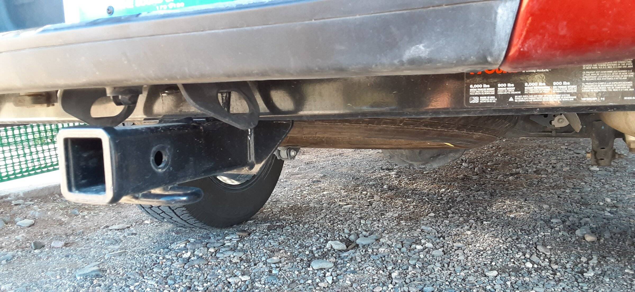

My 2019 didn't come with a receiver, just the plug-ins for the trailer wire bundle.
I ordered the Curt #13417 off Amazon, it was $132.
It is a Class 3 rated at 900 lbs. tongue weight, 6,000 gross trailer weight and 8,000 lbs. w/ weight distribution.
Easy enough to install. The hitch is held on by the same bolts that hold the bumper.
Just support/clamp the bumper so you don't have to realign it, and bolt on the hitch.
It might be lower than a factory set up, but it can't be all that much lower.

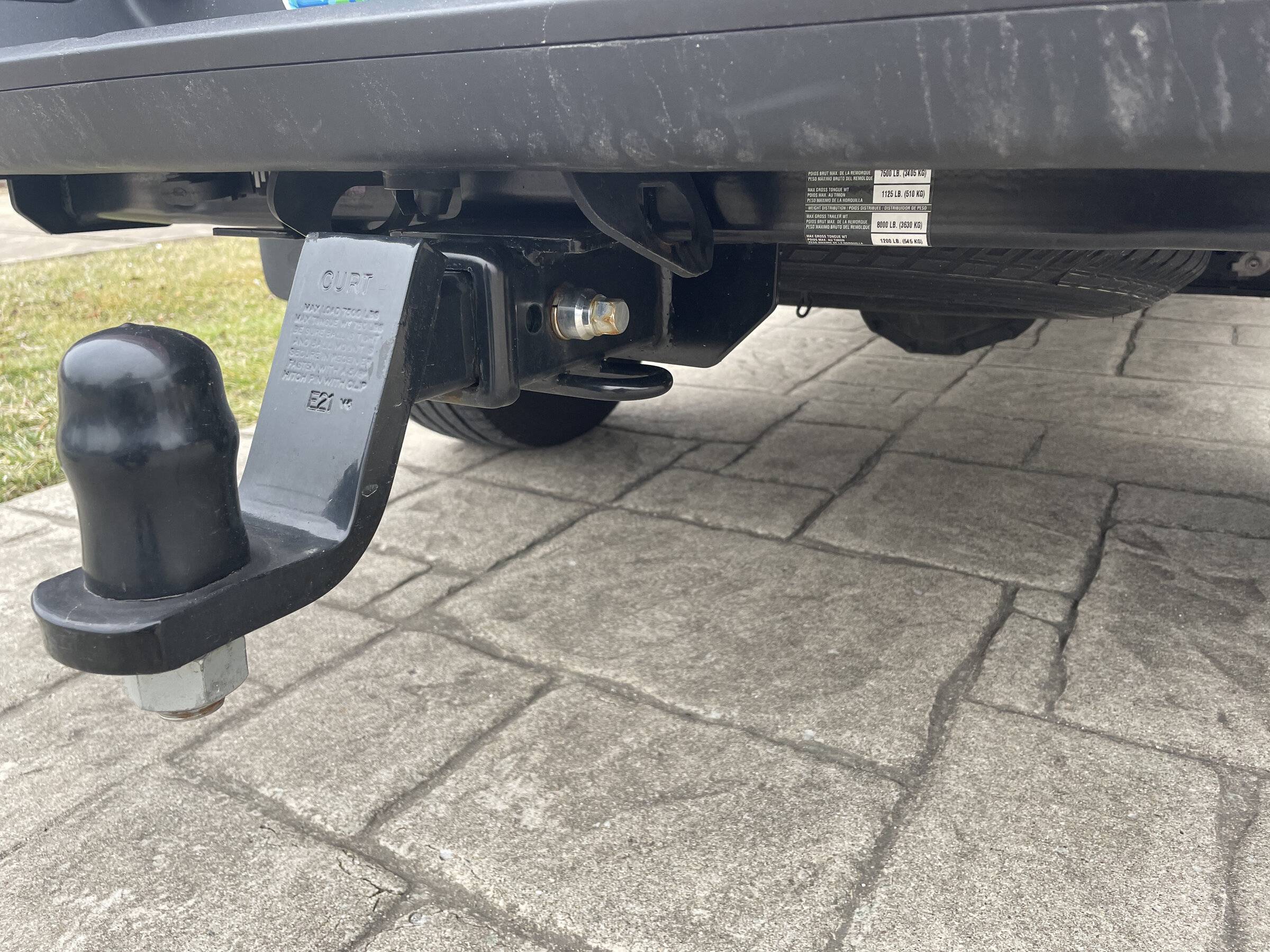

I bought the curt hitch for mine, but the drawtite would have worked too. Curt was supposed to be made in USA, so I went that route. Ground clearance shouldn't be a problem unless you are doing extreme off roading.

My 2021 XL came with wiring but no receiver too. Put a Curt Class 3 on there, have not towed with it yet but it seems like a well made product. I believe it is C13417 and can be bought for around $140.

I also added the Curt to mine. The install was super easy. There are 2 tabs on each side of the bumper that if you put some c-clamps on and it holds the bumper in place while removing the mounting bolts. Then lift the hitch in place, throw the bolts in, torque them and your done.

Hi guys. Does anyone have 265/65R17 spare tire? Will it fit with Curt 13417 with no problems to its place back?
