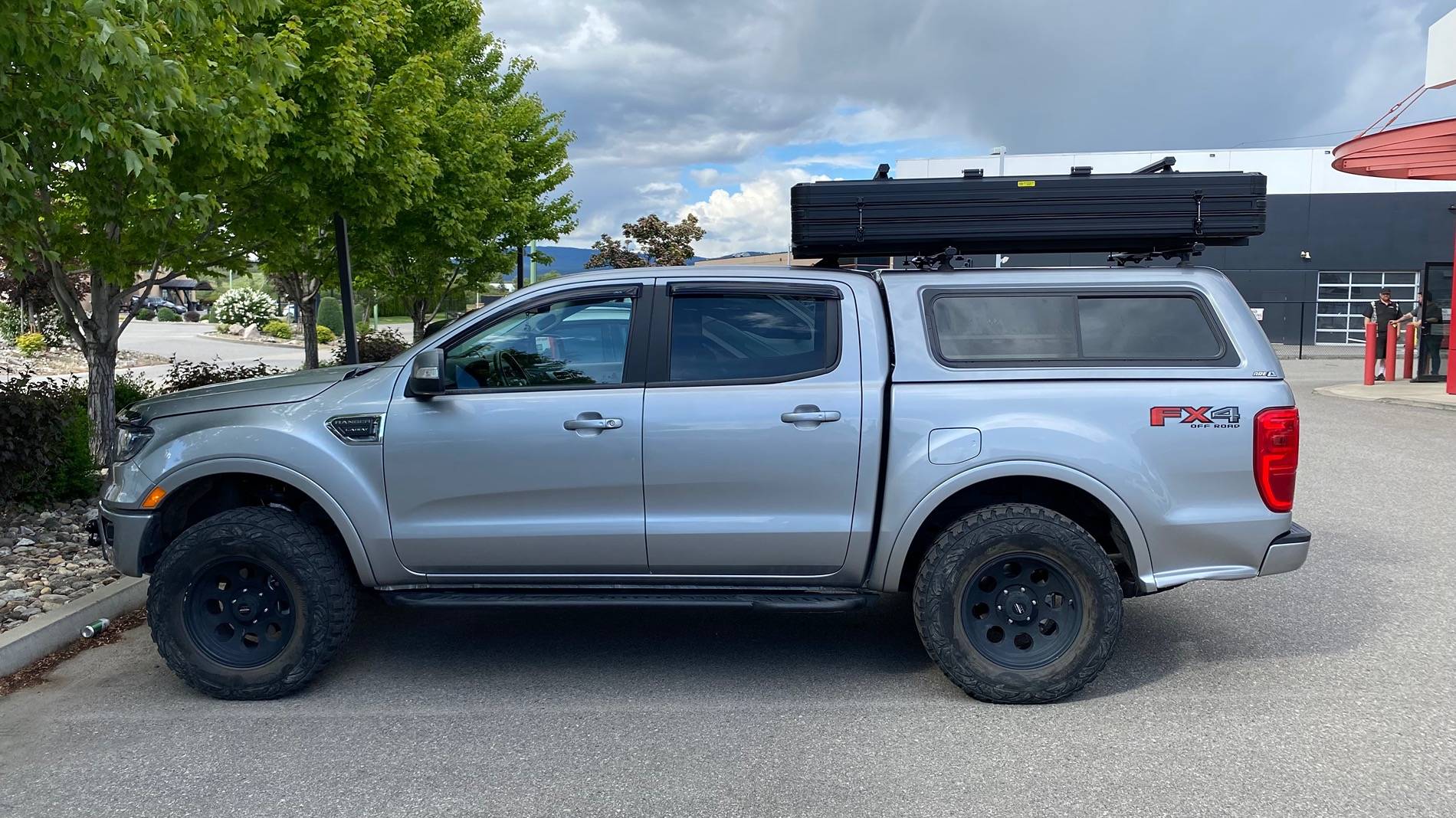

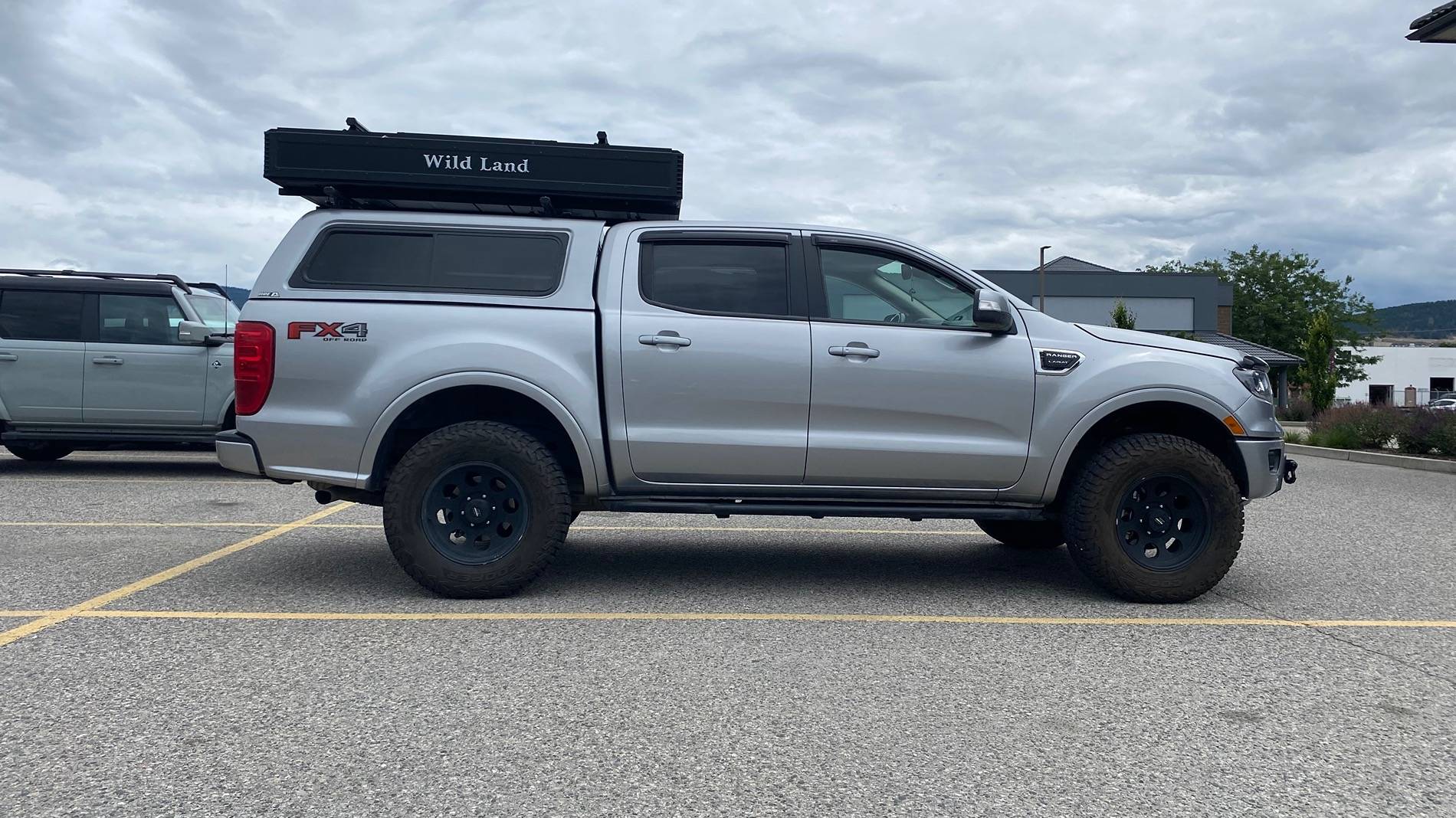

Better pict of the stance after adding the lift shackle
BEFORE:
AFTER:
I'm in a very similar situation as you. I'm on Fox 2.0 and with a canopy, and looking to get a little lift in the rear. How is the ride with the Shackle on Stock leafs? Any issues with shutter or needing to adjust the pinion angle after install? Ideally, I'd like to jump to the OME 1.7 Leaf, but then would need to adjust the sock to accommodate the height. I figure a cheap shackle can get me through the life of the leafs before wanting to do the full upgrade.

Yes I was agonizing on how to approach it as well, new leafs, air bags etc. it came down to budget for me, and I am very happy so far. No issues yet, they are doing exactly what I needed them to do, lift the rear up about an inch. I figure that before I leveled it, that’s how the suspension is supposed to act under load, droop an inch or so. My issue is because I leveled it so it makes sense to just raise the back up a bit to correct it as long as the leafs are still doing their job and not flattened right out which they weren’t and I like the ride. I say go for it, not much of a gamble.
