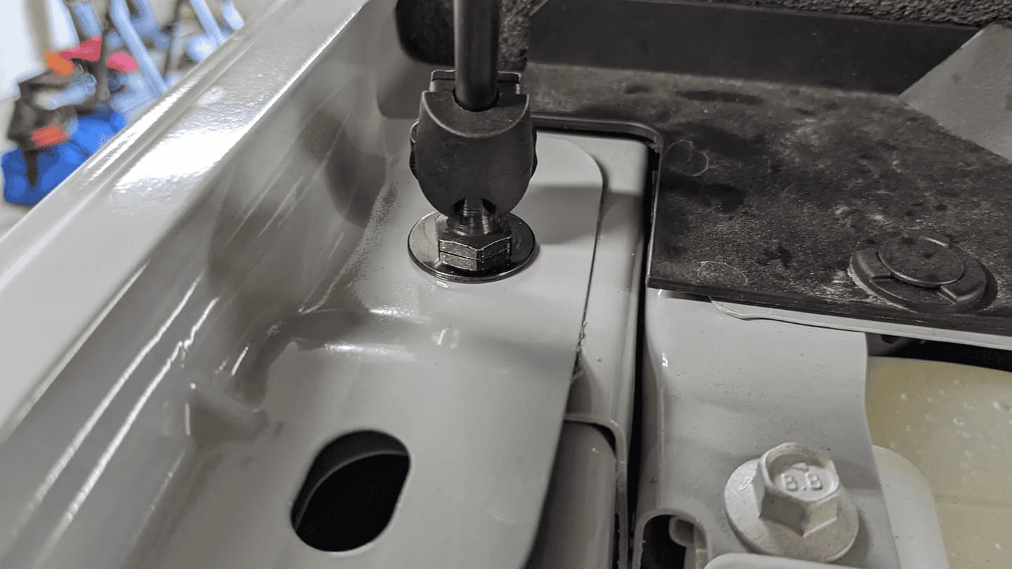

I forgot I added Redline hood struts, however, I was not impressed with their undersized lower washer, so I replaced it with a proper washer.

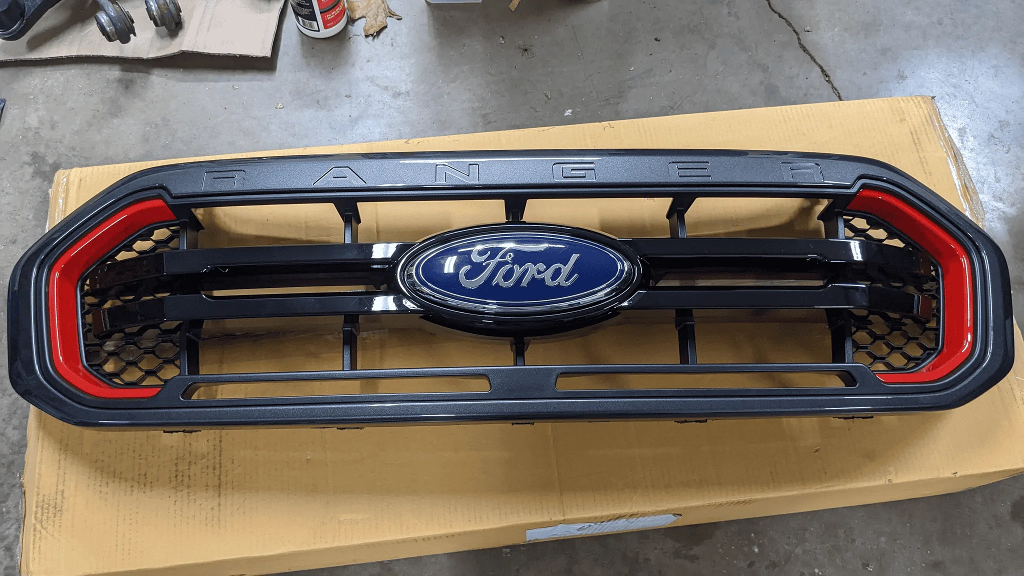

Next up, I have a Tremor grille that I'll be installing. I will make some changes as my trim is not the gray used here, but black. Luckily, I can unbolt my original and replace it on the Tremor grille. I also picked up some Cactus gray in a spray can and plan to paint the gloss black to match the truck.

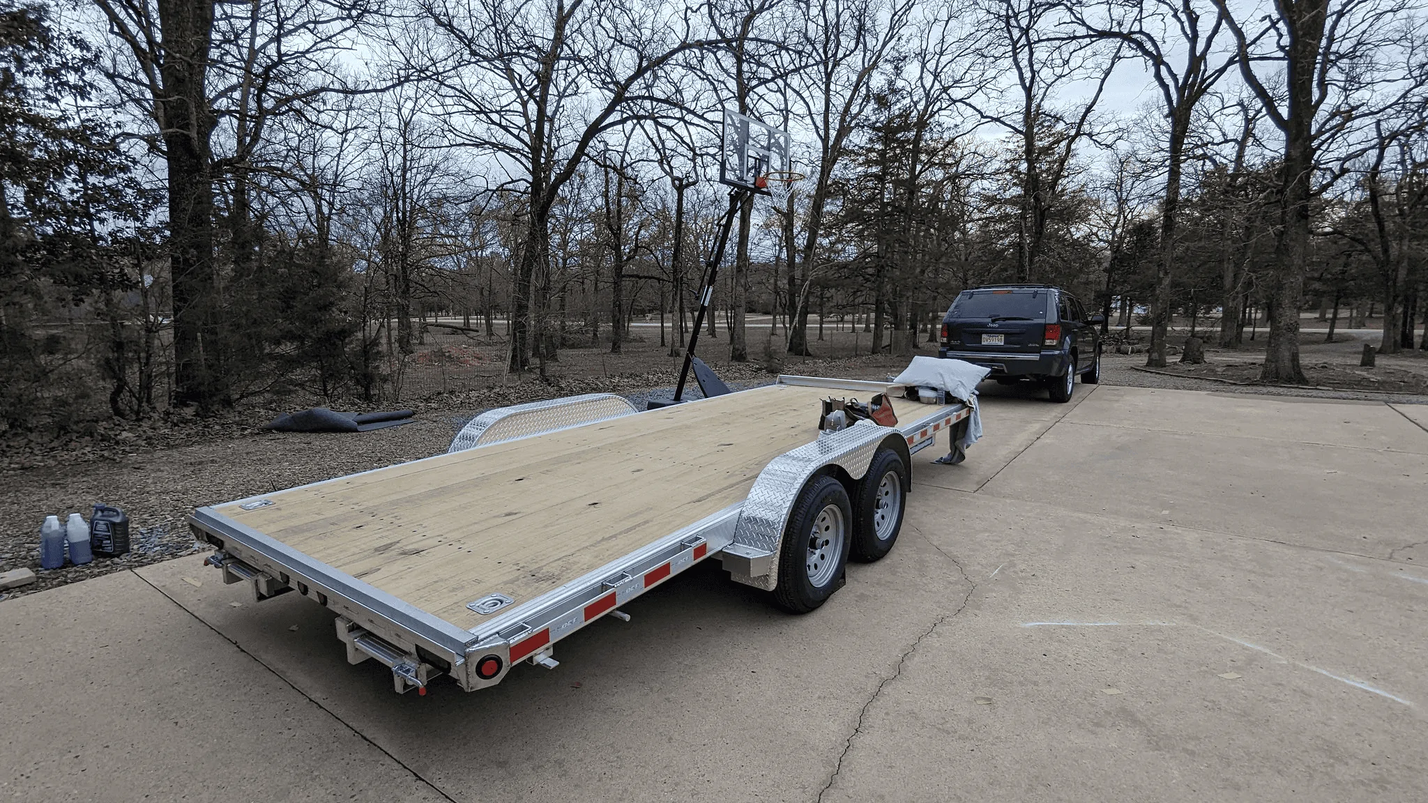

After buying the truck, I wanted to save some weight in my trailer. I ended up ordering a DCT Aluminum trailer a few months back and picked it up recently. It saves 700 lbs over my other trailer in the same size (Hull 18' dovetail). I had them put a winch plate, D-rings, 6 ft ramps, and rear support legs, for when I load a car.

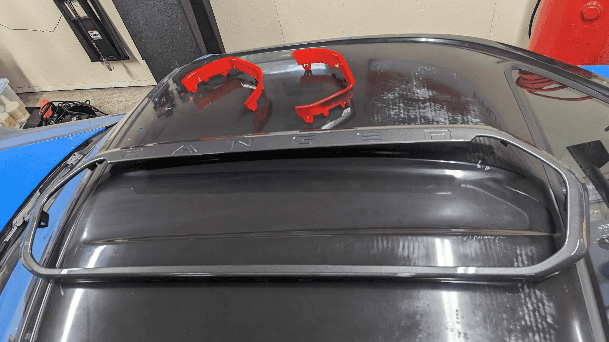

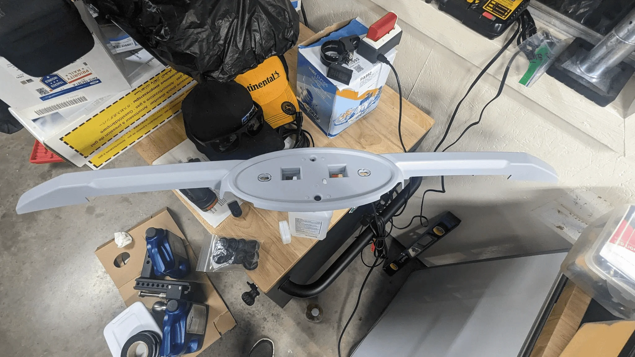

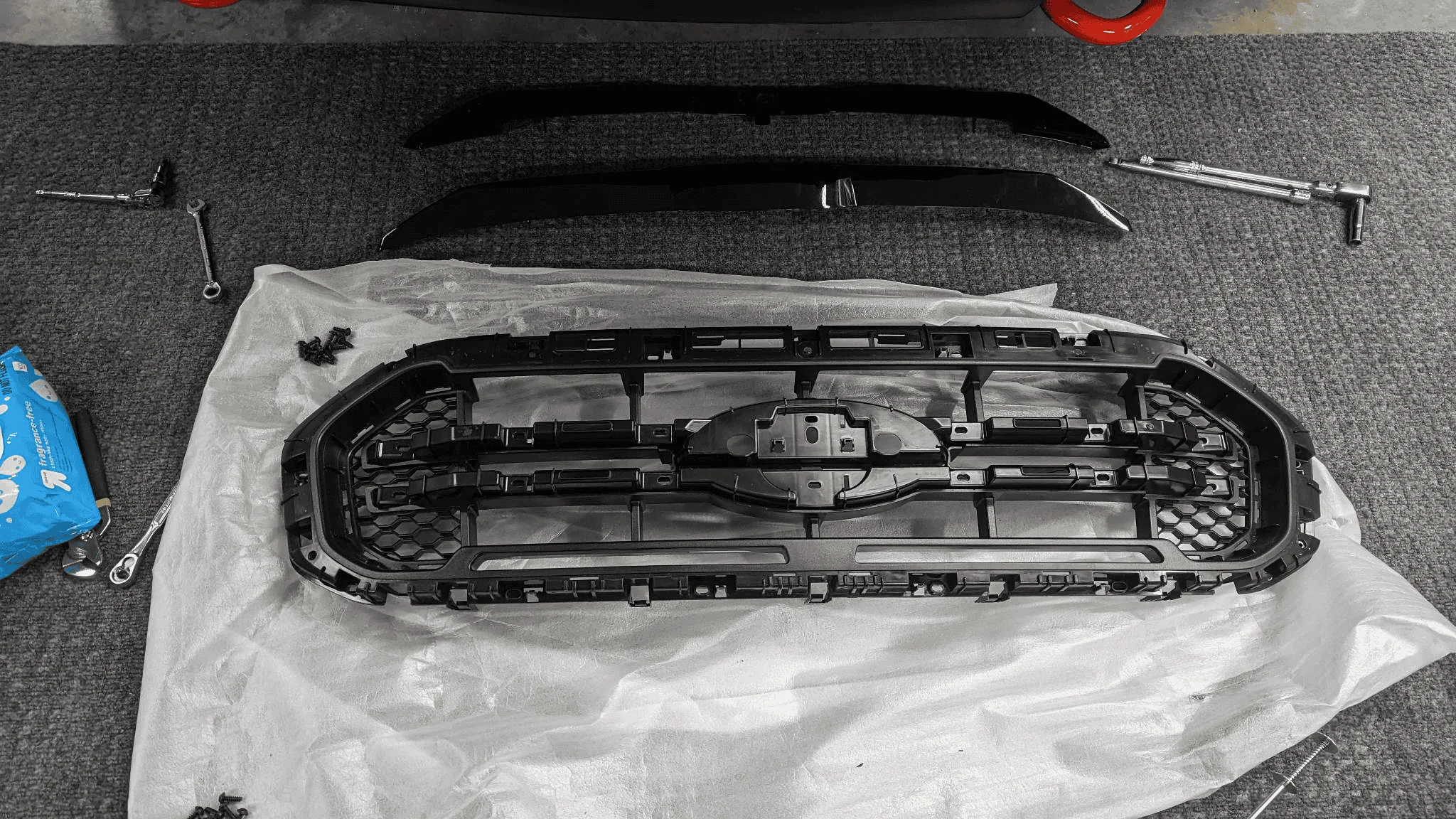

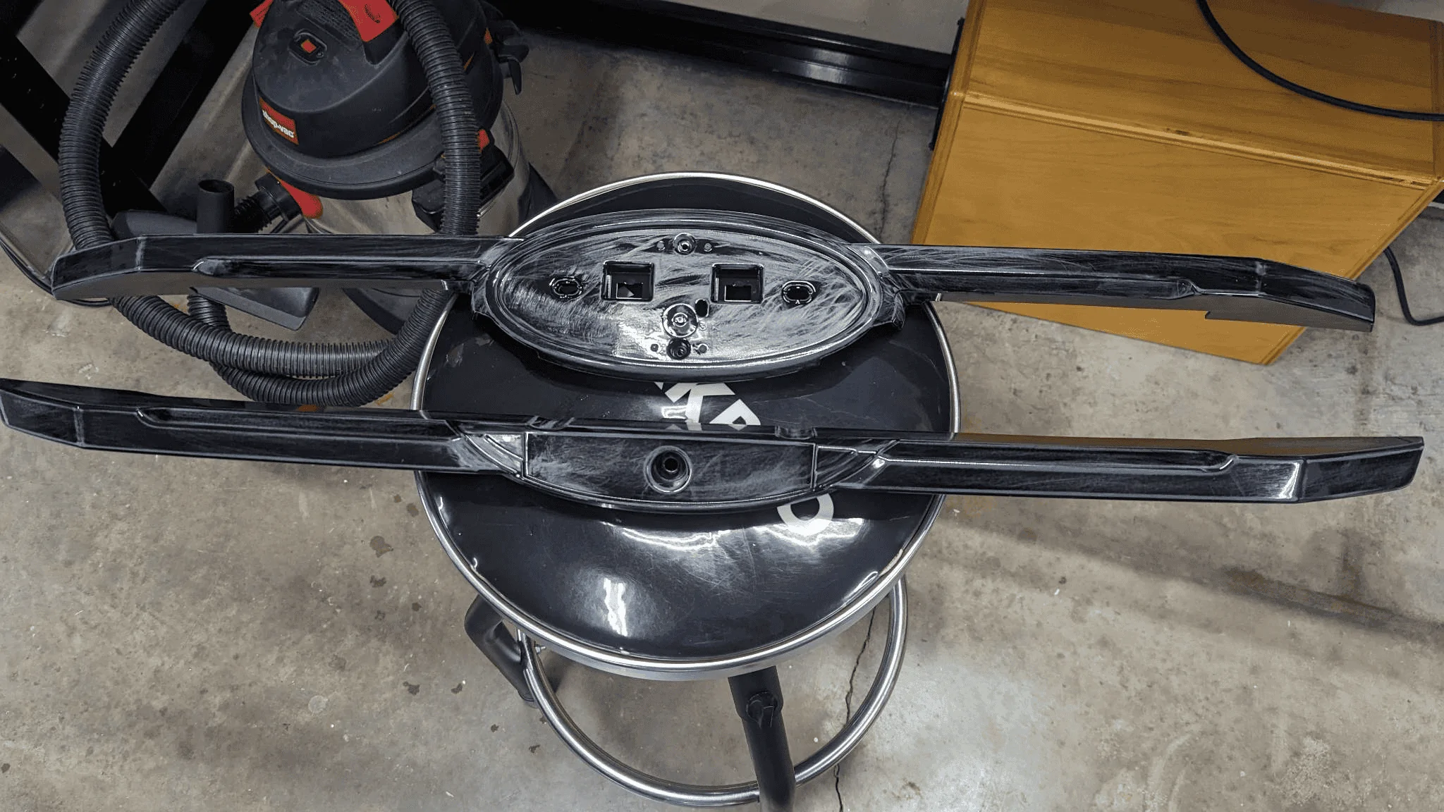

Getting a few things done... I took apart the Tremor grille that I bought of a guy last year, which was basically new. I'll be painting the horizontal pieced body colored. I am also likely to take apart the Ford badge and paint body color and black. The pieced currently have primer on them. I'll sand tomorrow and put some paint on them.
Yes, my shop is a mess right now.

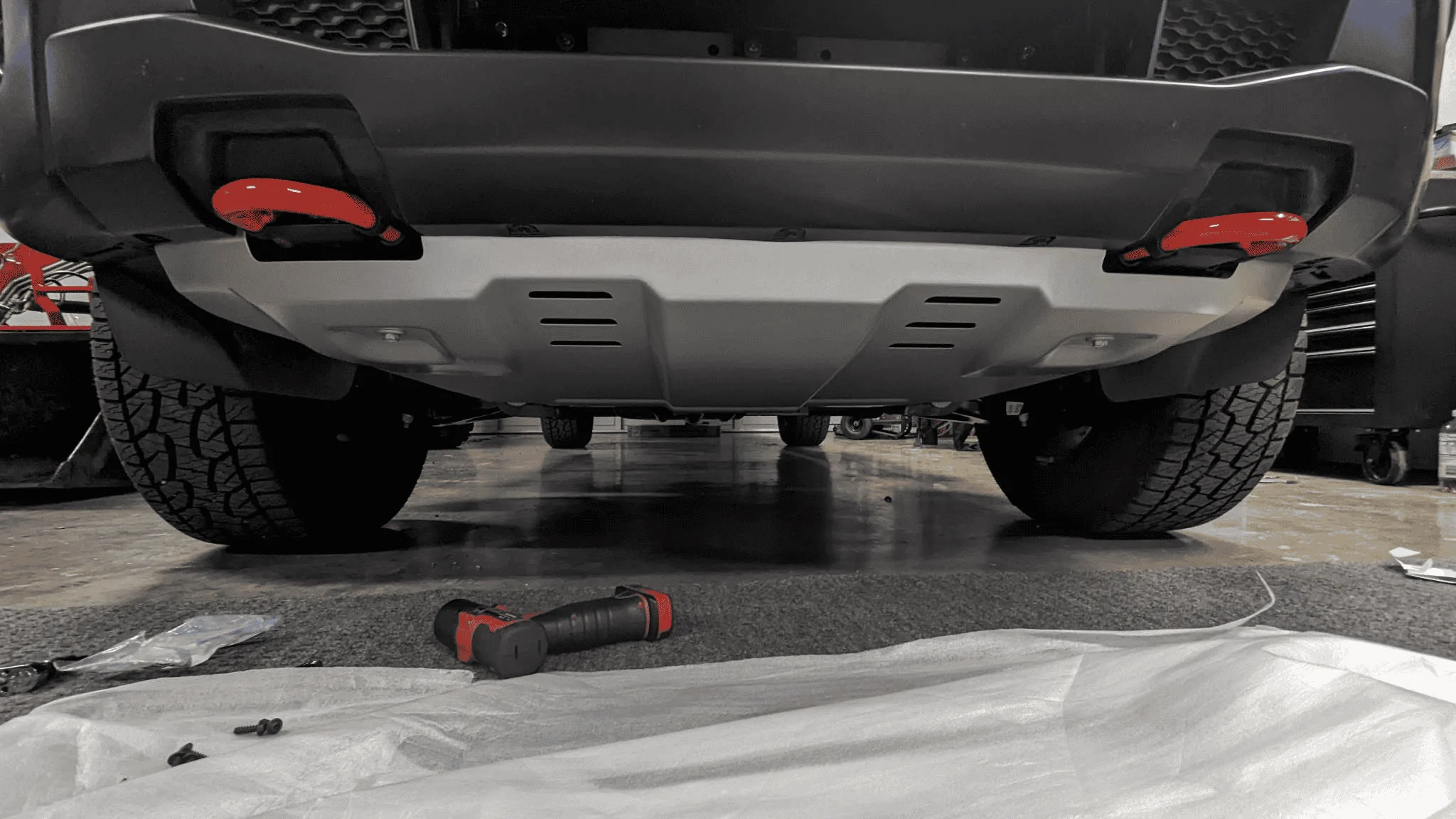

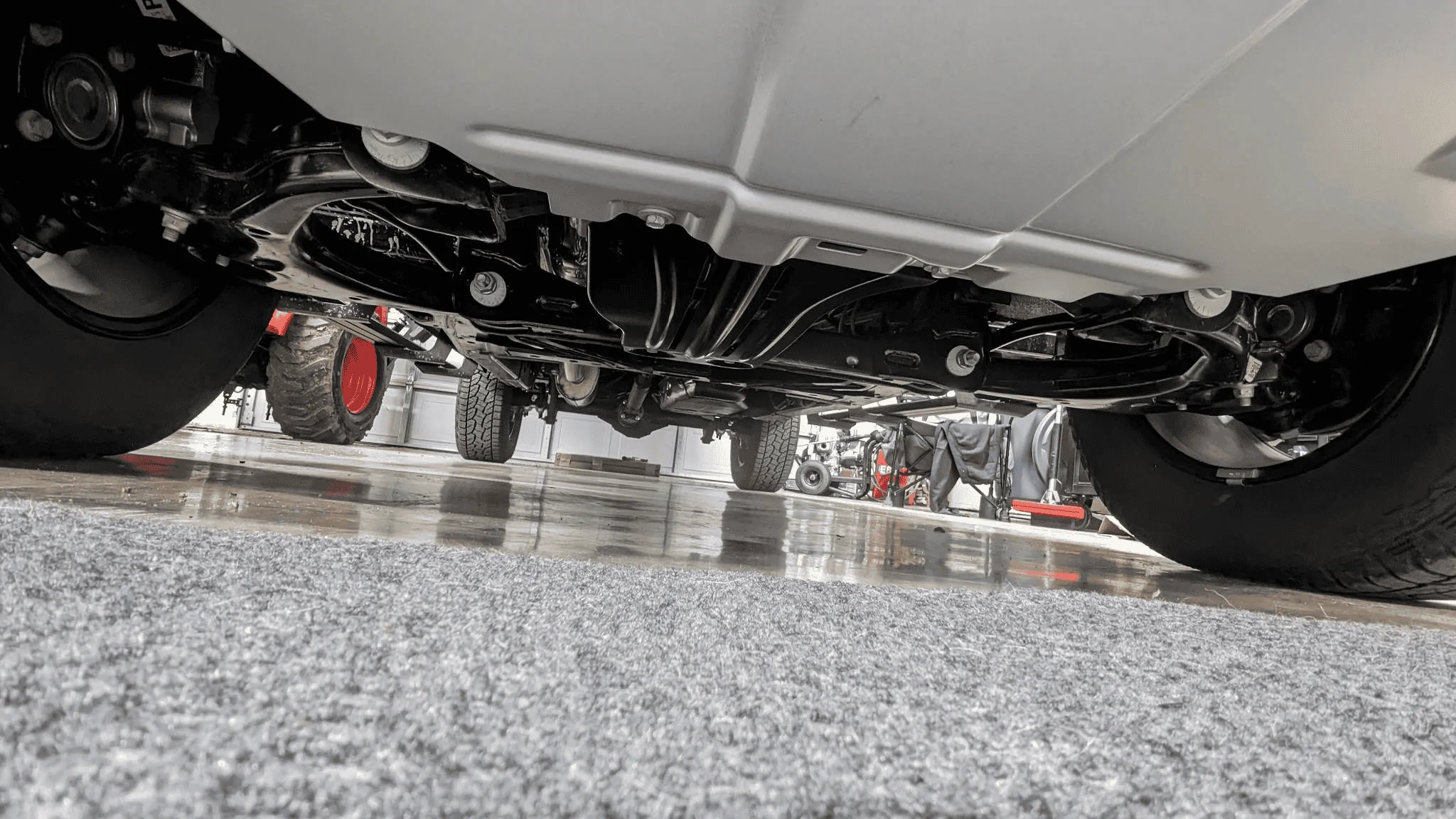

Also swapped out the plastic piece under the front bumper for an FX4 bash plate, tow hooks, and power steering plate.

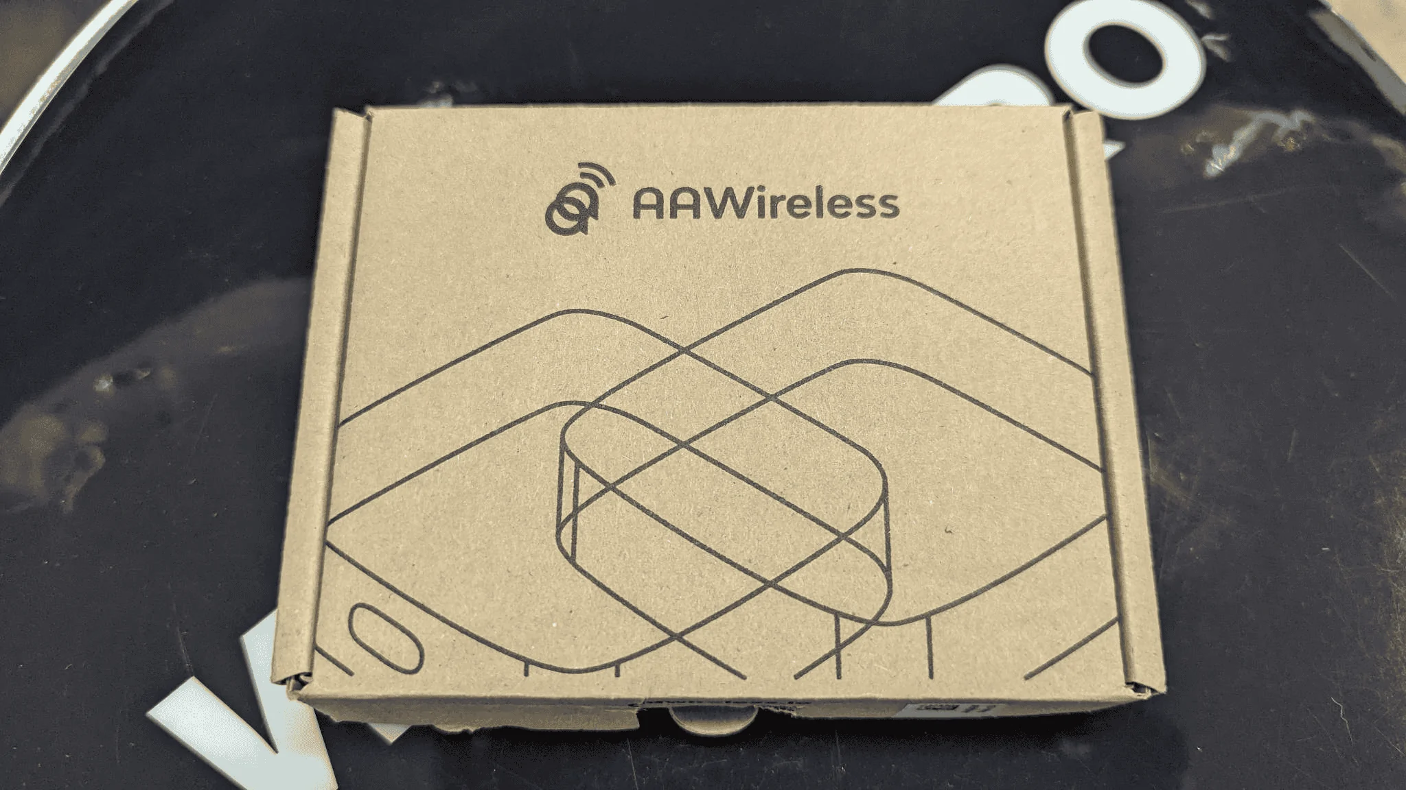

And I took a chance on wireless Android Auto based on the thread here and I am pleasantly surprised. It seems to work as if I had the phone physically connected, which is nice for the shorter trips.

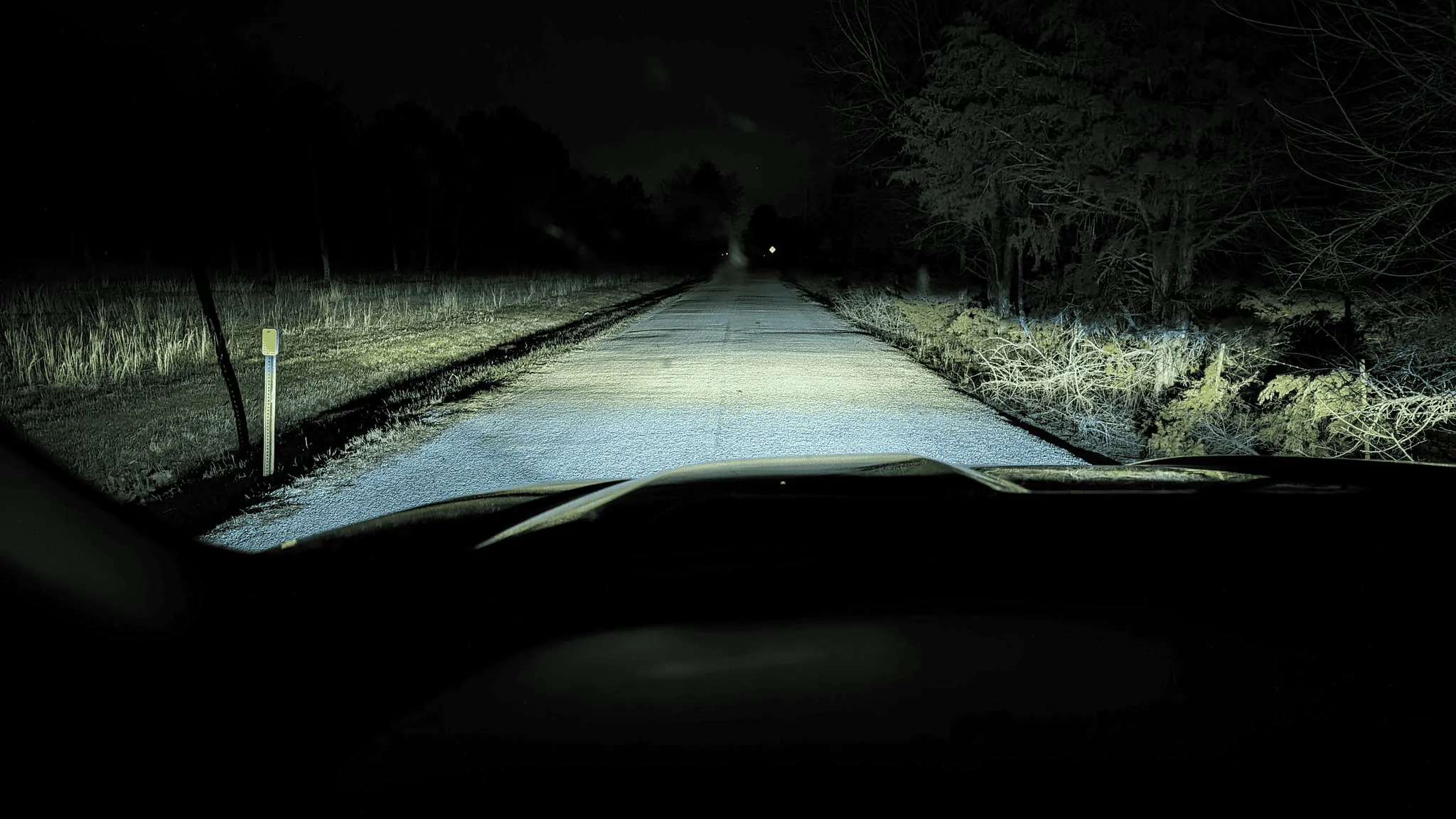

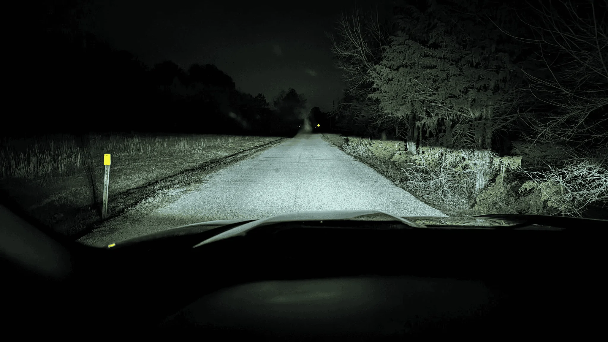

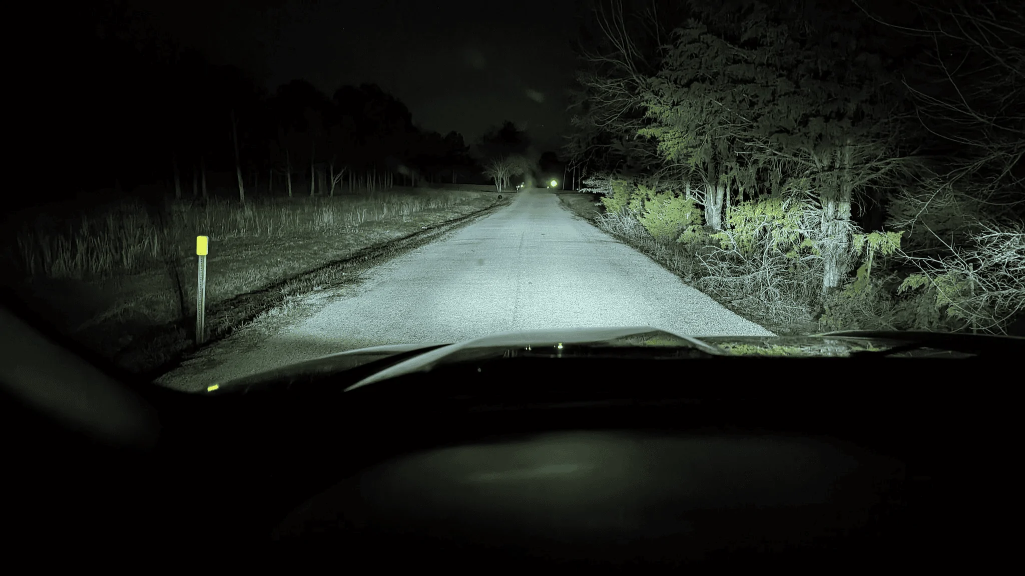

Tested out the lights recently. Big upgrade from the OEM halogen lights. The fog lights are a perfect match for these as even though these are bright, the color is a little whiter than I like and the fogs help with that.
Morimoto low beams:
Morimoto low + high beams:
Morimoto low + Diode Dynamics fog lights:
Diode Dynamics fog lights only:

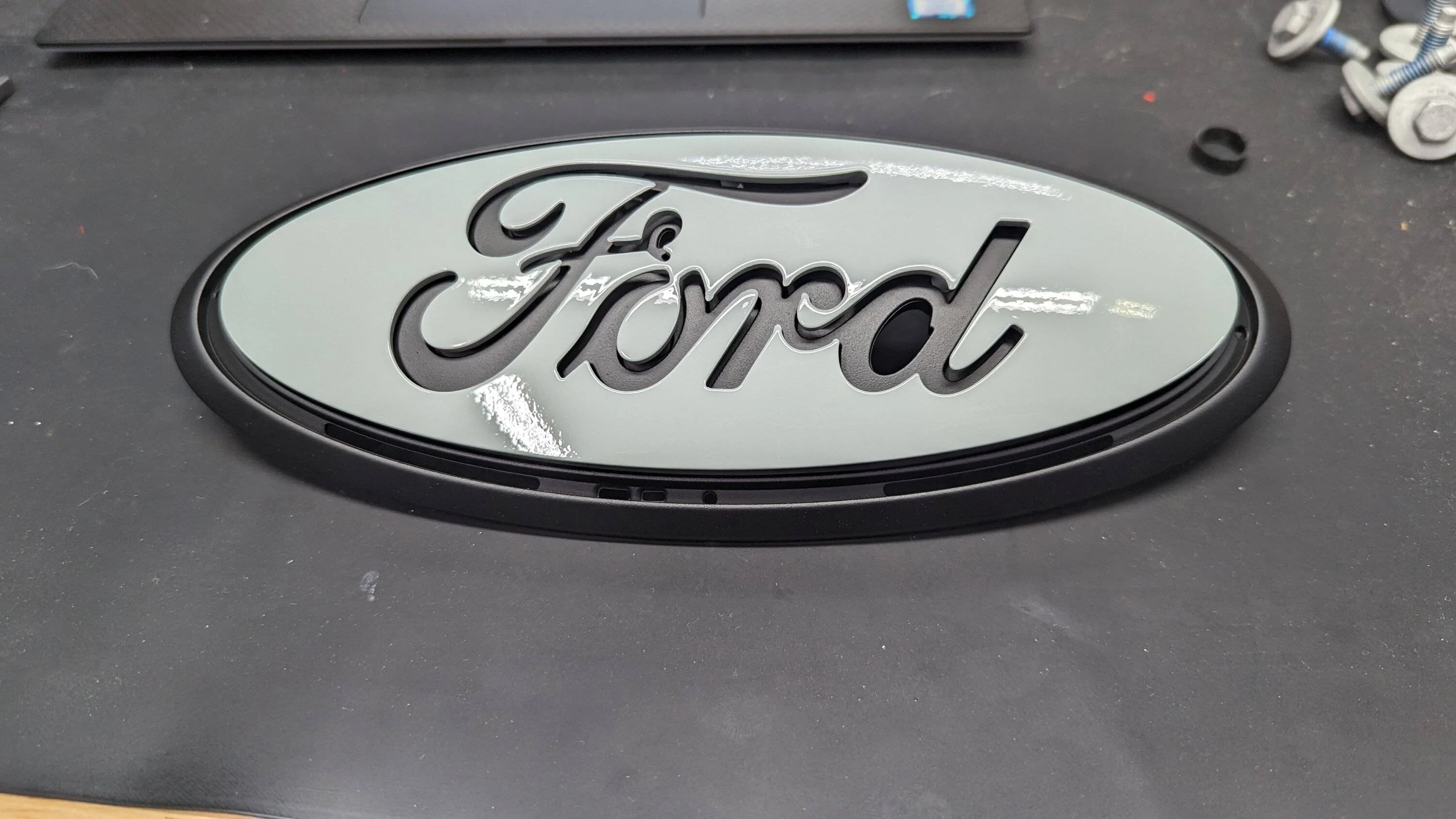

Working on the Tremor grille now. Did some primer, sanding, repeat on the horizontal trim pieces. Also decided to do the Ford emblem as well. I'm pretty happy with how it's coming along.

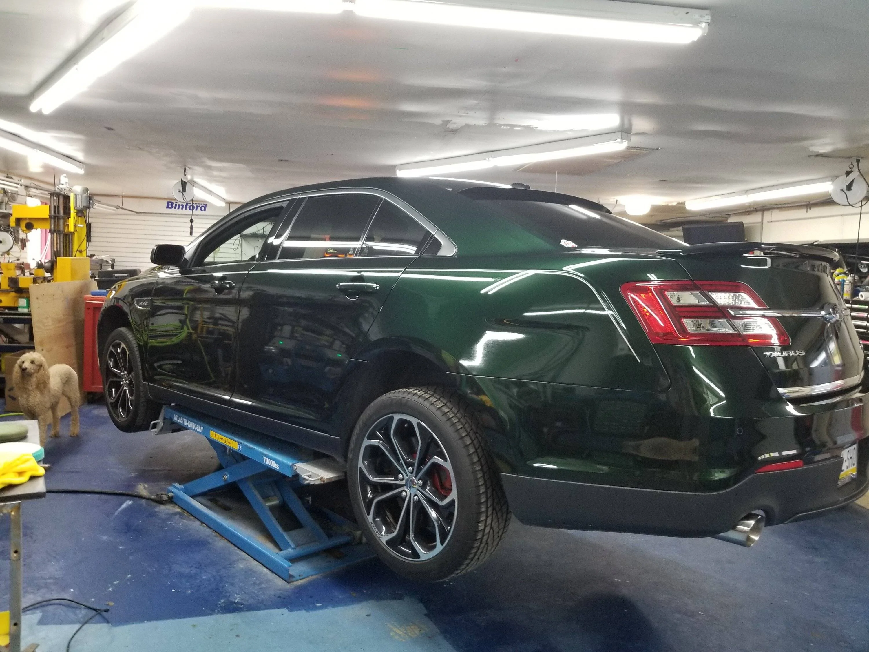

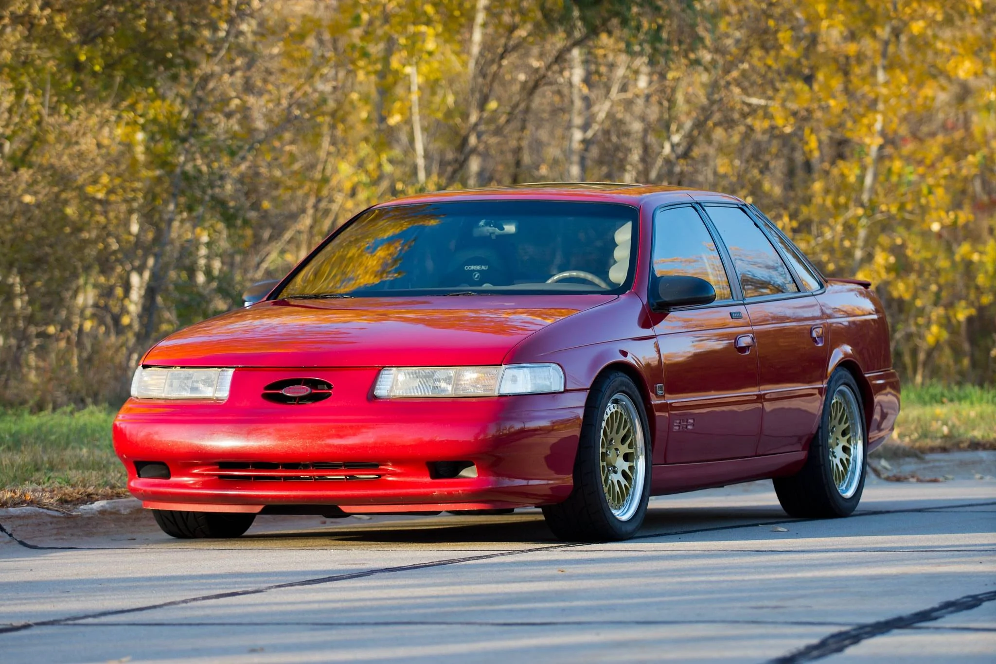

Does this make me a SHO guy too???:LOL:
mmmmm... not really ........ really need one of these
or at least this lol
