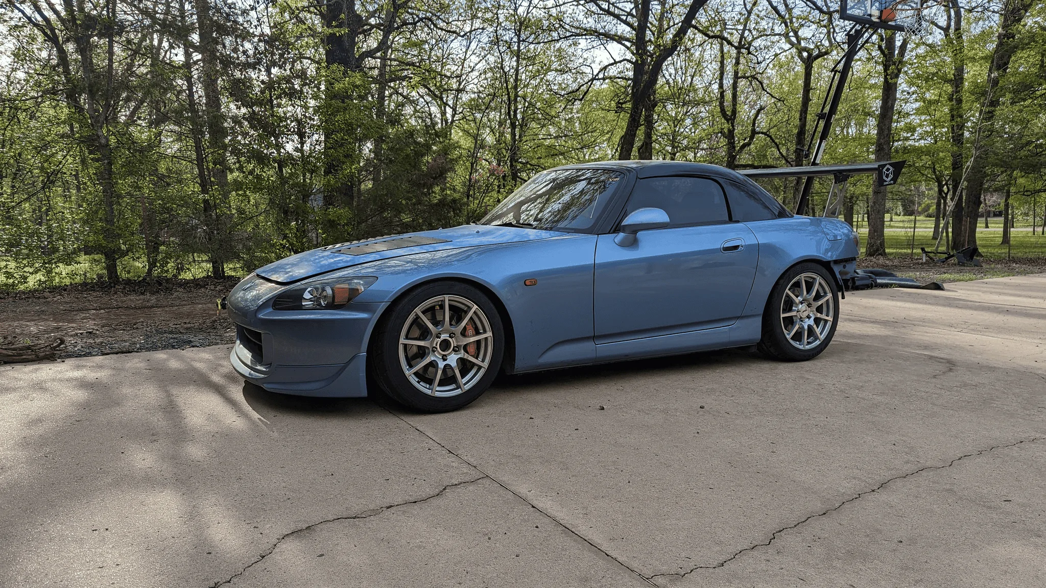

That's a nice S2K man! Looks like you put some work into it, what have you got done to it?
Thanks. Funny enough, I'm troubleshooting a random misfire on it right now. Not sure if it was bad fuel, injectors finally needing cleaning after sitting multiple times at very long intervals with E85, coils, etc. I have removed the injector PnP harnesses and crimped in the proper connector yesterday and new plugs today, though the plugs I pulled out looked fantastic.

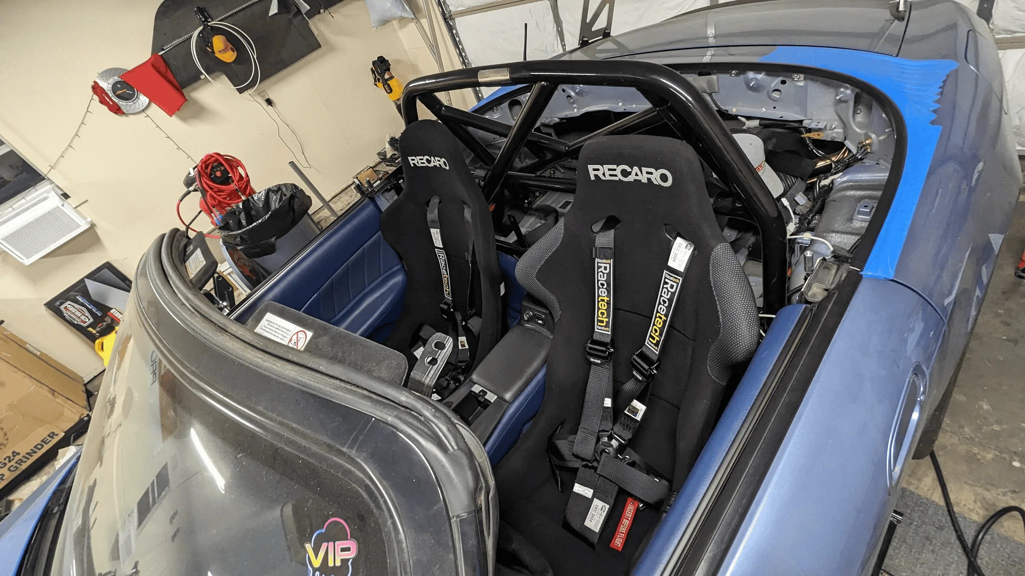

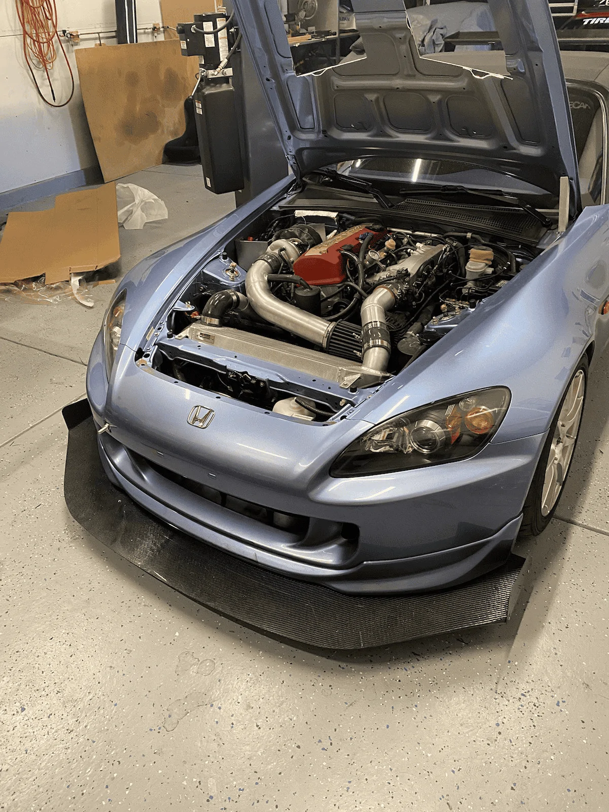

It's in the middle of a change right now as I just removed the soft top and added a roll bar, harness, etc. I wrapped the hood awhile back when I cut the holes for the vents, so I need to go back and wrap the rest of the car (it sat a lot when I lived in Denver). I love the color it is, but track time with Hoosiers and fast groups really beat it up and I figured wrap is replaceable.

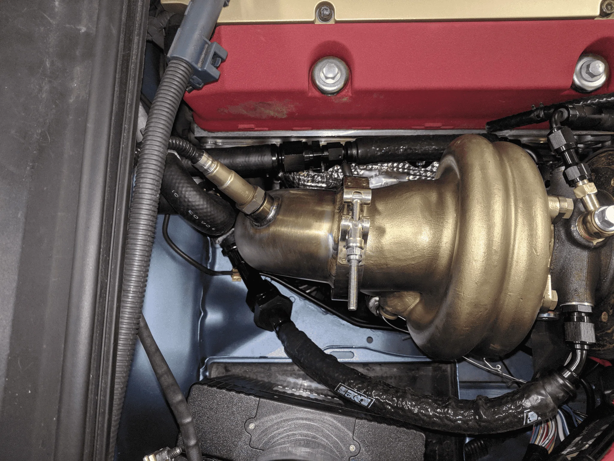

What does it have done... Cliffs...EFR 7064 turbo (twin scroll, paired cylinder manifold), E85, V-mount, aero, brakes, and all the things to keep a track car running. I currently have an AEM EMS v2 in as the ECU, but I have a Haltech Elite 1500 here that I am tempted to swap in and retune as it's got some additional features I think I would like having.
It hasn't been washed in 2 years, but it's still in really good condition once I wash it and buff it out. It just hit 39k miles recently.

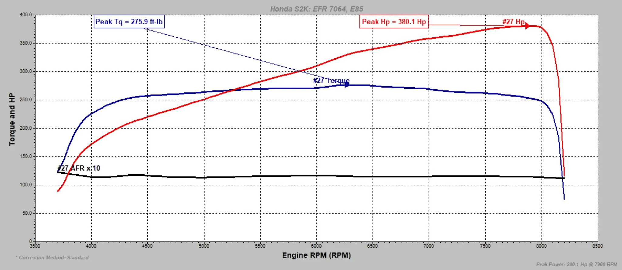

My track tune is 8 PSI flat and an awesome torque shelf:
My last track day in this car was with only 4.5ish PSI and it was a blast to drive:
I was actually in Denver a couple weeks ago tuning this for the 3rd time. He got another turbo upgrade and this thing is nuts. It made 557whp and weighs like 2,400 lbs.

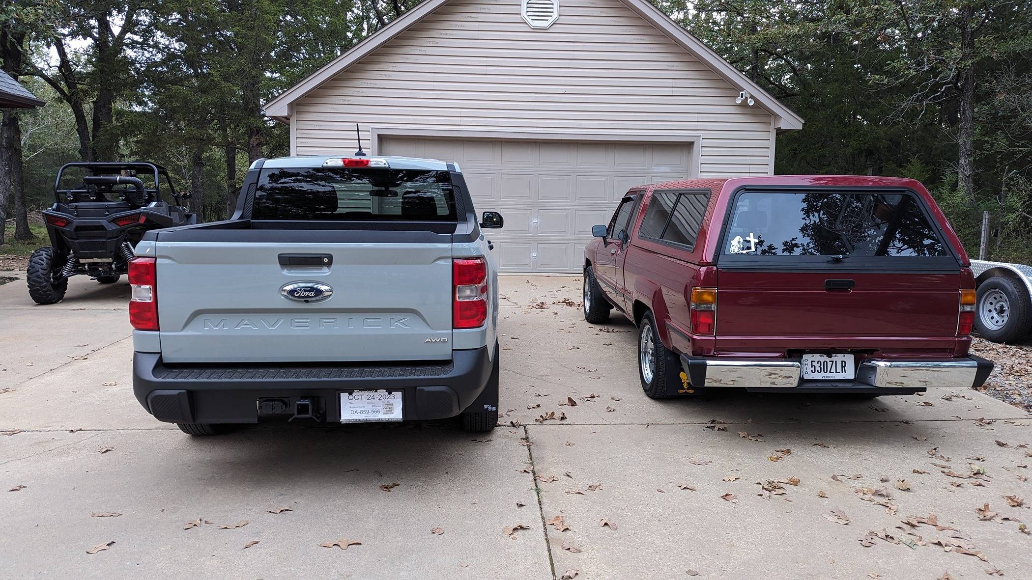

Even my wife's Maverick is bigger. :)

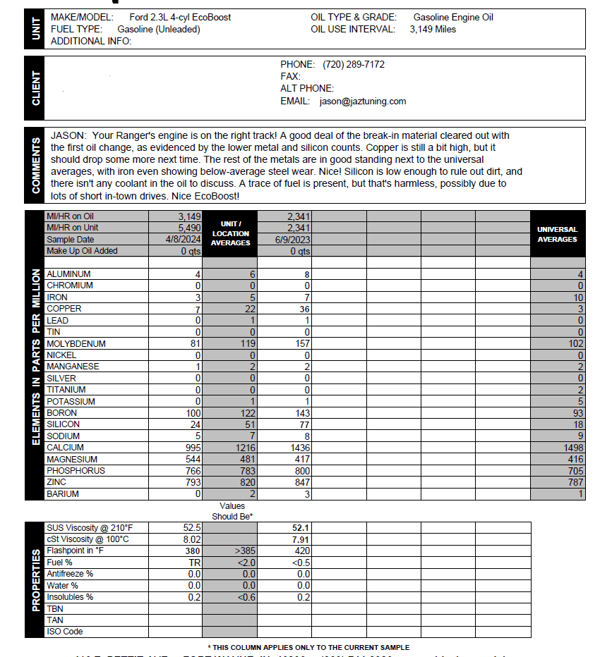

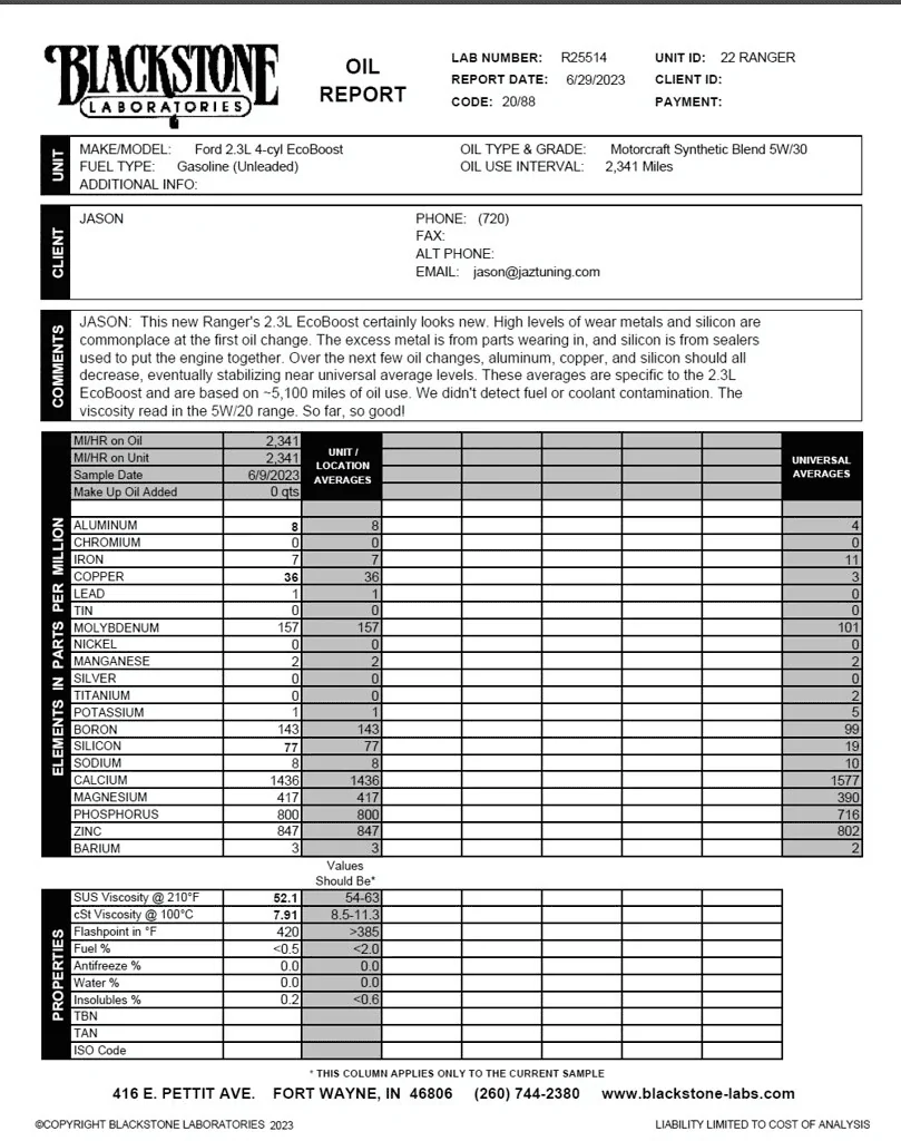

I also recently did my second oil change. I took a sample that I need to send off to compare to the first sample of the factory fill. I also switched over to Motul 300v 5w40 on this change. I'll sample this at changes as well.

I changed my oil pretty early on mileage as I wanted to clean out the break-in junk as well as see how bad this oil shears... The contents/contaminates in the oil are what I expected, but I was a little surprised (although not) to see it already shear to a 20 weight in 2,300 miles.
I put in the OEM oil with and FL-400 filter and plan to only run it about 2,000-2,500 miles. After that, I am switching over to Motul 300v, 5w40. I will continue sampling.
No fuel detected!
Other than that, I've made a few changes to my transmission tuning and it just drives proper now. I also have seen, by going back to the OEM tune and then back to my tune for extended periods, my MPG's go up on my map. I have not touched the engine tuning yet, but that is coming soon as I plan to know that out with tuning on the Ford Maverick we have scheduled to be built in a few weeks.

2nd oil sample came in... About the same and you can see how the break-in oil varies from the OTS Motorcraft oil. I will be curious to see how my oil selection does on the next sample.

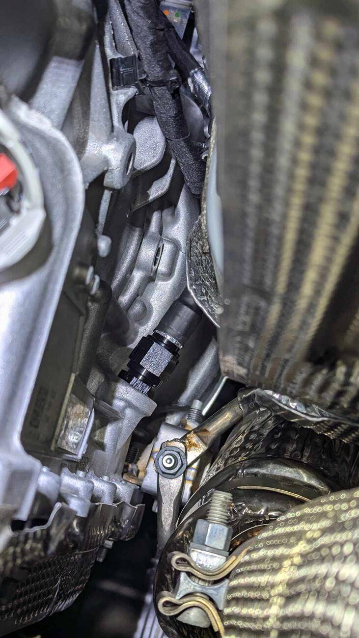

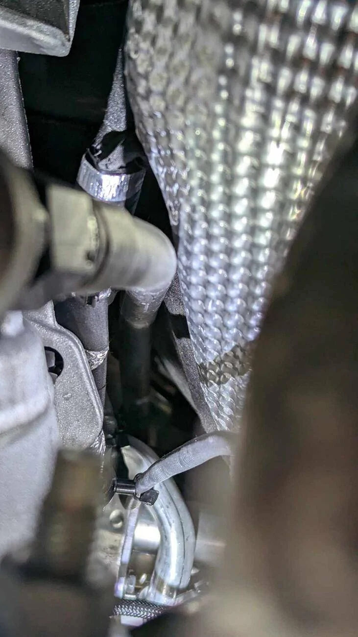

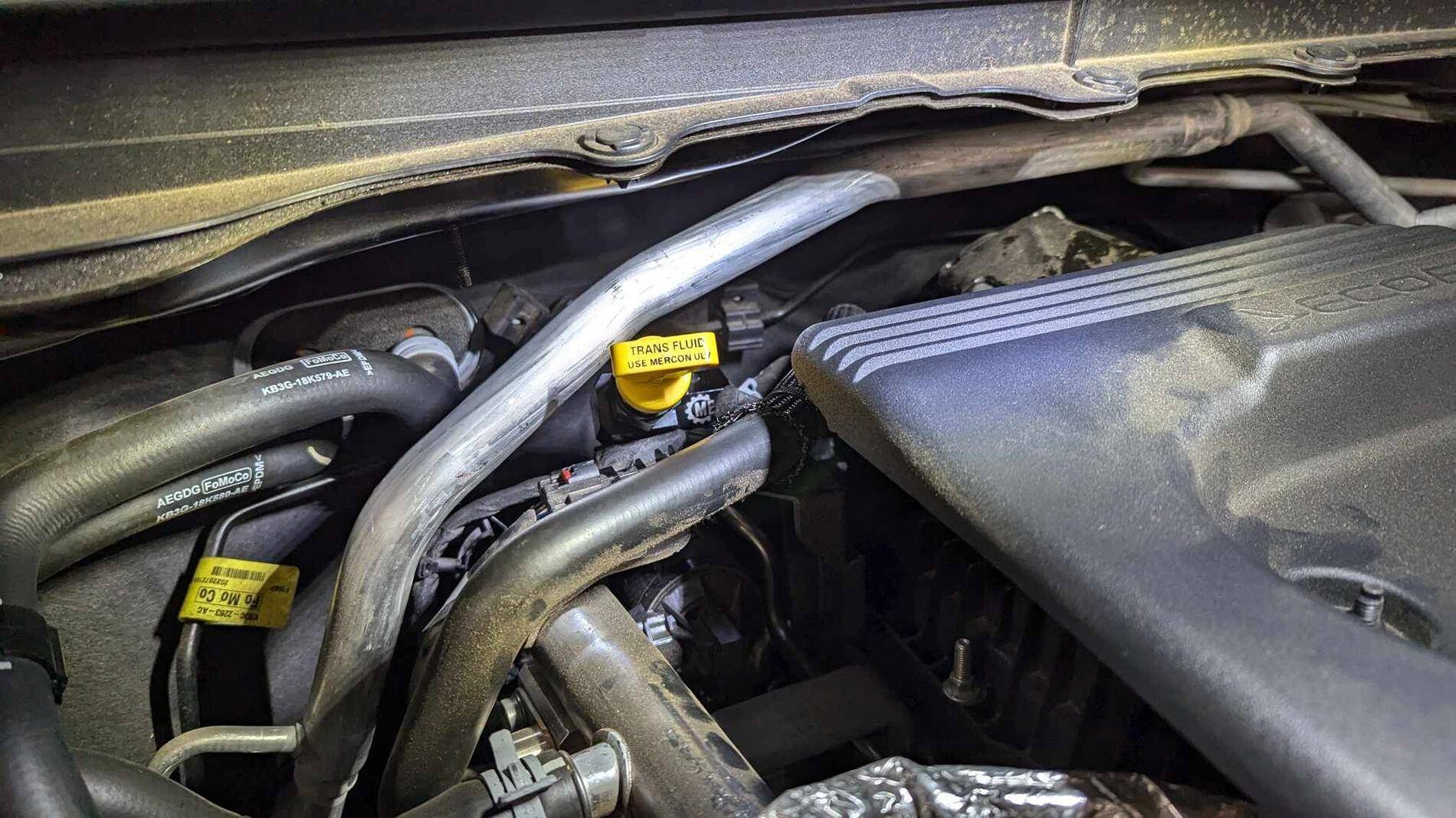

I have a PPE pan to install and wanted to be able to set the fluid level without going around the cat, so I installed an MBS transmission dipstick. The process was pretty easy and the hardest part was getting the 8mm bolt on top to bit the threads and tighten up. I spent more time on that then all of the rest of it.
Not sure how much the crush washer seals since it sits in the machined channel... A stat-o-seal might have been a better option here.
