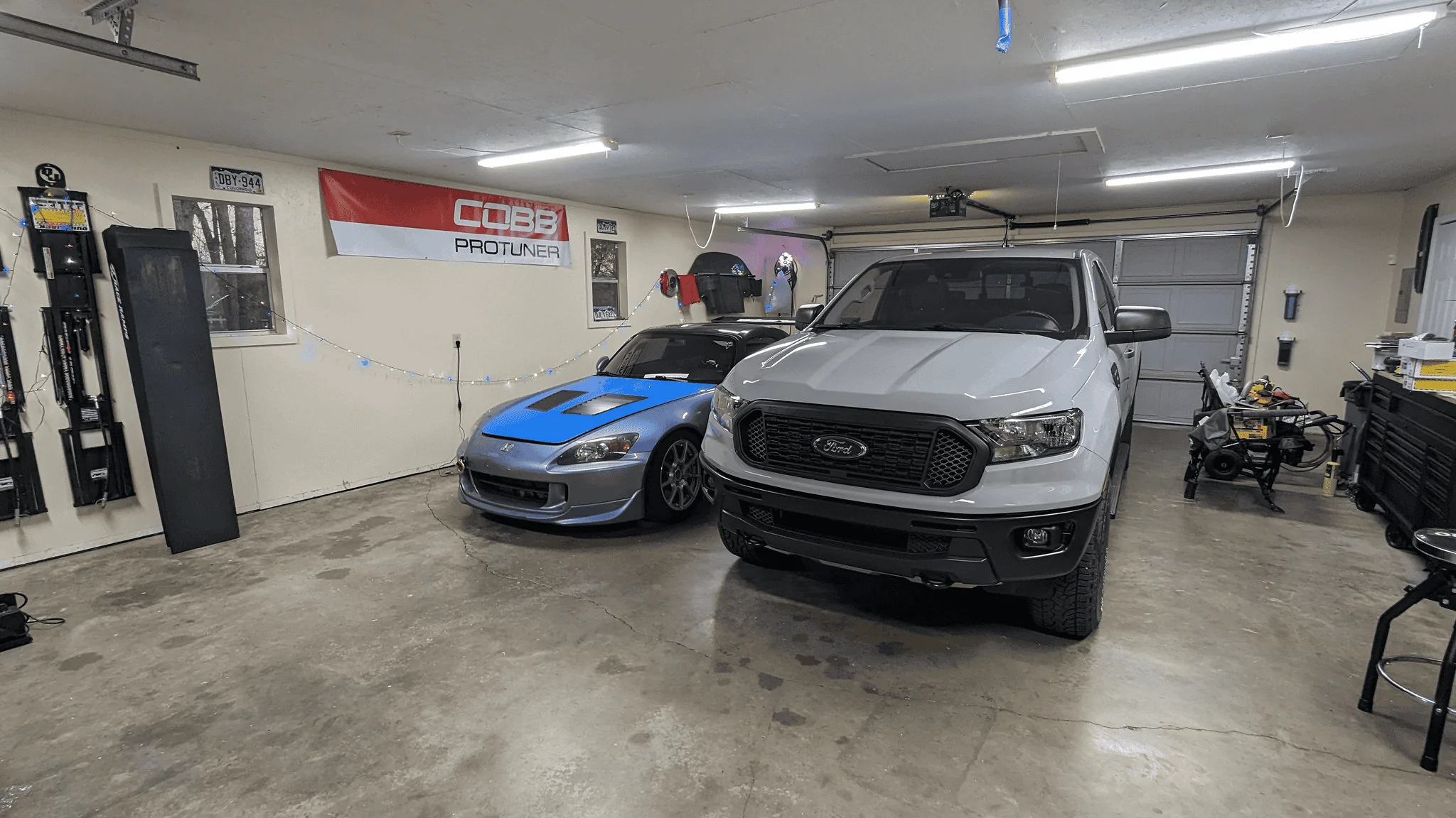

Yep, I park away from everyone else...

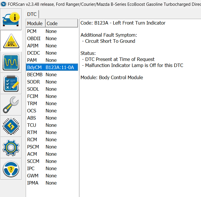

My left interior indicator start a fast blink... Later went away, came back, and is away and working properly now. When it happens, I get no blinker from the headlights. Yay, aftermarket parts.
I'm having the same issue with the left blinker, I have tried various things in FORsan with no luck. You mentioned its working now, how did you correct the issue??
I had to connect the battery power to it. It stopped doing it after that.

I had go connect the battery power to it. It stopped doing it after that.
Fuse 19 or 24. "24" is supposed to be the fix per Morimoto..:facepalm: Did both, no change. Thanks for responding.

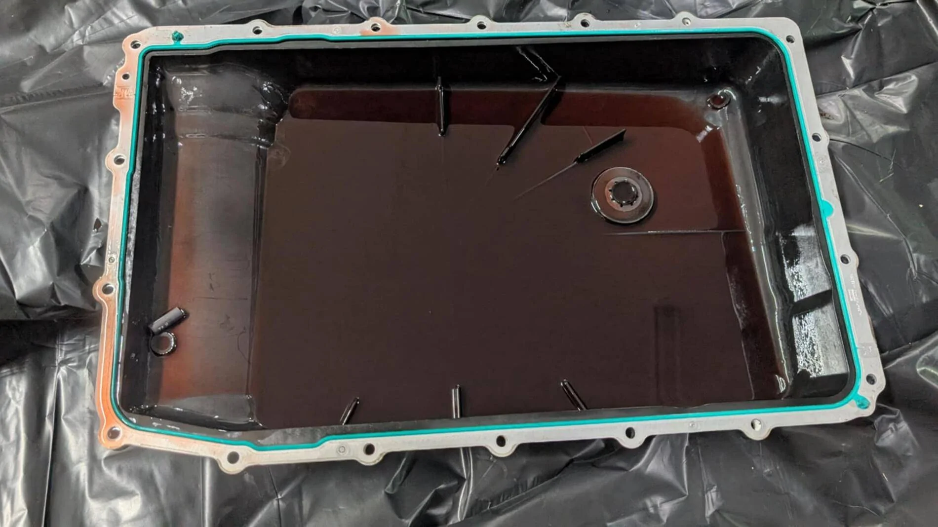

Coming up on an oil change, where I will take another oil sample from. Also going to put on a new transmission pan and change out the fluid. I need to re-grease the slip yoke as it's warmer out again and I feel it catching when stopping and taking off. Still irritated that a new vehicle (under 10k miles still) needs this done.

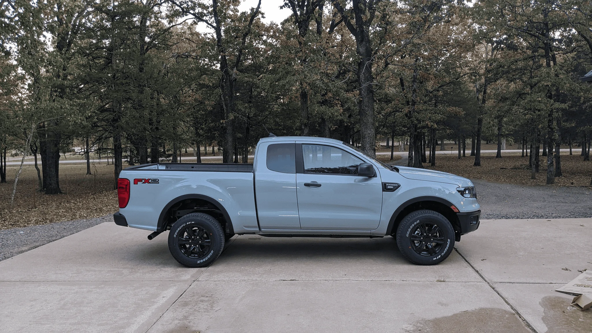

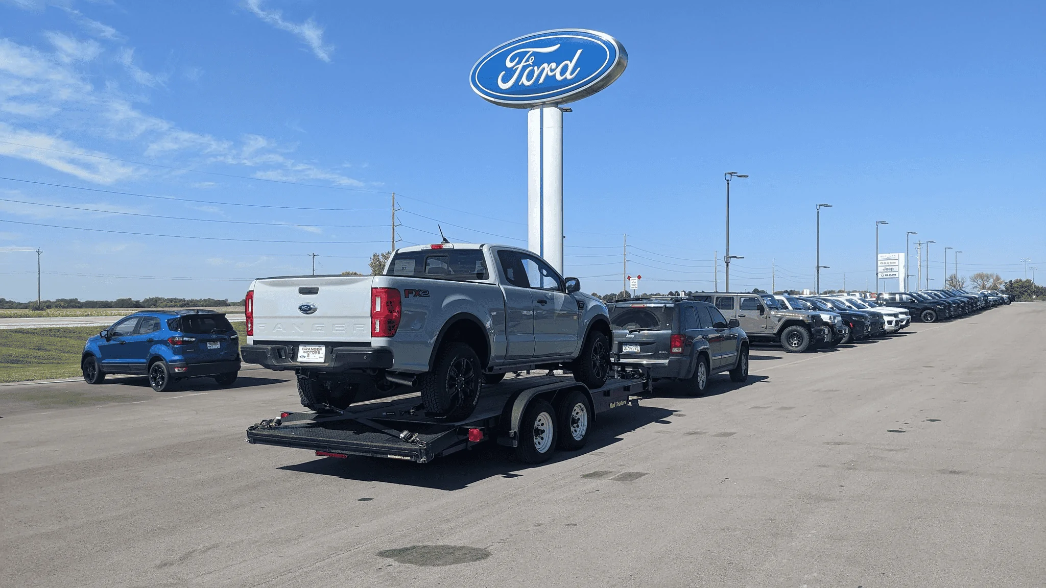

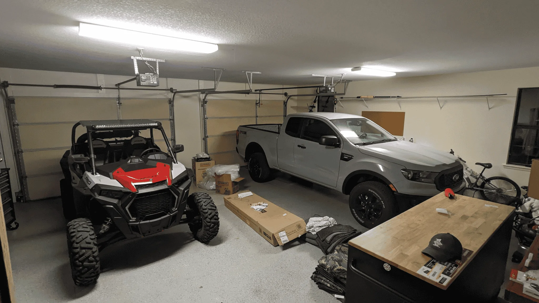

Getting on, here are pictures the day I picked it up from Granger, in Iowa after a 6 month wait:

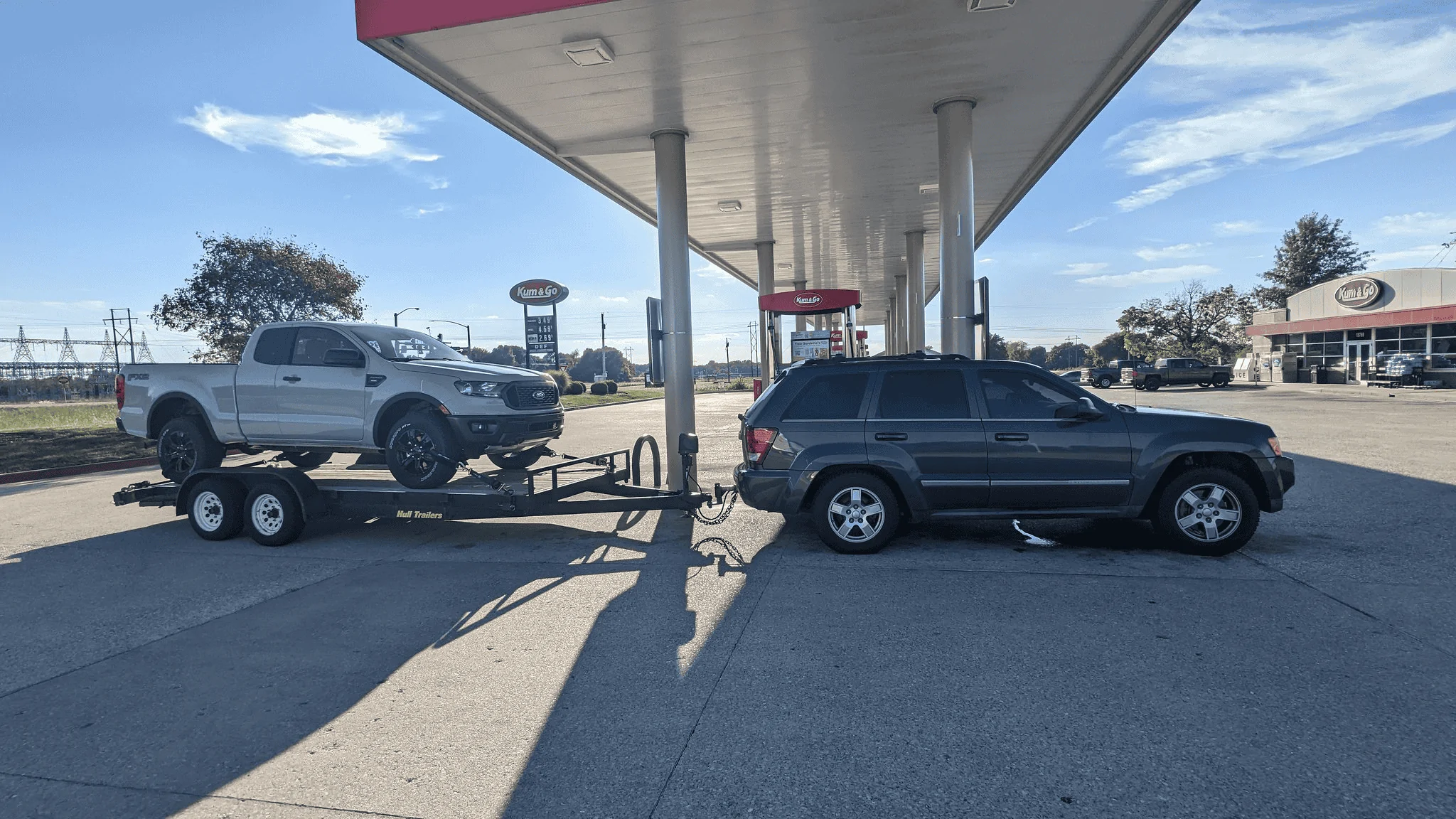

Almost home:
Home (we moved into this house weeks prior):
The RZR actually matches pretty well :)

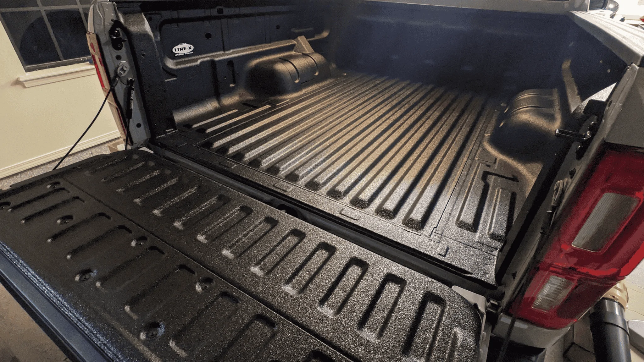

First part I added, I don't have a picture of... The ignition key trim seemed like a must. I got plain black... But right after that, I had the bed coated in Line-X Premium (and a damper... <insertstupiddamperjokehere>):

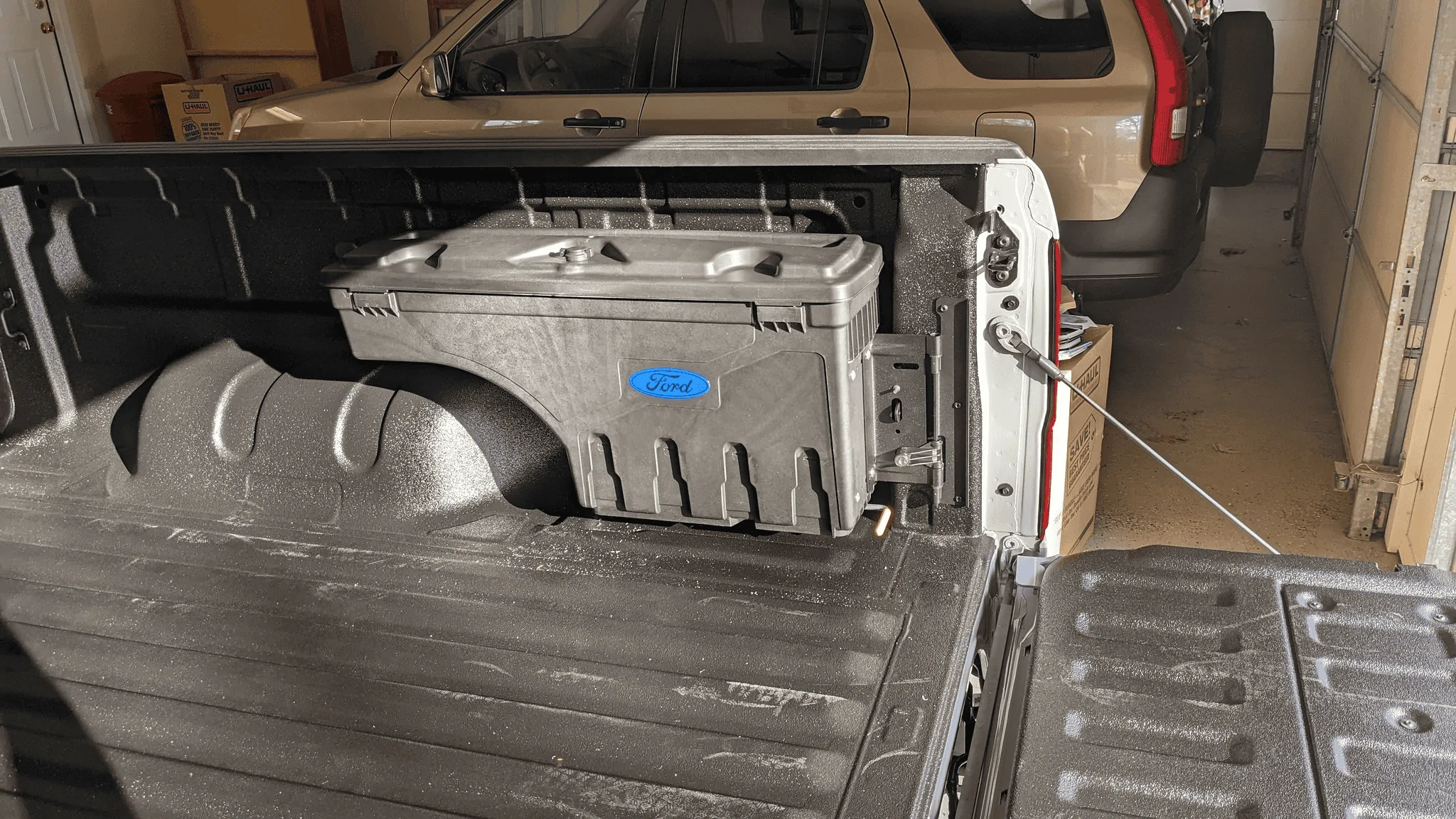

And added the Ford toolbox. It was like $12 with my Ford points:

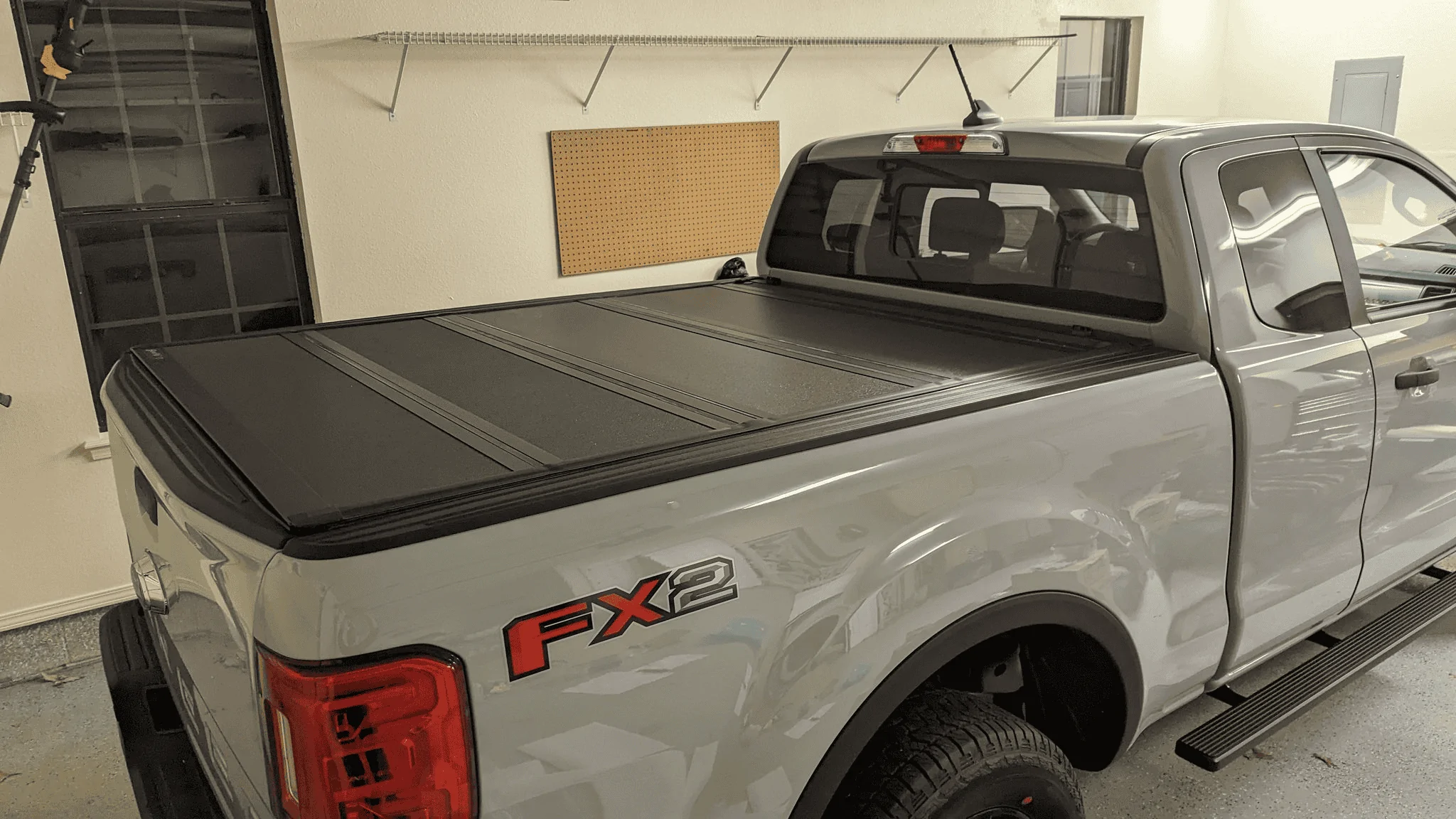

Next was a Bakflip cover:

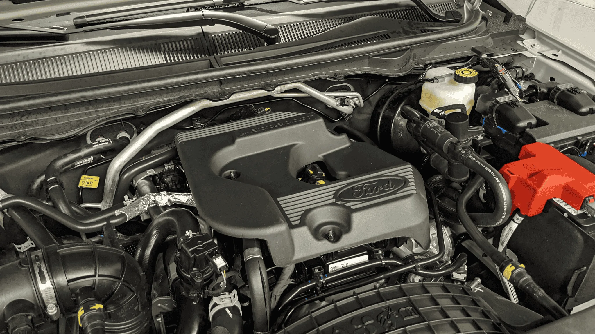

I'm getting older, so I wanted to see if the engine cover helped with noise reduction. It does enough to make me not regret the purchase and I got it before the price hike.

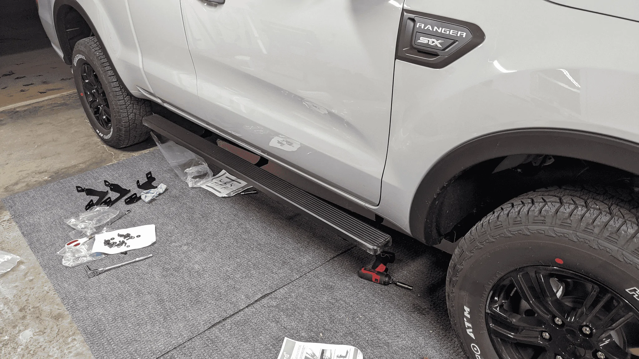

After driving it a bit, my wife struggled to get in and out of the truck, so even though I don't like the look of runner boards, I picked up some of the slimmest ones I could after some research on these forum. Amazon to the rescue:

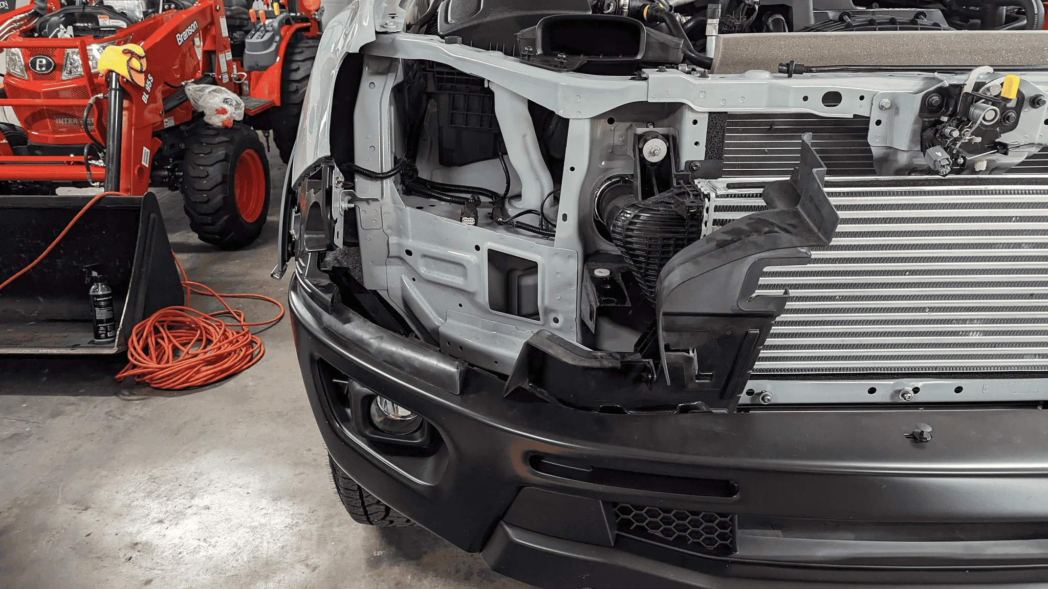

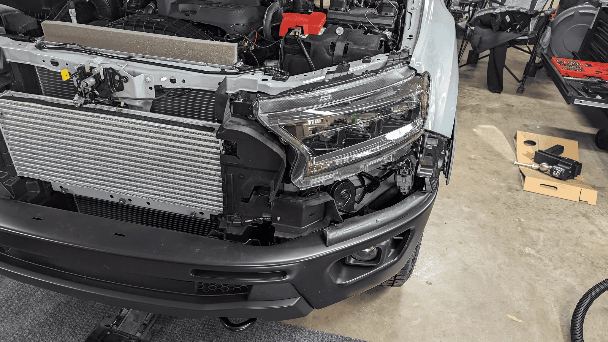

Removal of the stockers:

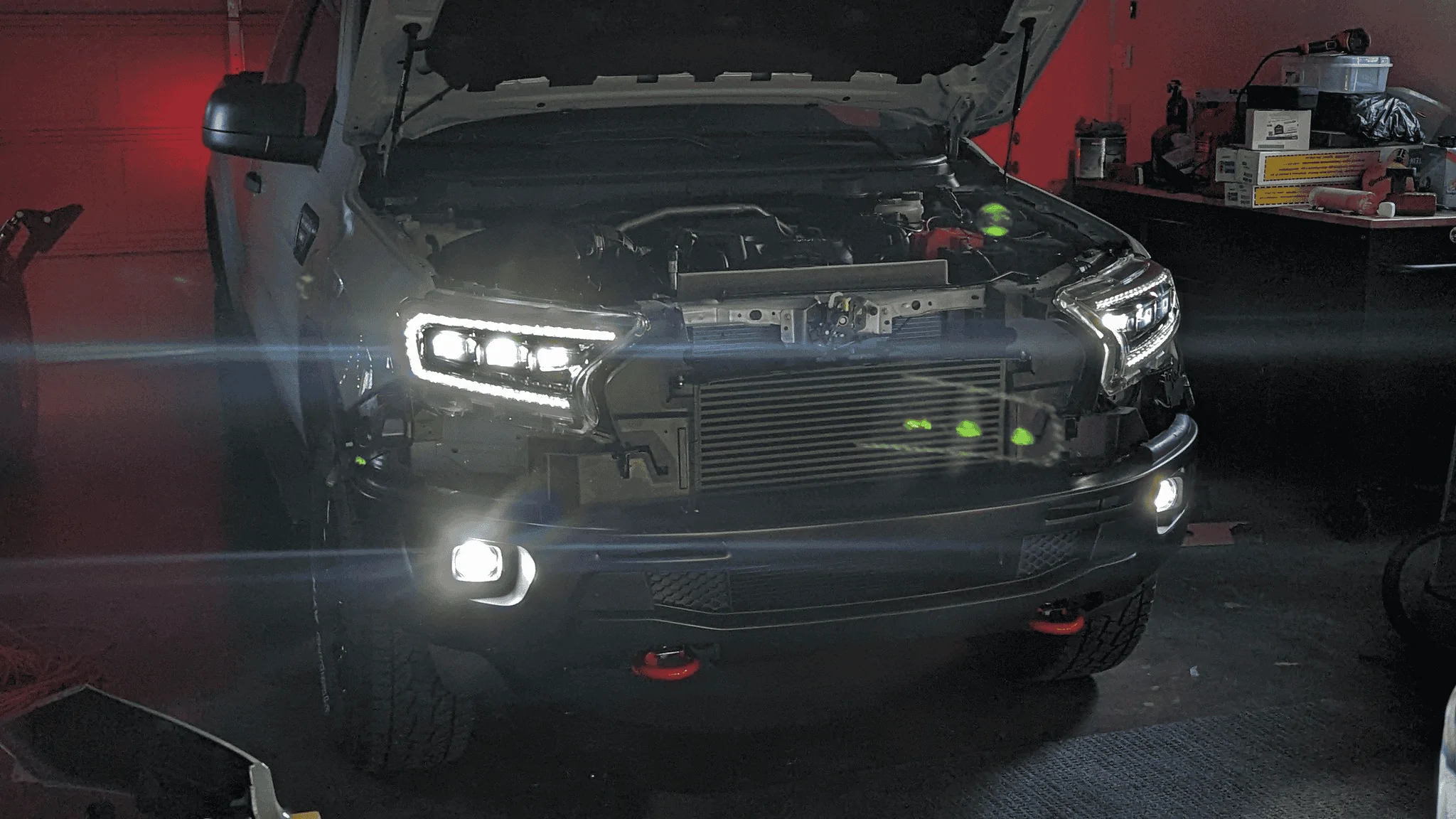

Morimoto's installed... Also put in red tow hooks so I could use an actual FX4 skip plate:

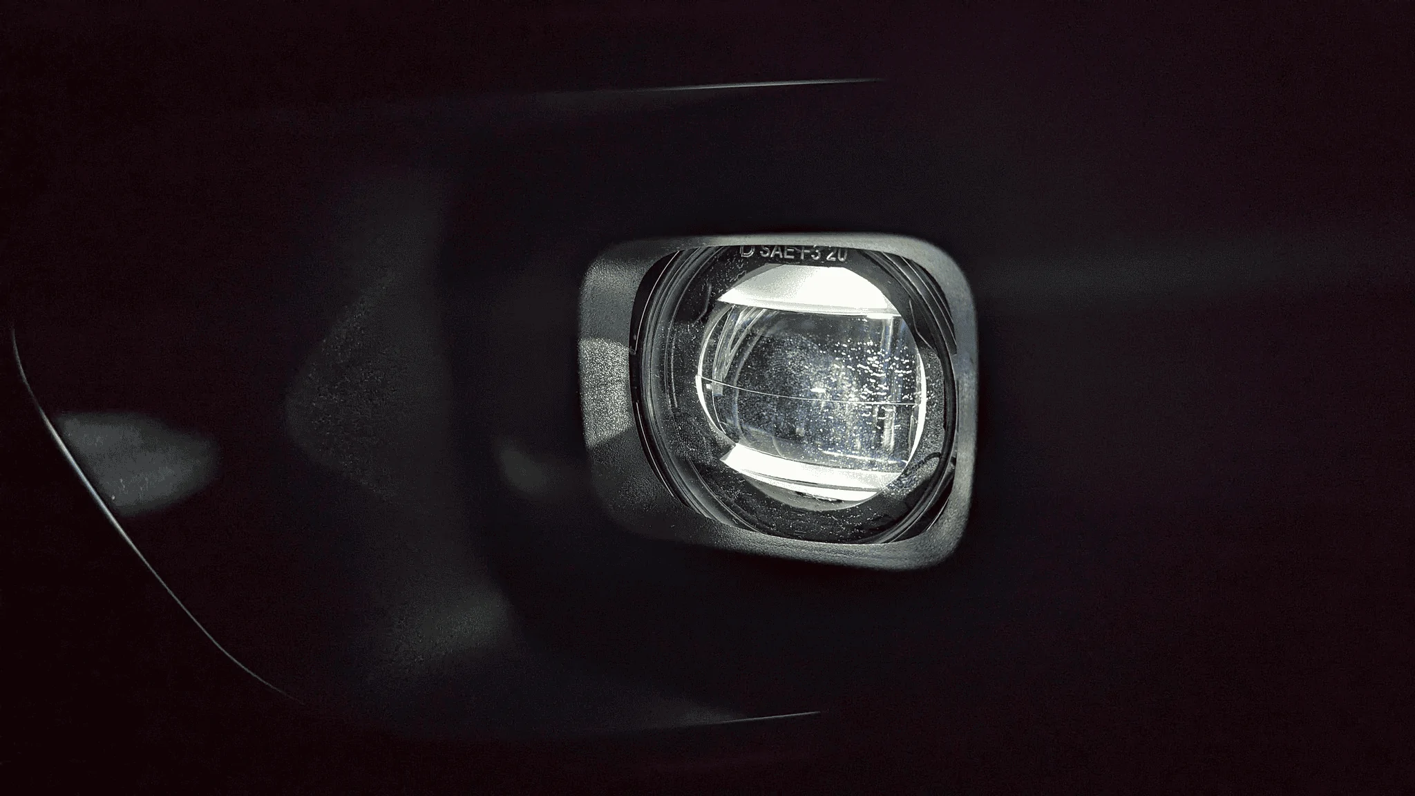

Diode Dynamics fog lights installed w/ fresh clear bra:

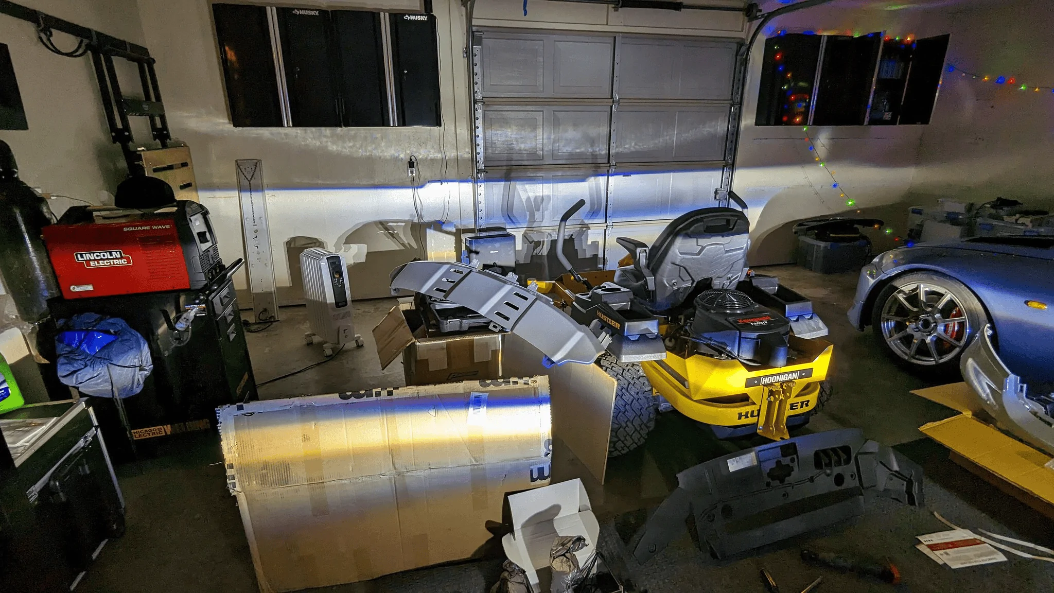

I'll have to do an alignment and get some better shots, but a quick alignment with tape from the stock halogens:

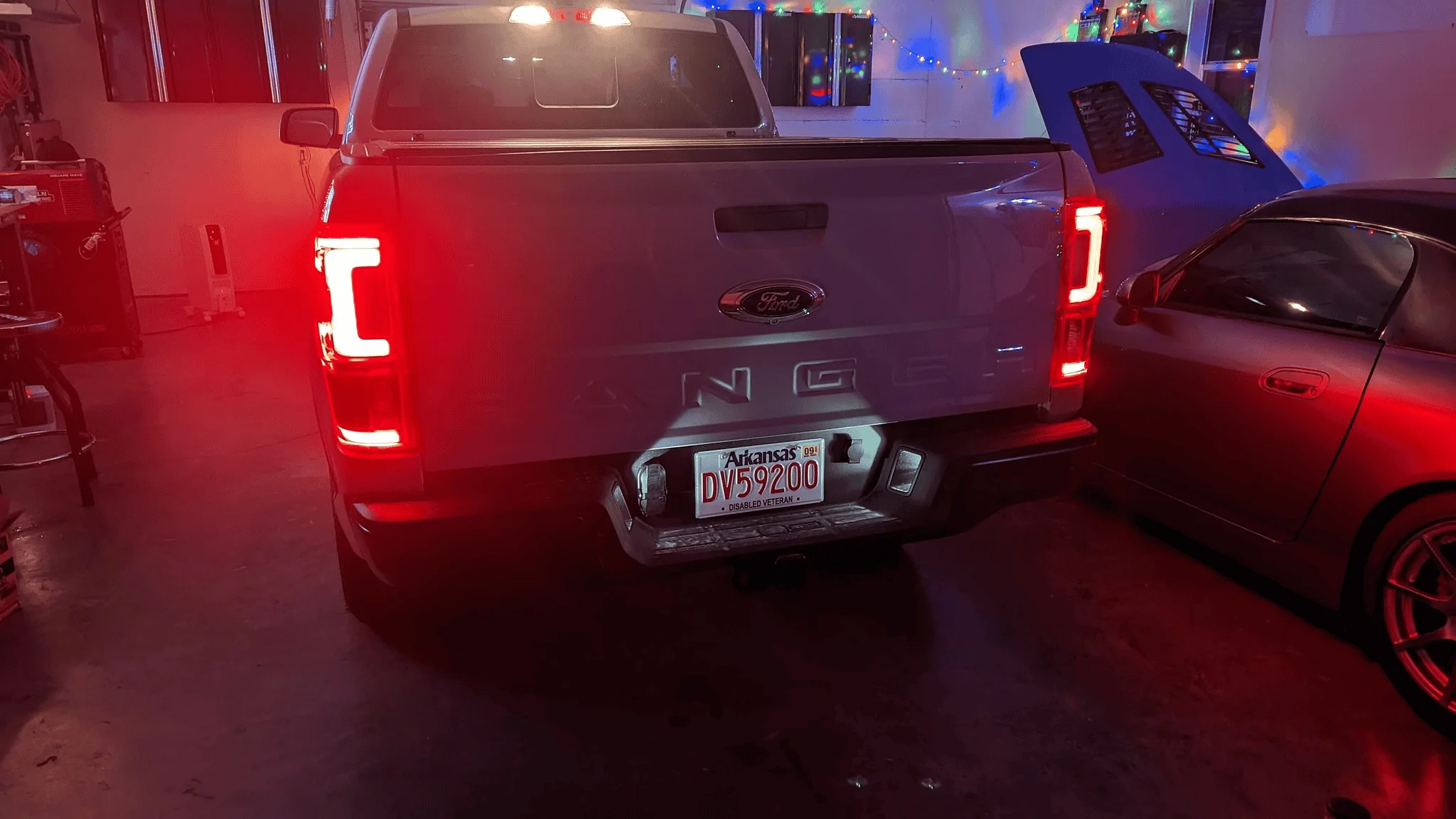

I have also replaced the license plate lights and side markers with LED's (I'll do the high mount lights when I do the brake controller):

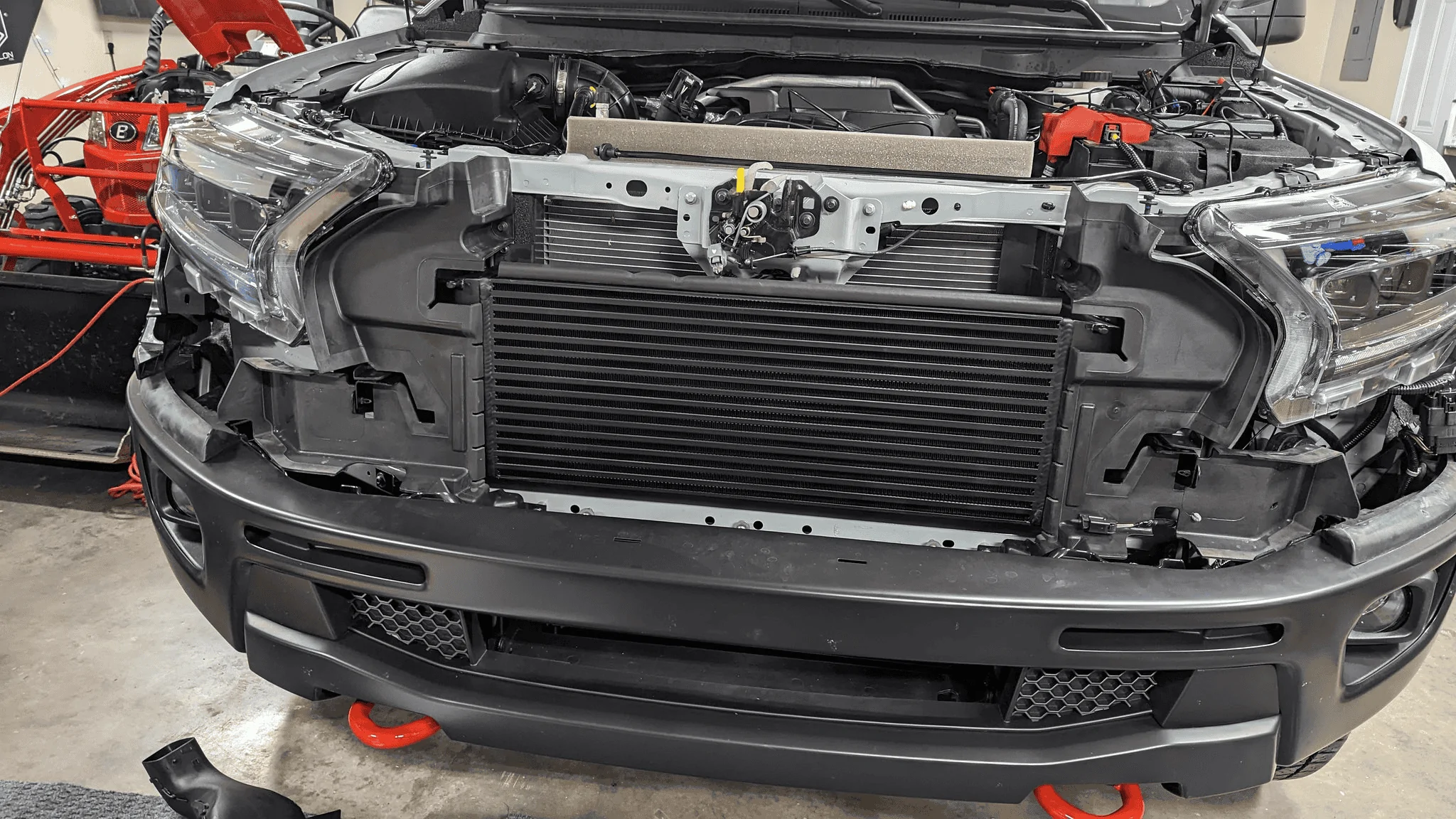

Mountune intercooler installed. I did have to purchase a few things to make this an nicer install. I purchased some expandable 1.5" foam tape for the bottom of the intercooler (like stock), longer screws for the upper plastic shroud, and PROPER T-bolt clamps. They include crappy worm-gear clamps... This is where I currently am, waiting on the clamps to arrive. I have no plans to do an intake or exhaust. The intake bang-for-buck is very low and I don't want any noise from an exhaust... I've never really liked loud cars, as even my toy and track cars are all pretty quiet.

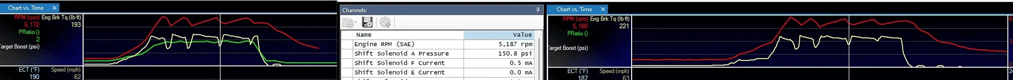

Prior to these parts and immediately after hitting 1,000 miles (just to make sure everything works as it should), I did start taking logs as well as did some transmission tuning. I could not stand the lugging of constant too high of a gear, and I wanted to firm up the shifts a bit. I have only tuned the transmission at this point:
Before/After WOT shifting:
