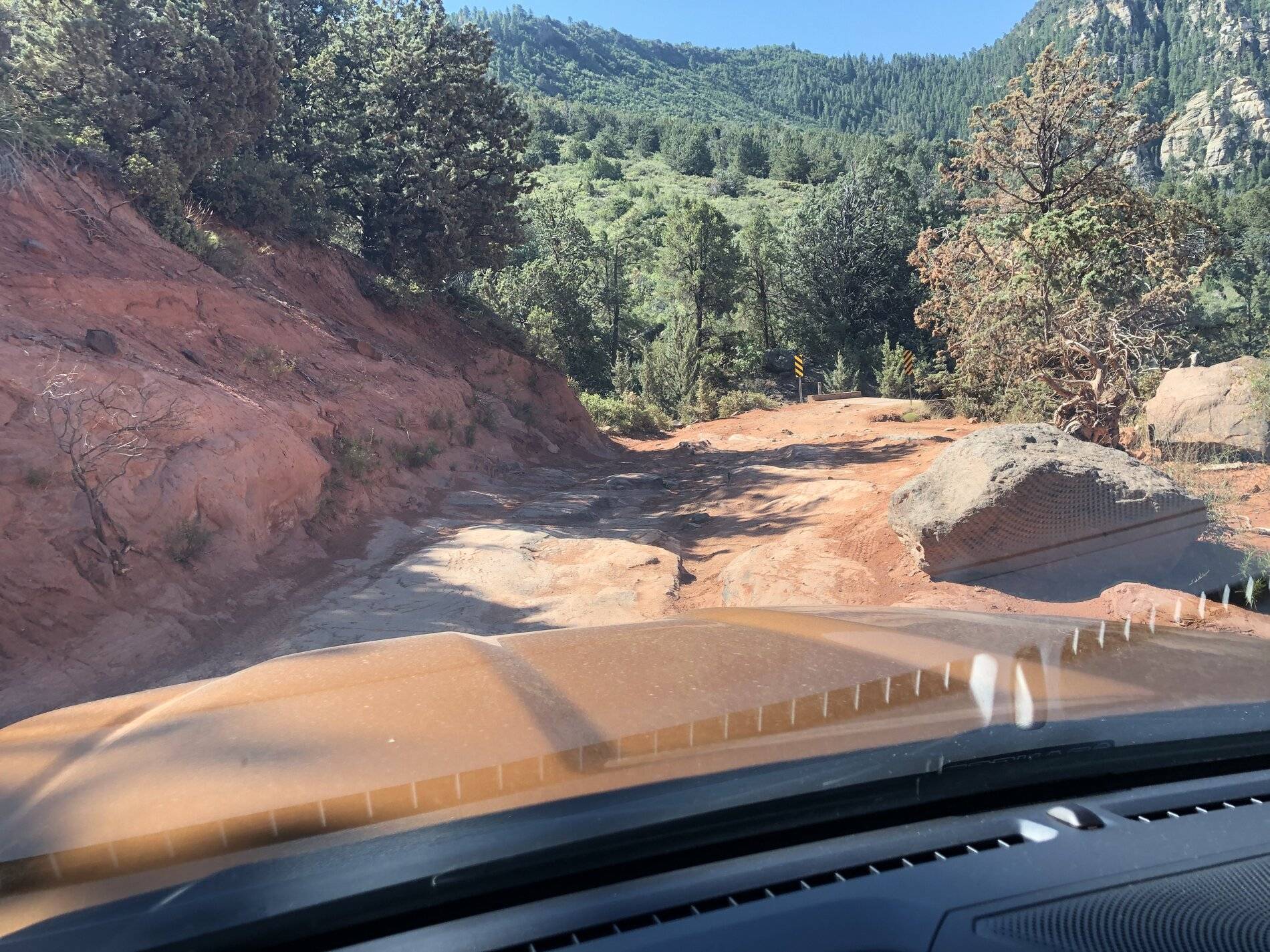

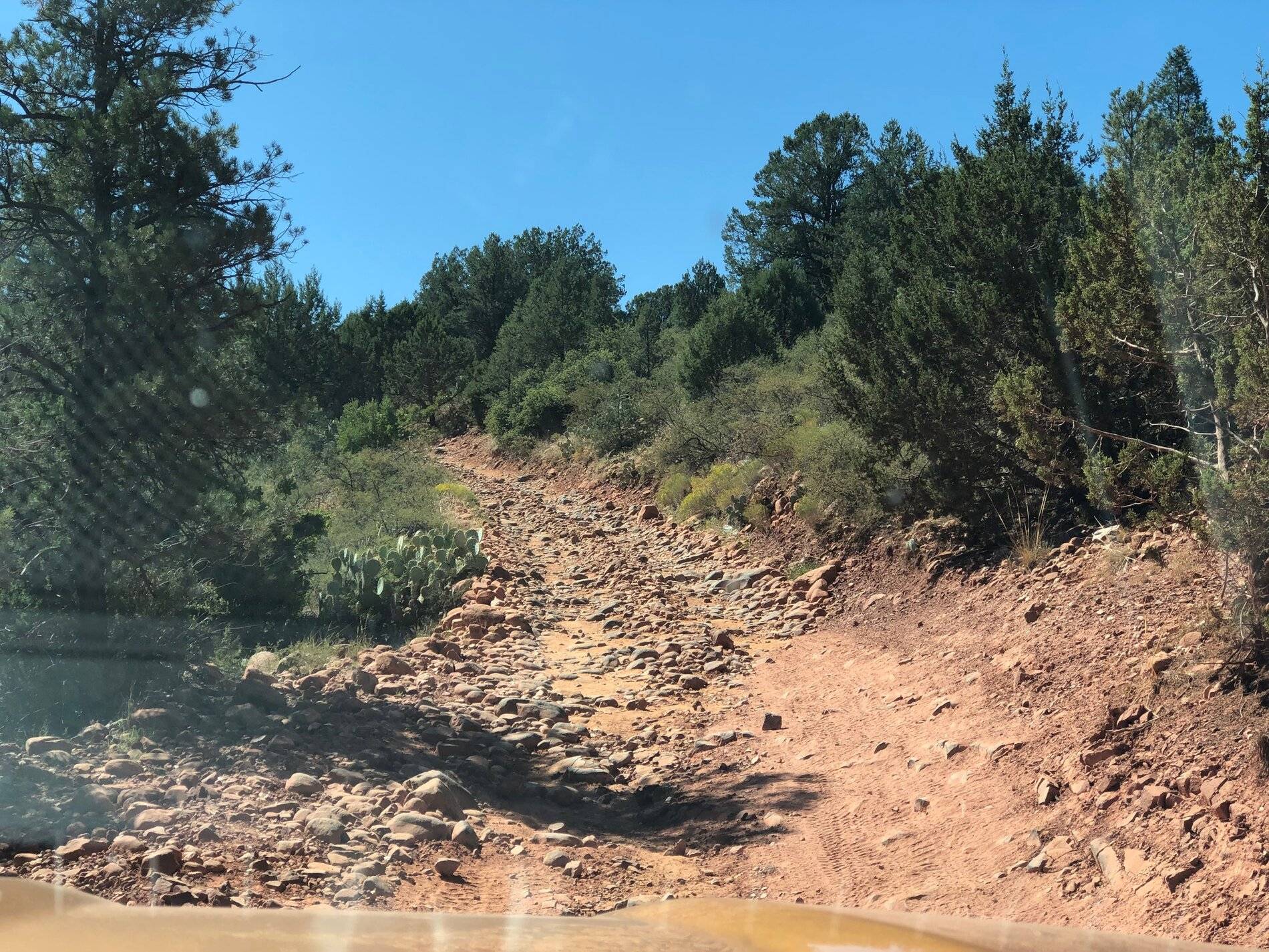

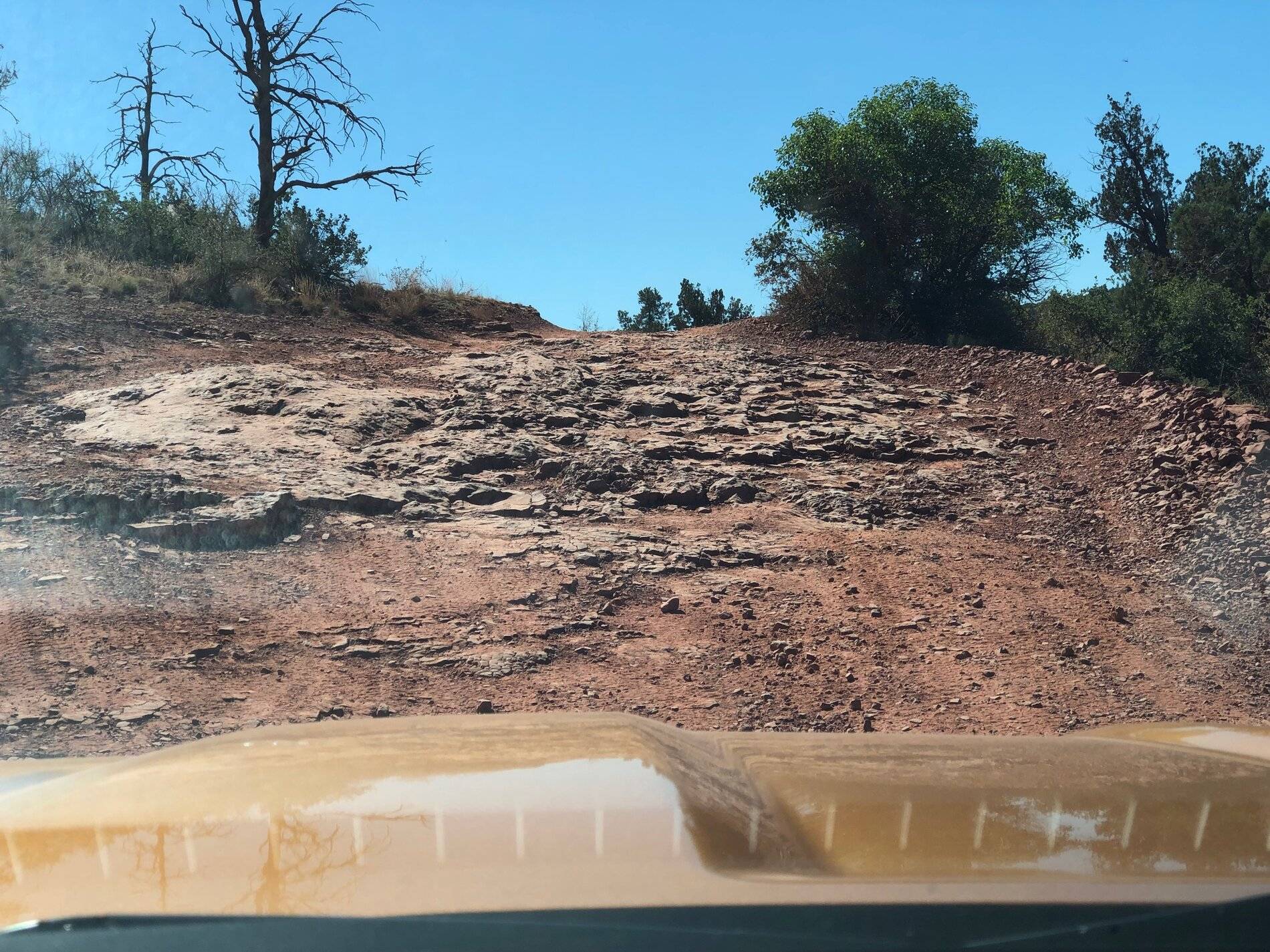

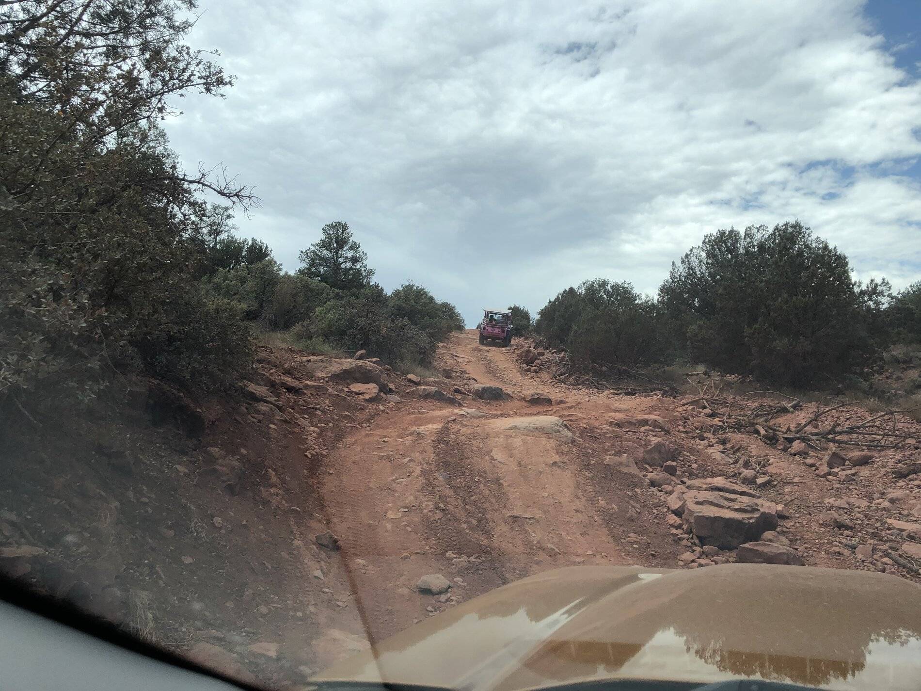

If you're doing fire roads or anything similar than yes you don't have to go down to 18 psi because you're probably going to be going 30 mph or more. Most times on those types of roads/trails I won't even bother to get out and air down but sometimes I regret it because the trail can change and you get tossed around more. When I go out I'm usually only going under 20 mph and in some areas 5-10 mph, I like going over more rocky terrain. I haven't been out in sand in a long time and seeing as it never really rains here I don't think I've seen mud in 10 years. lol
Those Aussies make some really good videos!
We were up in Sedona here and I was down to 18 psi

Does your truck have stock tire size? Or did you do a level and larger size?

I went up one size to 265/70/17 and a RC 2.5" level.

Nice. I wonder if a trail like that would be possible with stock tire size? A little nervous to go off road with it still, but also don't wanna upsize anything yet. That's about the extent of off roading I would ever do probably lol.

Man now that is a nice looking trail!! Generally the ones I have been on are not as rocky so you are right there. When it is washboard I lower it down more than 26psi but generally keep it above 20psi because of the speed elsewhere on the trail is 15+ mph.

I never took mine off road with the stock tires. I saw a few members who has punctured their sidewall just doing some light off roading so I changed mine out at 1000 miles. I think if you're just doing something less rocky you're good. Rob @RedlandRanger still has the stock tires and does a lot of fire roads with his without any issues.
