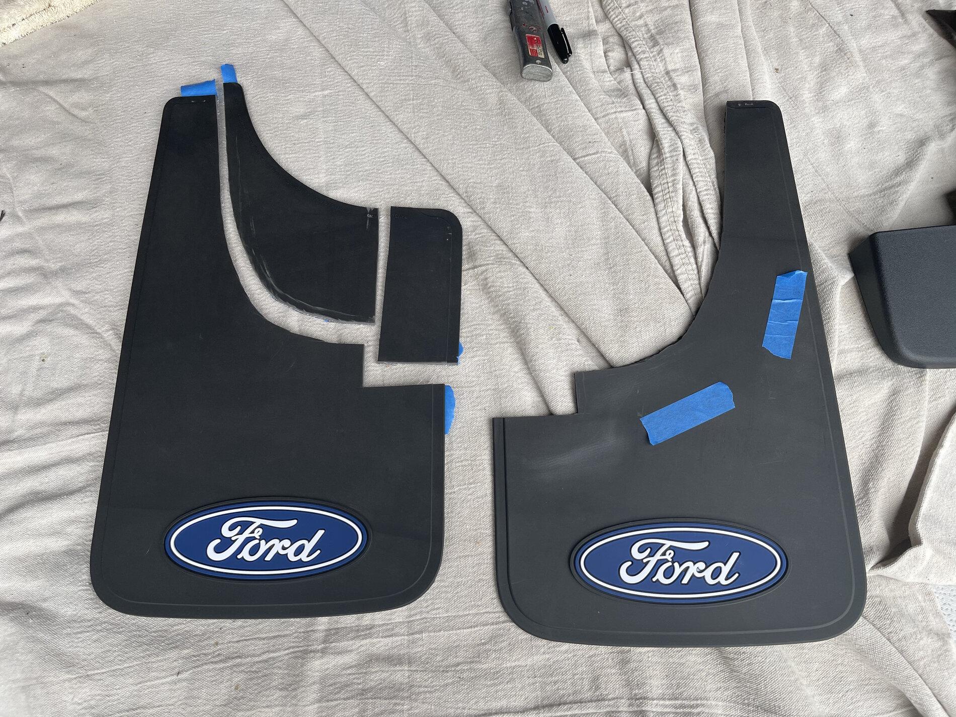

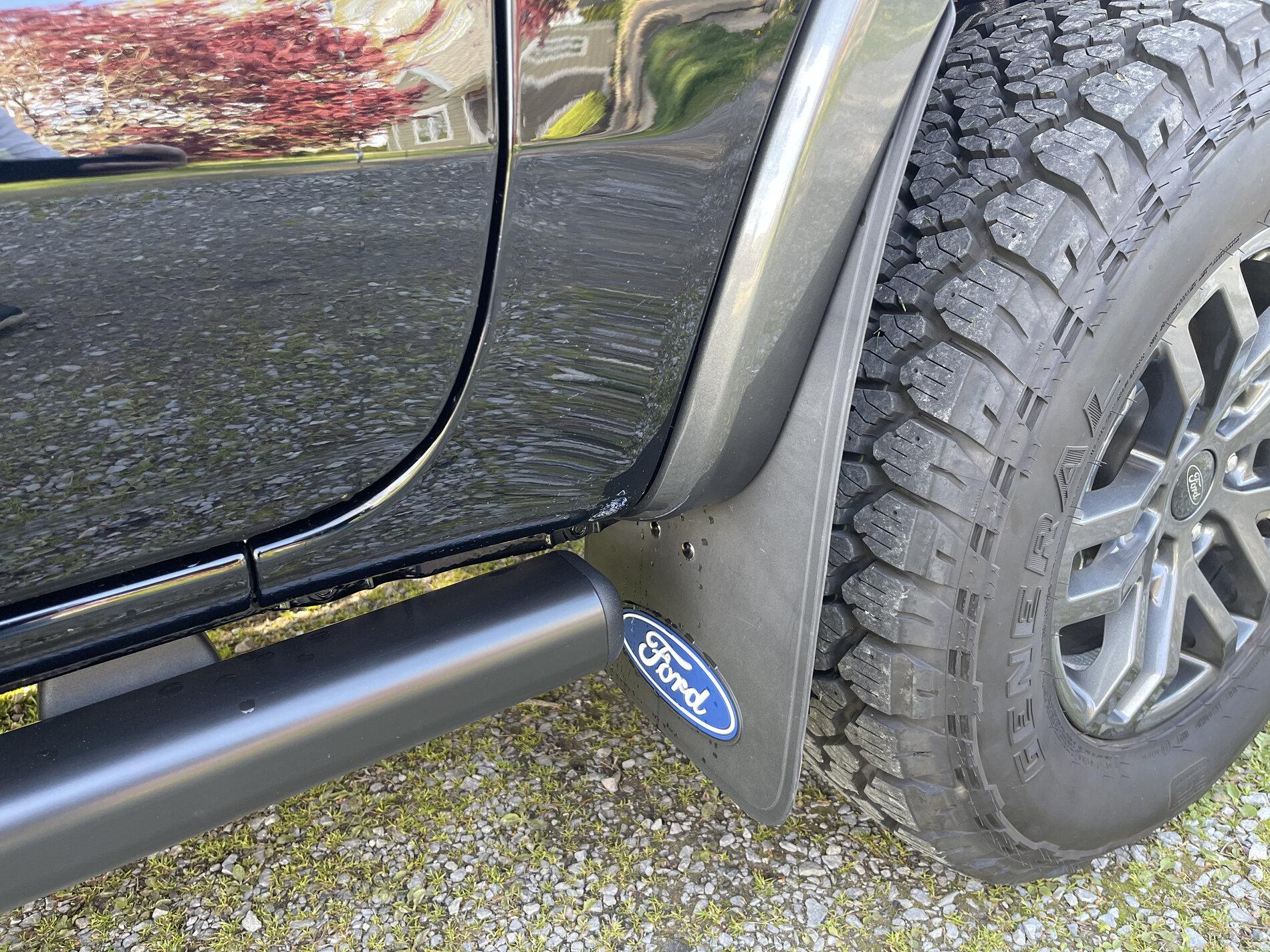

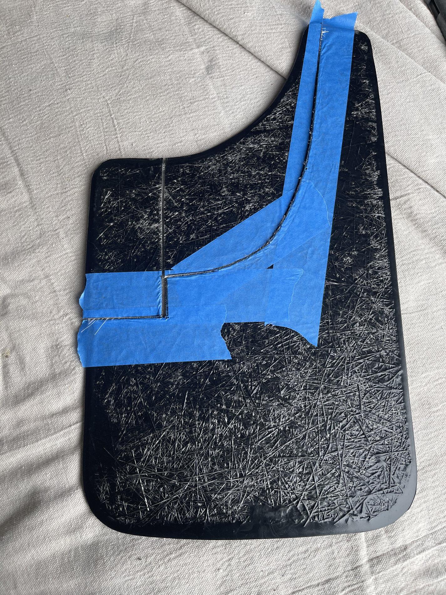

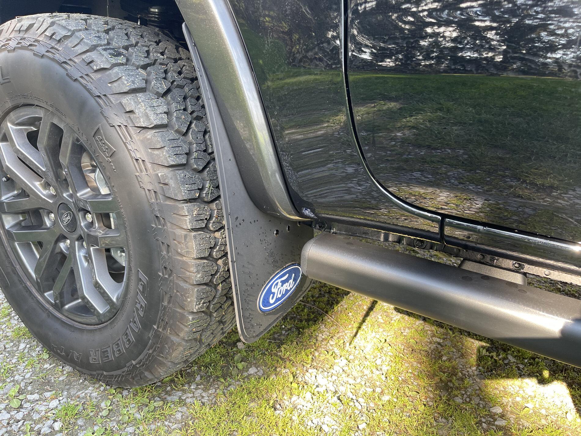

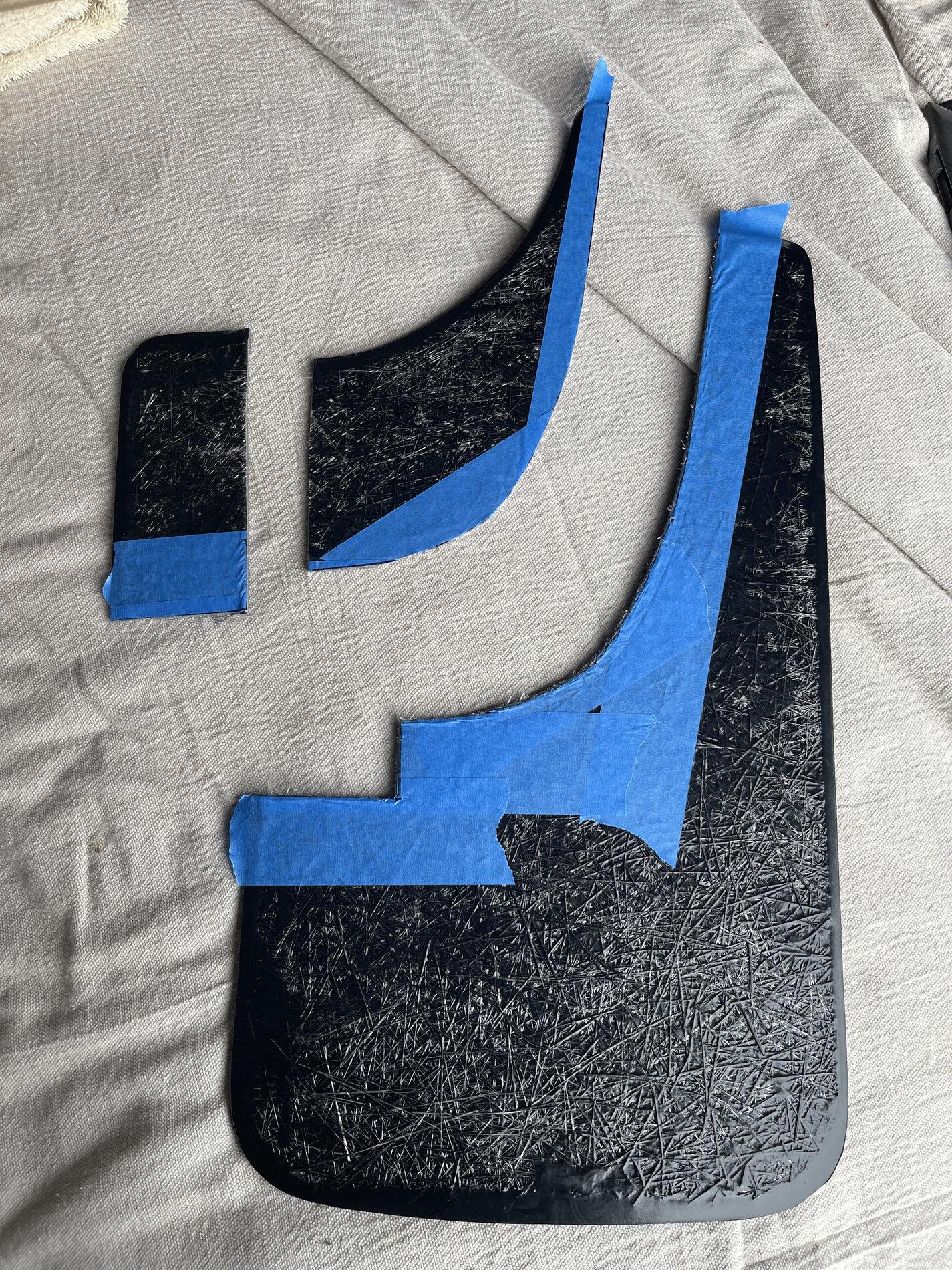

the Back were straight forward... Front's NOT so much. Started by making a template to cut the after marks flaps..
I then cut two strips of 18 GA sheet metal.. 1 1/2" wide b y 6" long
and used some brazier rivets to attach to the flaps
back side
Finished look
