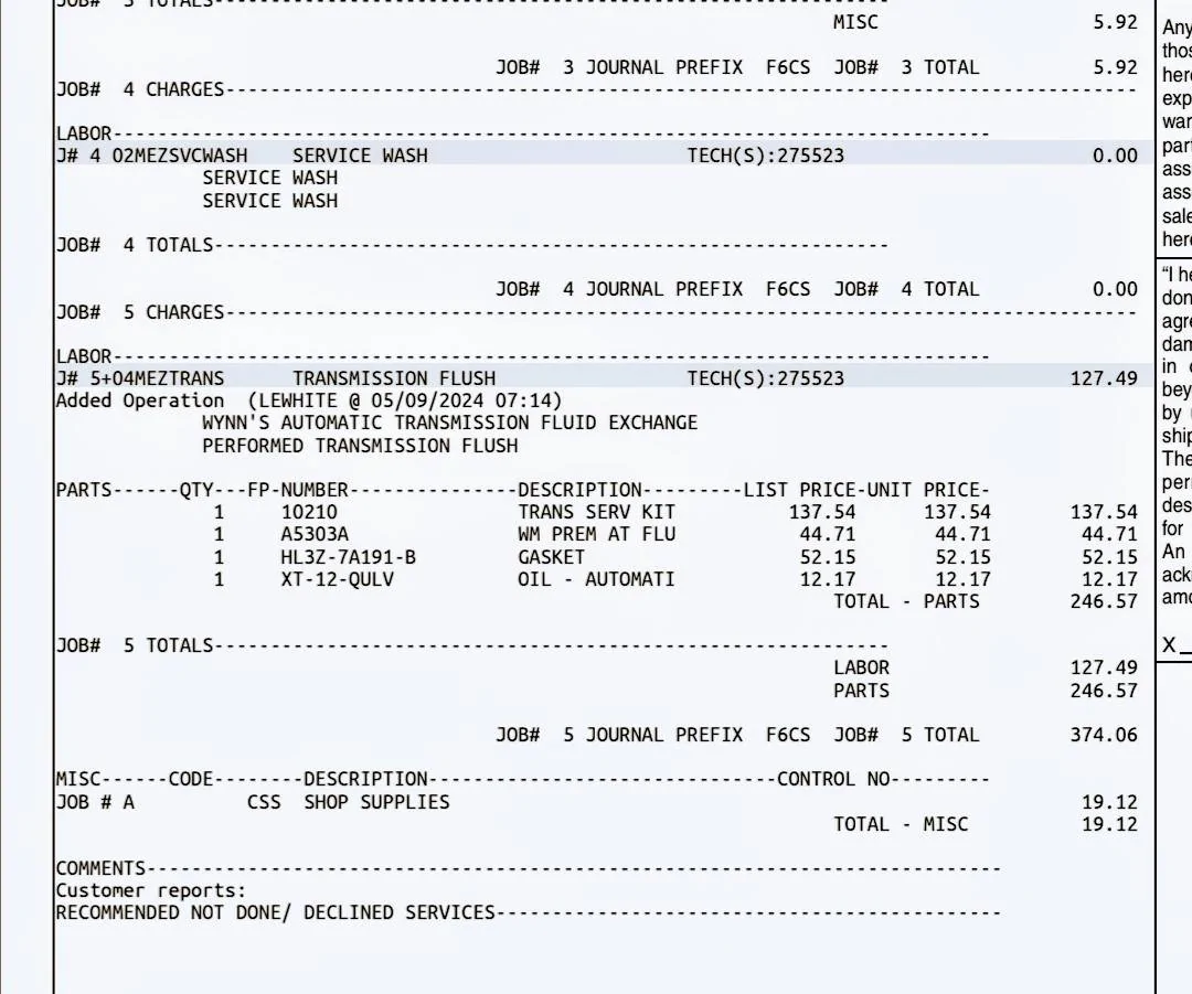

I'm commenting to hopefully add to this discussion. I can say that thanks to my MBS transmission dip stick my 2019 was correctly filled with ATF from the factory.
Just had the dealer flush and fill the 10R80 at approx 45K miles and it's only been a couple days. Transmission a little clunky and I am waiting to see if it sorts itself out (because of the new fluid). I haven't driven enough to properly check the fluid level so that will likely be over the weekend. I uninstalled the Unleashed tune (with the @TORQUERULES software) a month ago in prep for this. I'll be adding the Lubeguard Platinum next after verifying the dealer did a proper job.
Then give it a few days to see if I notice a difference before putting the tune back on.
BTW the dealer used WYNNS for the transmission service. Why a charge for a gasket when they told me they don't drop the one time use pan is curious unless it's from some other part of the system.
I'd definitely question the charge for the gasket. That's not chunk change.
I got a courtesy email from the store manager about experience and replied questioning it.
The service manager already knocked off $50 because they damaged my actual leather Redline parking brake boot and replaced it with a Ford part.
