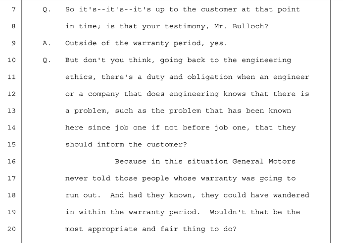

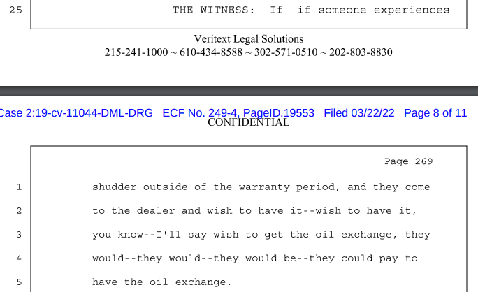

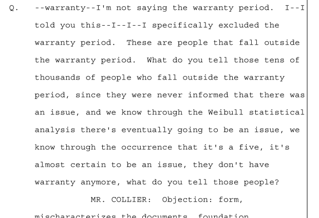

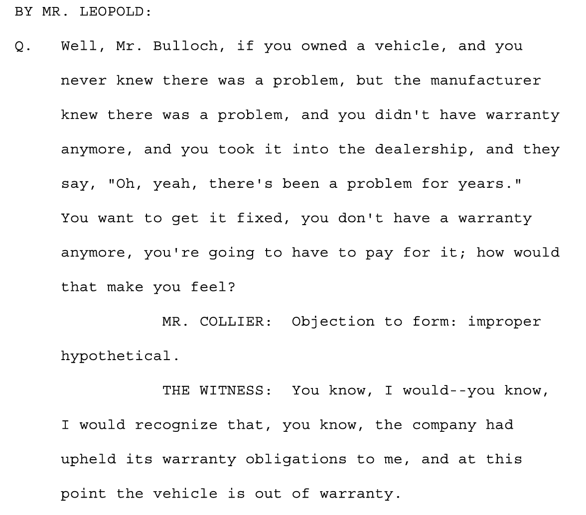

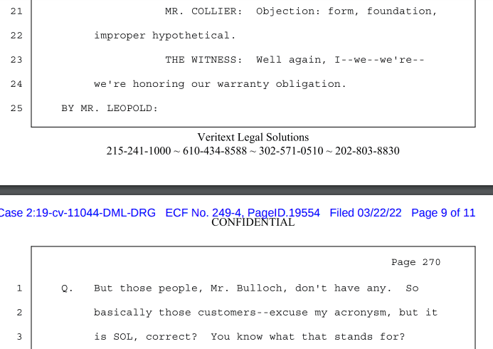

This is an excellent testimoney. Basically GM saying 'yep, there's a problem, but if they're even a little bit out of warranty F-em.
https://www.cohenmilstein.com/wp-content/uploads/site/ECF No. 249-4 Tab 84 to Class Cert Reply Bulloch Testimony.pdf

The descriptions on the last page - reads like what I told the service manager this morning . . .
Good to see Ford isn't the only ones ignoring the problem . . .
