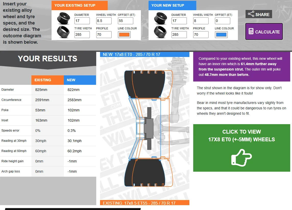

My 2023 has 17x8 methods 0 offset with 285/70-17s. Will those rims/tires bolt of with no drama? The dealer said we can swap the Raptor rims/tires to my truck at time of trade in.
Orange would be (assumed) OEM Raptor specs. Blue is what you have on your 2023 that you want to put on said Raptor.

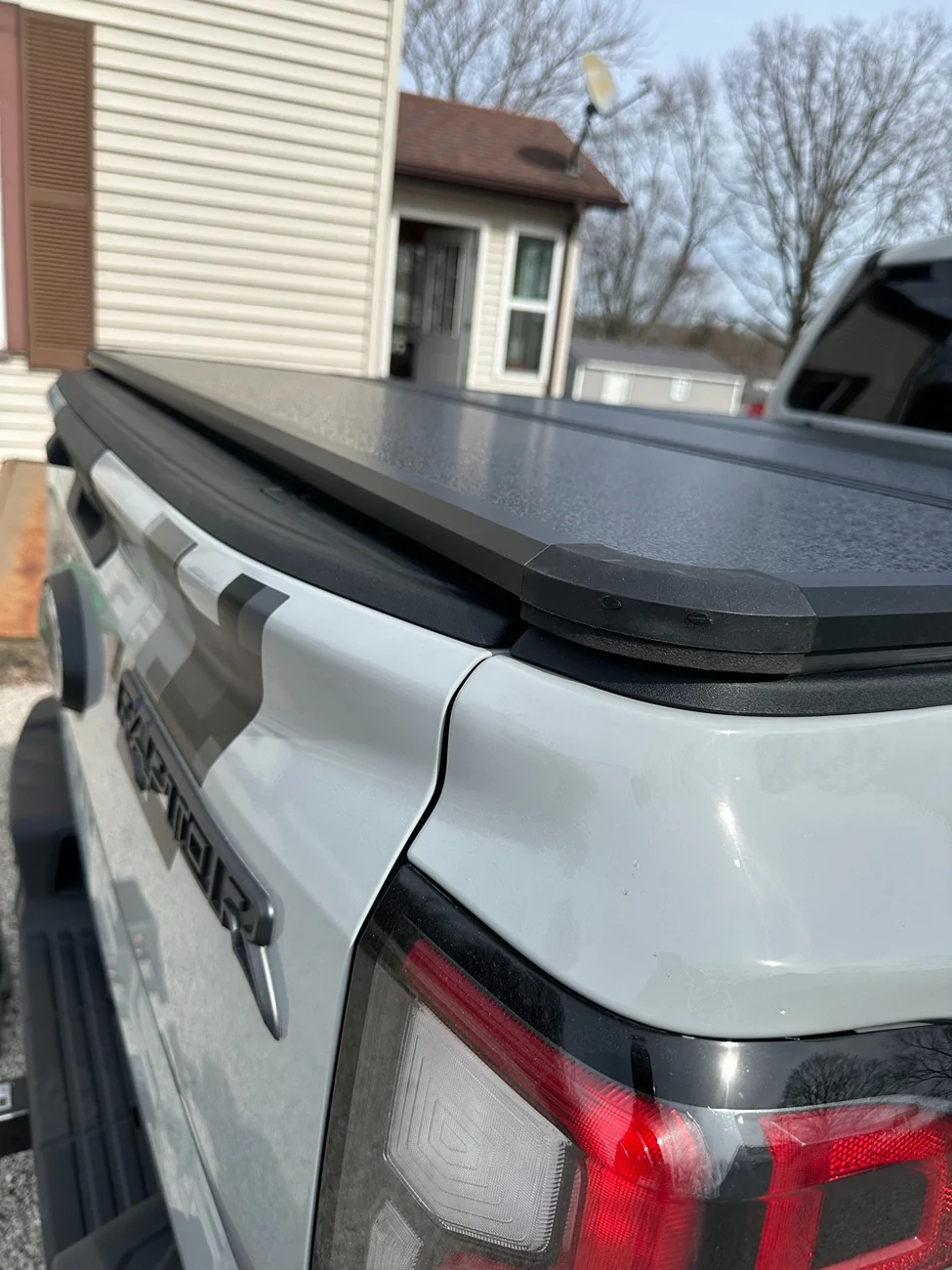

I bought a 2026 RR a few weeks ago. Love it other than the 17 mpg and too many things are on the screen. Needs more regular button controls. I bought a hard tonneau off amazon that said it fit 19-21 rangers and doesn't fit the 26 RR. I bought it anyway since the price was so low and it fits and seals but doesn't follow the the corners on the fender perfect but it's good enough for me.
for $230 delivered it works.
