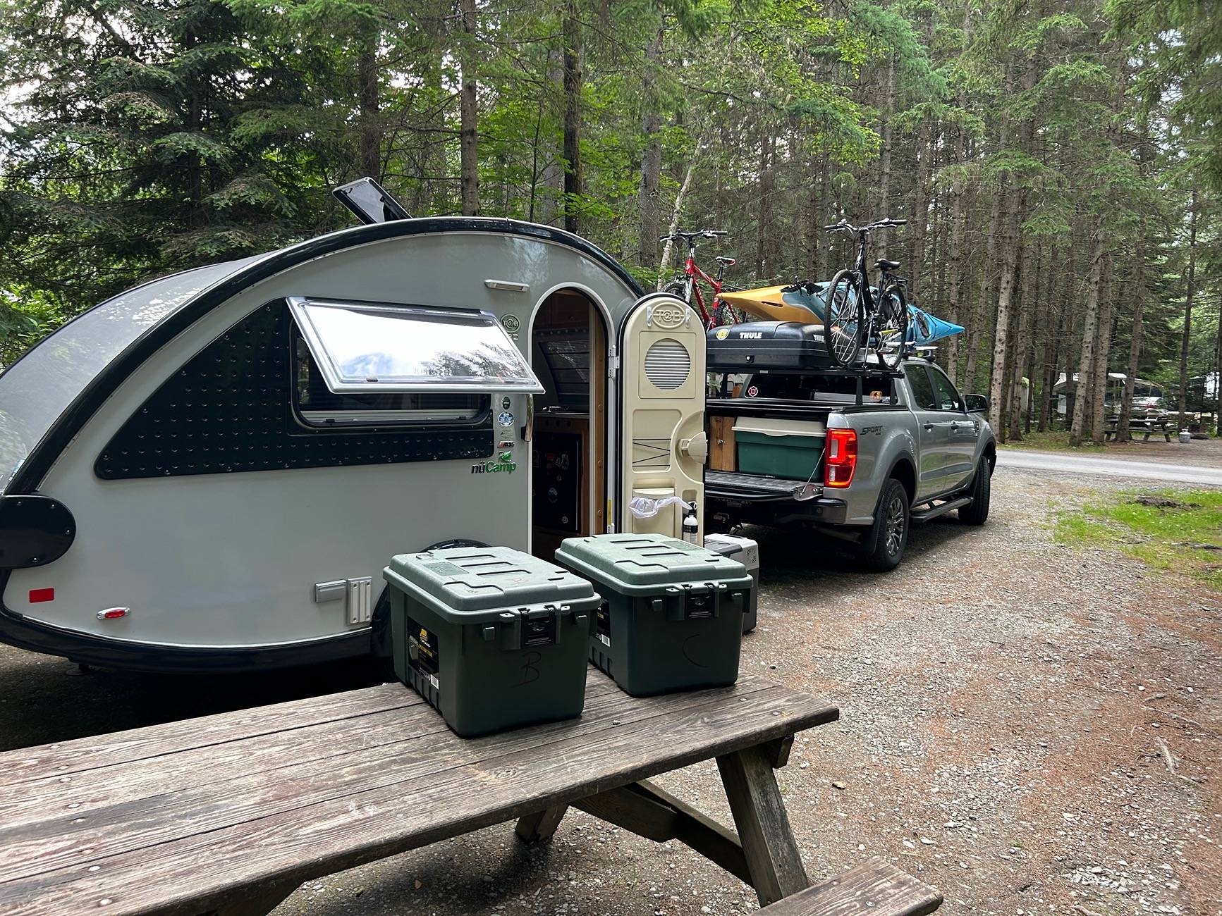

Just did a two week camping trip and travelled 3200kms/2000m towing our Tab. Loaded the truck up with toys and gear. The trailer weighs in around 2000lbs. Towed in the Laurentian Mountains of Quebec from Nova Scotia through New Brunswick. Gas mileage was between 14-18 mpg depending on speed. The old roads take longer but mileage and scenery is way better.
