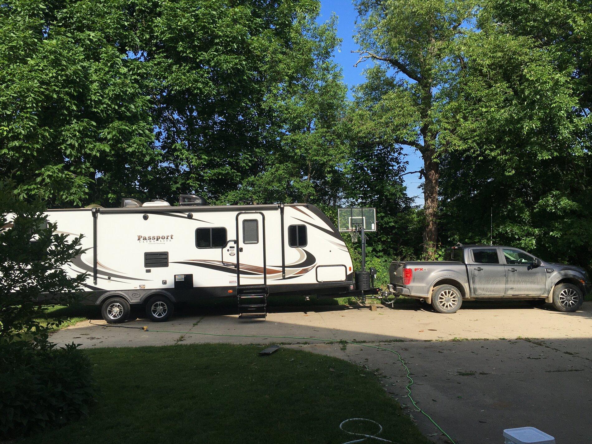

I don't have my camper pics handy, but I tow what I consider to be the absolute maximum camper size (too big by many other accounts).
It however is only 5350 dry, adding about another thousand or so lbs of gear and liquids (just in case), and the ranger is still able to tow it properly.
HOWEVER: It's not something for someone with little to no towing experience. It takes concentration, and self control. Slamming the brakes is likely to get you in a bind when towing something like this, so you have to know how to react, and how much to react to each driving hazard.
My pictures are in the other Travel Trailer thread, it will be the second one, not the Forrest River 207BH I had originally.
The model I have now is a Passport Ultra lite 2920BH Grand Touring. You can google it, and I'll see if I can link to the other thread where I have pictures of it hooked to the truck for scale.
EDIT: Best I could do in short order.
https://www.ranger5g.com/forum/threads/what-are-you-guys-towing.1768/post-141758
Edit2: found it

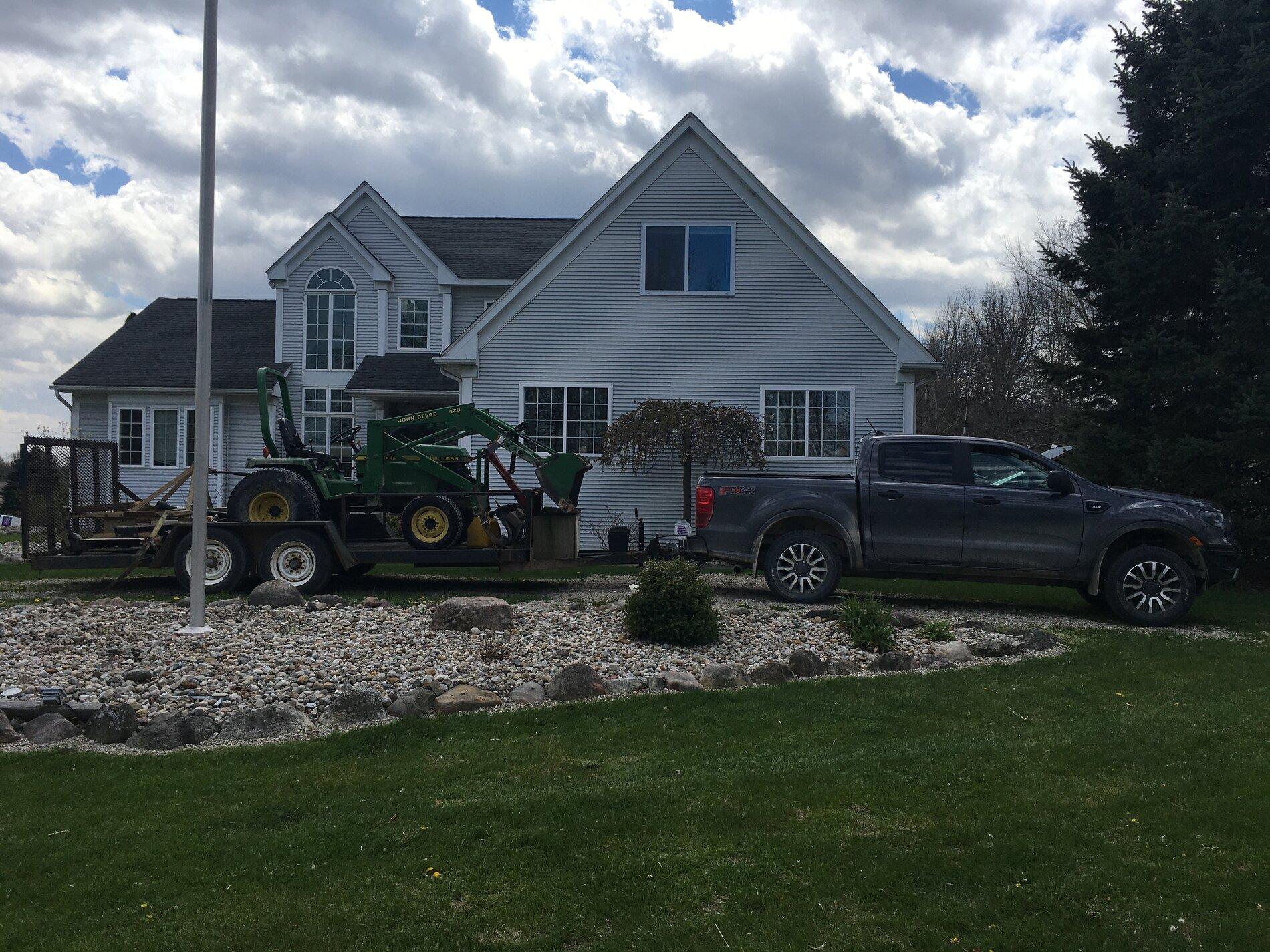

Thanks for the info. At 5350, your dry weight is probably just under what the OP’s fully loaded weight would be. Very impressive that the Ranger is handling your trailer. I still ask the question – what is the realistic max travel trailer weight that the Ranger can safely pull?
A 5500# block of concrete on a 2000# trailer would be fine with brakes as long as the tongue weight was within spec.
This was a little squirrely, but still totally doable.(pic)
a travel trailer is a totally different beast than a huge block of concrete or a tractor on a trailer. It could be half as heavy as mine but it’s all about the dimensions, and how the weight is distributed.

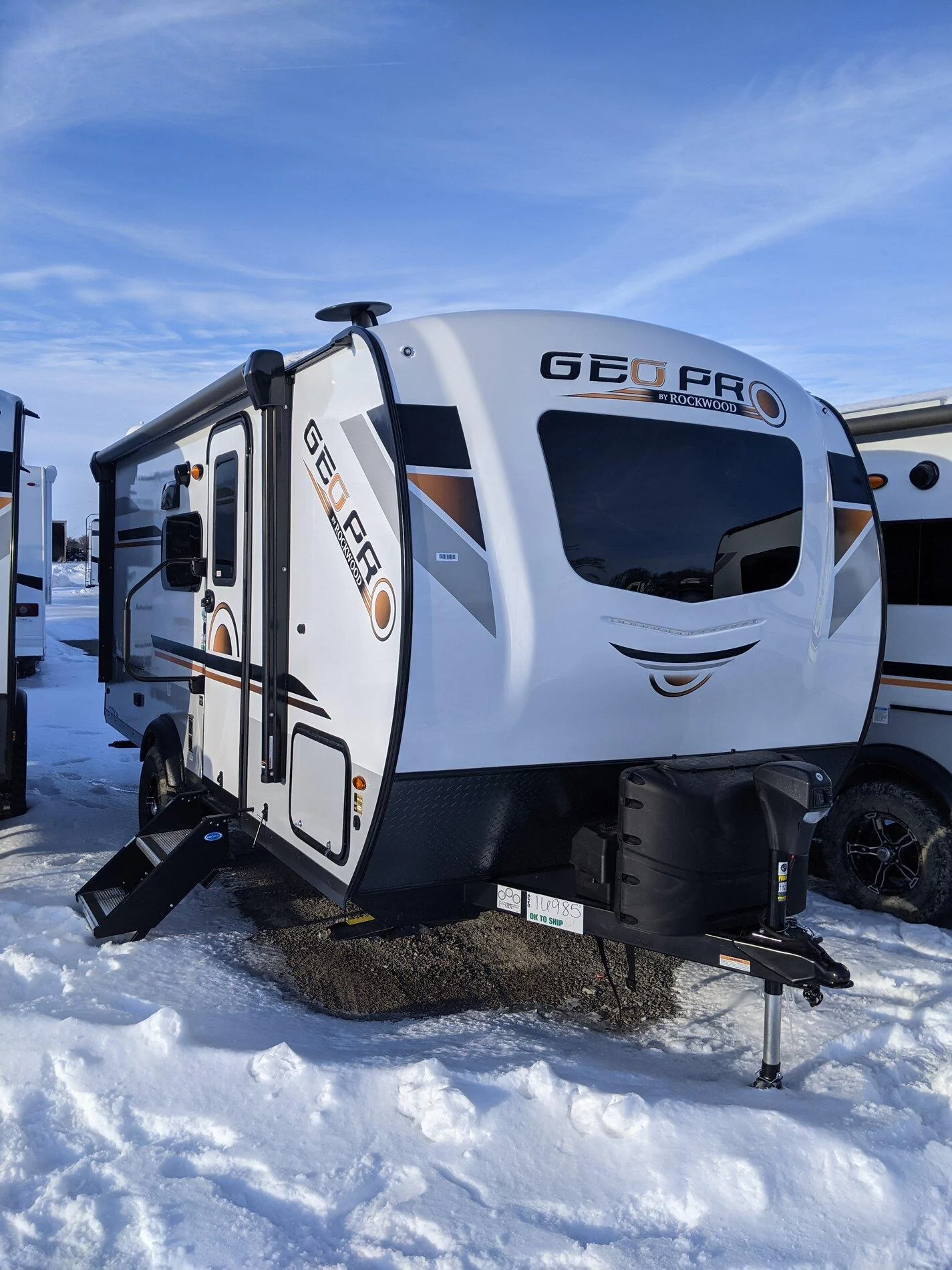

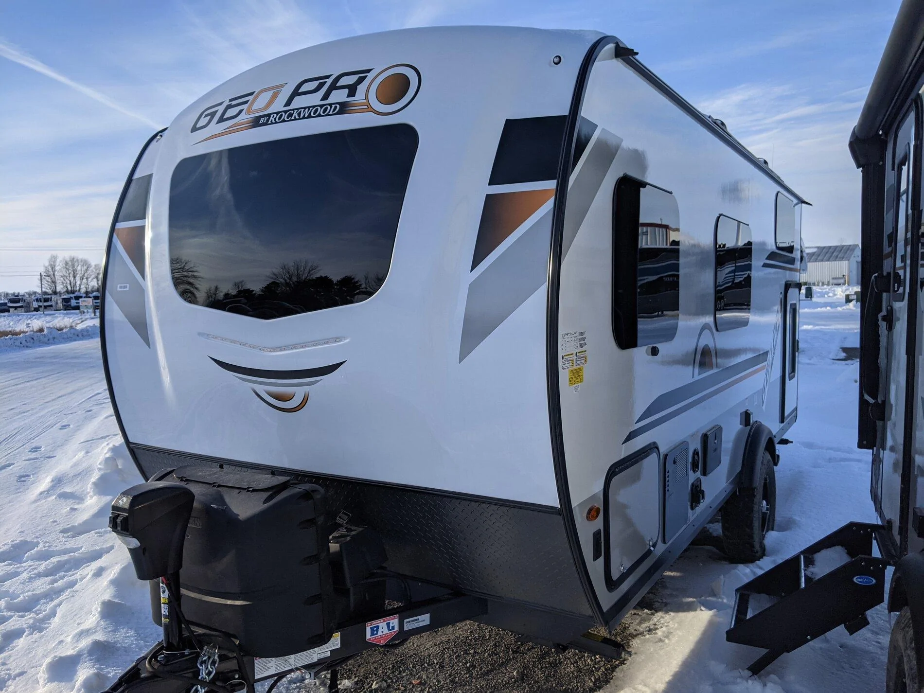

Just wanted to report back here and thank everyone for there input, opinion, and experience.
I decided to err to the side of caution, to allow for more 'ceiling' to our load, and try to optimize our rig for the rigors of a long haul vacation (and beyond) by down stepping to the TT I just purchased this afternoon. It took some convincing to do that and accepting what I ought over what I (we) wanted but in the end I am feeling SO much more comfortable with this decision.
I landed on the GeoPro 19BH trailer which I was aware of for some time and in my area I have just not seen on a lot available for purchase until I made a call this morning on a whim and found this unit which was purchased but never claimed by the purchaser so they put it back up for sale.
Very excited to pick her up in the coming weeks and start prepping for the springtime excursions!
So where did this land me juxtaposed against the above:
The Camper is an GeoPro 19BH
  • 20’ 2” Bumper to Hitch
  • Dry Weight is listed at 3220 lbs
  • Hitch Weight is listed at 411 lbs
  • GVWR is 4311 lbs
  • I (over) estimated 750 lbs of ’STUFF’
  • *Single Axel
So with those parameters assumed / figured and using the Towing Capacity Worksheet I am coming out to:
  • 95% of allowable Trailer GVWR *I anticipate sharing the load more with vehicle with reduced size unit to open headroom on this*
  • 76.82% of allowable GCVWR
  • 551 lbs UNDER Tow Vehicle GVWR (Truck + Cargo + Passengers + Hitch Weigh
