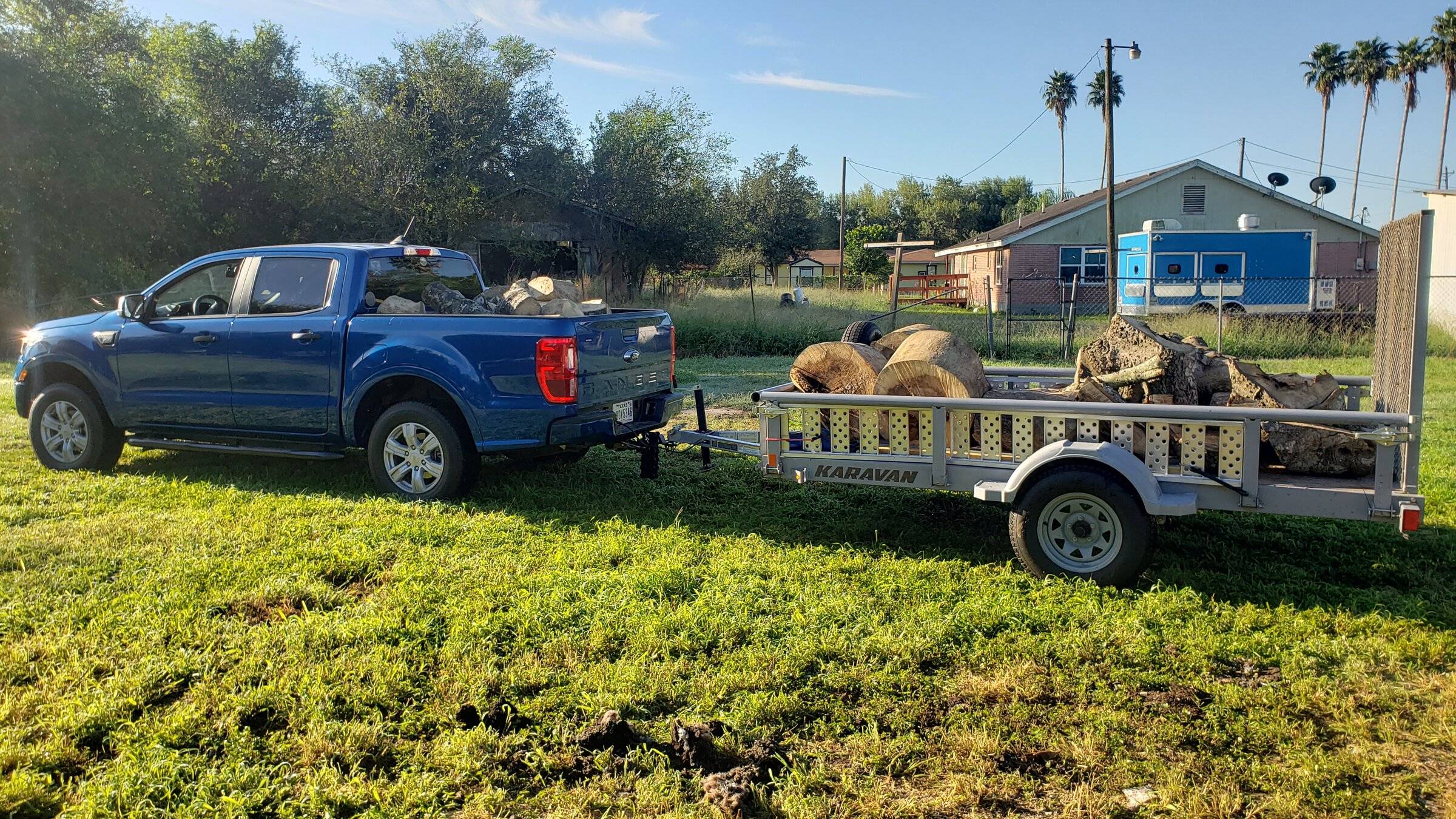

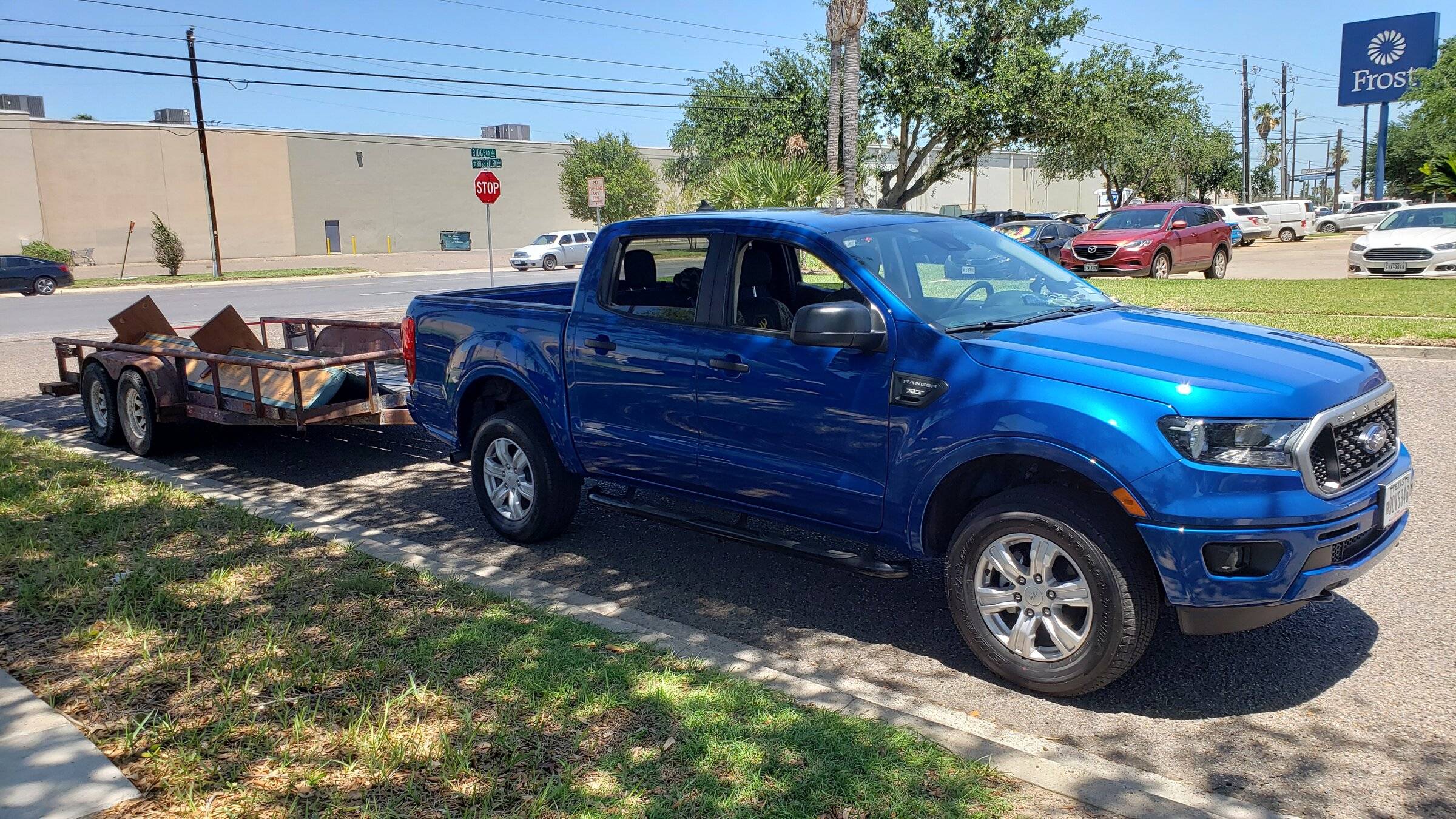

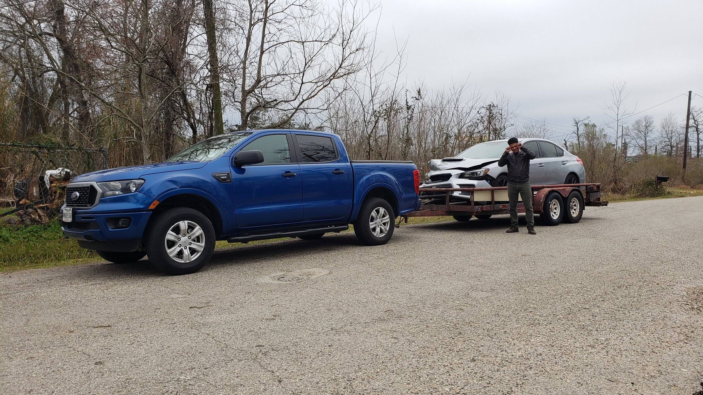

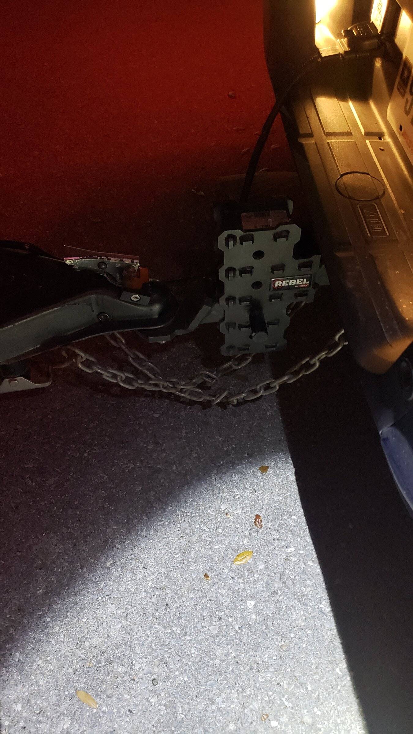

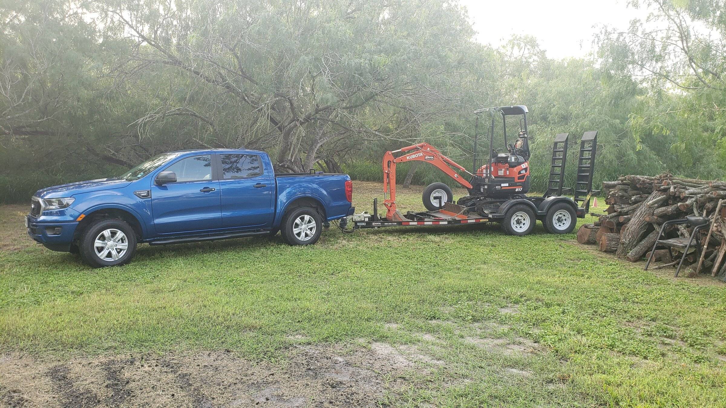

Ok, well first off opinions are like ass holes. Everybody has one.
So this is what i use, and my experience.
Gen y rebel hitch. Rated 7k
Ball, rated 7,500
Both pins, rated at 10k
I never use a weight distribution hitch. Dont need em. Not towing a travel trailer.
Use a curt echo for trailer brakes on the tow with a car. Traveled 700 miles with it just fine. Other than that, other heavy trailers i have used have had surge brakes. If you are towing a uhaul trailer you will be just fine. Just watch the tongue weight. Those trailers are hard to properly balance the load
The pic of the trailer and tractor, i was using the wrong hitch. No rise.
Gen y really is the best hitch to use. IMO. You can get a 10k, a little more expensive. But 7k has worked just fine for me.
The car tow, i had about 5500 on trailer, and about 1500 lbs payload.
To include occupants, tongue weight, tools luggage and all.
Towed awesome.
No wdh. Never used one. Not towing a tt.
Be safe, tow with proper equipment, and tow smart.

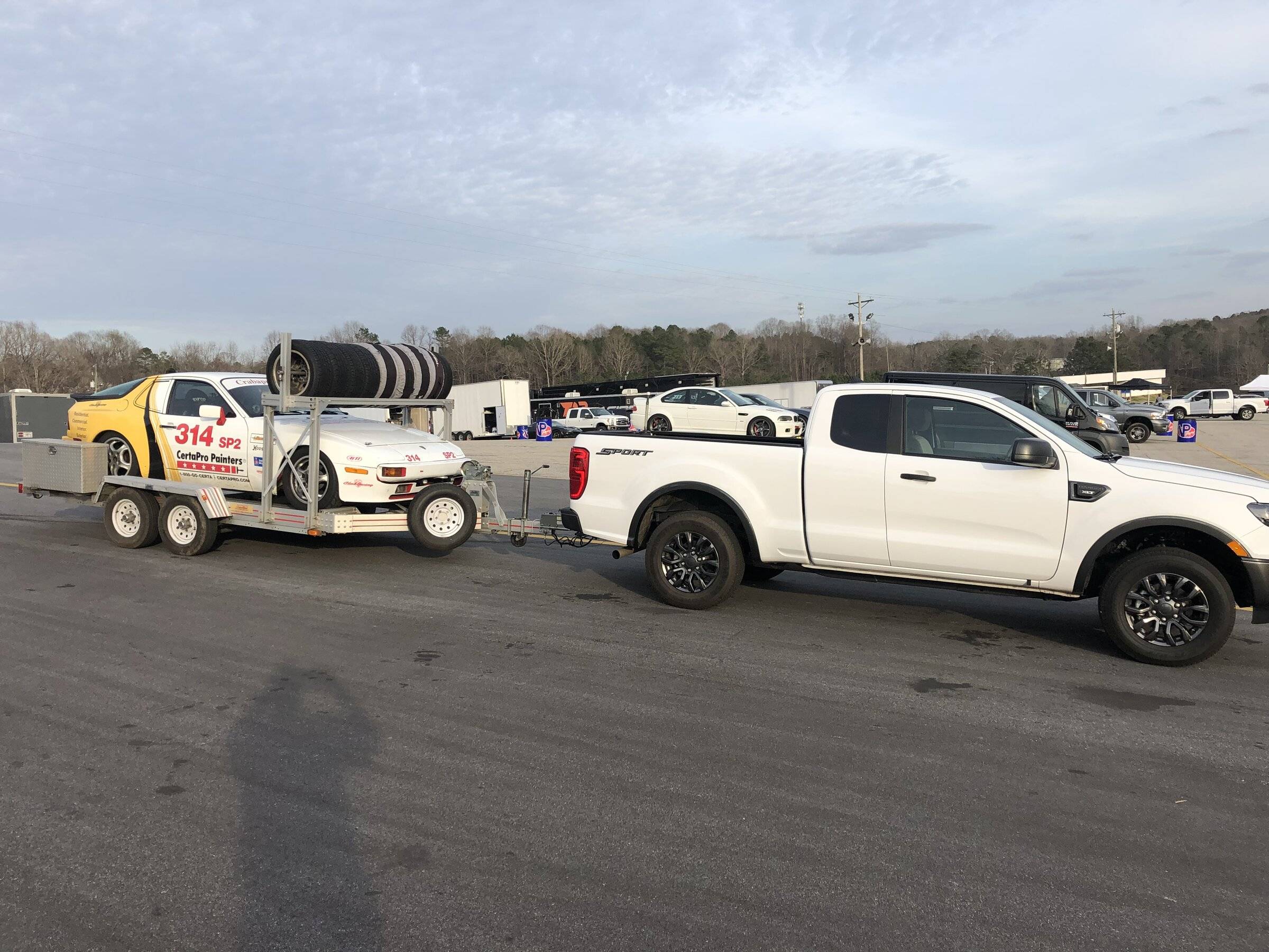

Alpharettark
Sep 29, 2020
52
Atlanta, GA
2020 Ranger XLT, 2018 Focus ST, 1999 Boxster, 1987 944 Racecar
Make the investment ($100 or so - a minimal spend in race car terms) for trailer tongue scale. You should be able to move car even a little fore or aft on trailer and eliminate need for WDH. As pictured I have about 400 lbs on the hitch. I’ve hauled this pig thousands of miles (been racing 15+ years this is 4th tow vehicle)and really like simplicity of surge brakes on the Trailex. Hitch is 2” drop.
