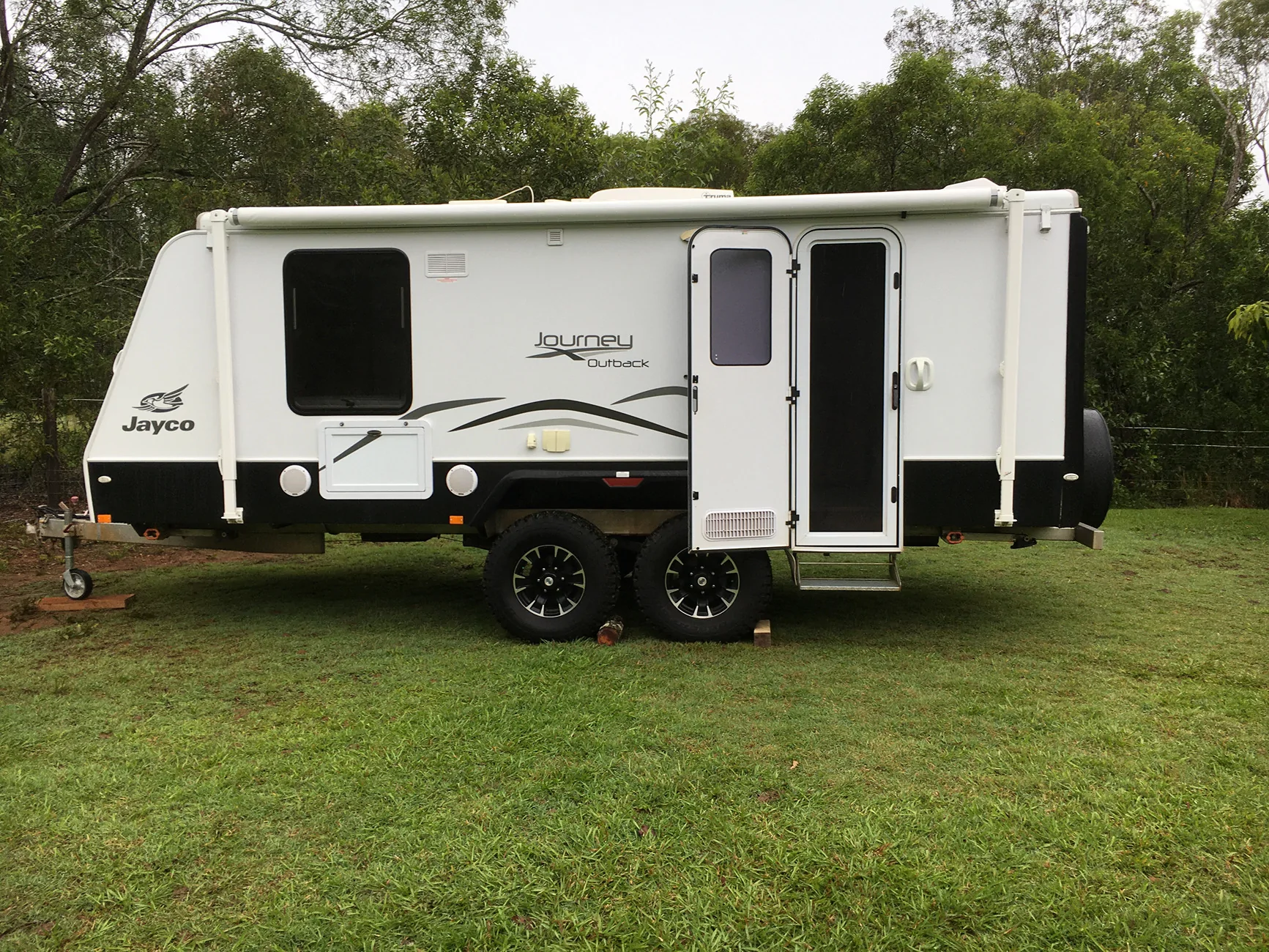

Well I tow this with my 3.2 diesel Ranger, it is about 22' overall and weighs 2400 Kg (about 5,300 Lb) when filled to capacity. When I first bought it I did wonder if a WDH would be needed but I thought I would try it first, and found that it tows fine without it.
And I've towed it literally everywhere, like to Melbourne from here (which for you would be like towing from Canada to Florida) out to Birdsville in the central desert (including 250 km of dirt track) and many shorter local trip to the beaches just over the NSW border.
It has independent trailing arm suspension and electric brakes and just tracks along fine.
