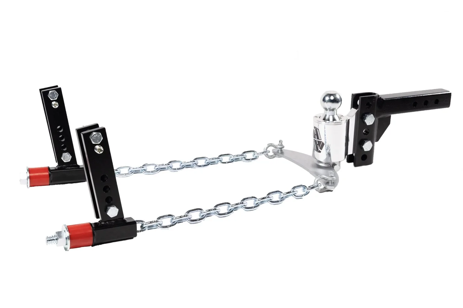

I’m using the Andersen WDH set up. Also serves as a anti sway. Light weight and easy setup. We pull around 6000 and are very pleased with the setup.
That is an interesting looking setup, never seen this style before.

I've seen those for sale over here but never seen one in use. Most people tend to favour the spring bar ones instead.
I’ve used both styles and prefer the Andersen. Light weight, easy setup and no need for an extra anti sway device.

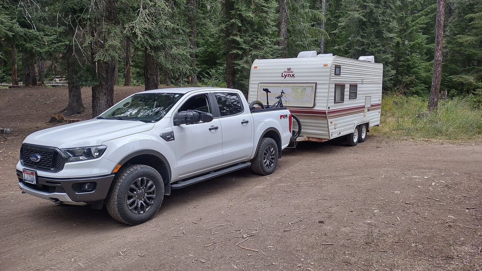

I tow an '88 Prowler Lynx we've had for 22 years. Had two different F250 diesels I towed it with before my Ranger. The trailer came with a WDH when we bought it from some friends of my parents. I always used it unless we were just moving the trailer a short distance real quick. The GVWR on the trailer is 4100 pounds. I have the chain style bars Grumpaw mentioned and it is easy to hook up. One little trick is once the coupler is locked in raise the tongue slightly with the jack to make camming up the chains easier. Works really well if the ground isn't very flat and you have no other option. Since our Rangers weigh only 4400 lbs give or take, the WDH helps going down the highway or interstate. Peace of mind if nothing else. Mine all loaded with the WDH sits level. We camp off grid so we carry fresh water in the trailer tank and it sits forward so there's that weight. We spread everything else out pretty well. I carry a small generator, saw, gas, tools, etc. in the bed so there's that weight, too. We towed twice this summer for the first time (bought the Ranger last August) over one pass and a couple more substantial hills with no issues. I got 13.5 mpg last trip and it would have been much better if we lived in Nebraska or something! :crackup: Your RV dealer should be able to get you set up with exactly what you need to be safe and enjoy towing. For its size the Ranger is a tow beast! I am impressed. I installed the Tekonsha Prodigy P3 brake controller. It is amazing! Best unit I have used to date. If the Curt doesn't work to your liking get the P3. Easy to install. There's plenty of info here on the wiring part. Likely you can see which colors are attached with your current set up to the left of the brake pedal and just match those wires up.
