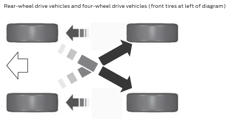

this. from the OM.
When doing a rotation, you should use this pattern (though at Discount Tire, we did fronts straight back and crossed the rears up) because it puts each tire on each spot on the vehicle. This will give you the best wear over time.
This advice, of course, is dependent on non-directional tires. That changes what you can do.

Cross rotation keeps the tires quieter over time as it helps even out the wear better. That being said, most dealer shops just do the front to back hack. Tires get noisier sooner and it is easier to upsell a new set of tires and alignment to the consumer before the tires have reached the end of life.

It's time to rotate my tires again. I do it every 5k miles in hopes of maybe getting a tire replacement under warranty because my Wildpeaks are no way gonna last the 55k miles they promise. But regardless if I get it or not I'll rotate them.
I took it to the dealer last time just cause it's a pita to do in the garage and to have it in the system, but I assumed they would do a cross pattern as that is what multiple websites recommend for 4wd trucks! They didn't, they did a straight front to back (I marked the tires). So I'm not even going to bother with them anymore, I will just put my own rotation into Fordpass so it's sorta official. So I was thinking I would do straight side-to-side rotation this time because of dealer not going cross and also because I do one-wheel peals everywhere and the pass tire wears down more. What rotation pattern does everyone like for the 4wd Ranger?
this. from the OM.
That's what I do, rears straight to front, cross fronts to rear.
My home method with two small floor jacks. It reads harder than it is:
1. Jack up left side of truck. LR to LF, LF to LR. Only snug 3 lugs on the LR because it's coming back off. Lower left side of truck.
2. Jack up right side of truck. RR to FR. Do not bolt RF to RR. Lower jack on RF.
3. Move jack from RF to LR, raise LR and remove wheel. This is why you don't put all the lugs on and fully tighten.
4. Put RF on LR. Put LF (that was briefly on LR) on RR.
Of course while I have the individual tires off I scrub the back side of the wheels with wheel cleaner, the back side of the tires with Bleche-Wite, and Armor All after that. I've never been accused of having a dirty vehicle.
