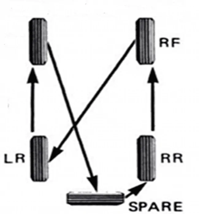

My truck is coming up on 7k miles and I'm thinking its about time to do a tire rotation. I have an FX4 with a spare that I'm thinking of rotating in. I know I'm going to need to buy a matching wheel since the spare has a steel wheel. I found them for sale at this site below for $150, unless someone can suggest a better source. Also I'll need a TPMS which the site sells for $45.
https://www.autorimshop.com/ford-ranger-2019-17-oem-wheel-rim-192185.html
Will most dealers or discount tire do 5 tire rotations? Do they charge more to do them? Anyone have any thoughts or experiences they want to share?
This is the rotation I use on my Jeep. 5 tire rotation will give you 20% more tire life on a full set.

Fronts to back and backs to front...same rotation...left to left and right to right.
Spare is a spare.
as long as you aren't running directional tires (wouldn't be on a truck) you should move them from left to right too. Fronts come straight back, rears cross to opposite front. Running the tires in both directions will help them wear more evenly. If the Driver Rear is position 1 and we move clockwise, (Driver Front is 2, Passenger Front is 3, and Passenger Rear is 4) you should move 2 to 1, 1 to 3, 3 to 4, and 4 to 2.
