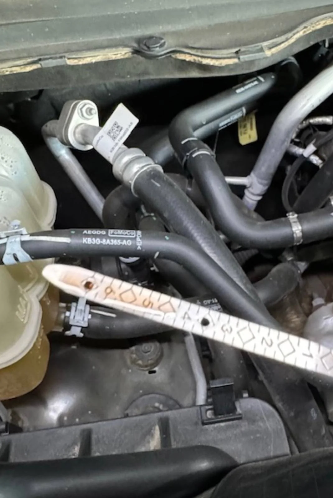

Misspoke here...meant the first mark at the TIp...guess that would 5?
My bad :(
Technically the 1st mark on the stick would be 6.5. If so then you may be on the low end depending on trans temp .

Again that was the fluid level after she spit some out on the road...between the dot and the 6....truck sitting level and running.
