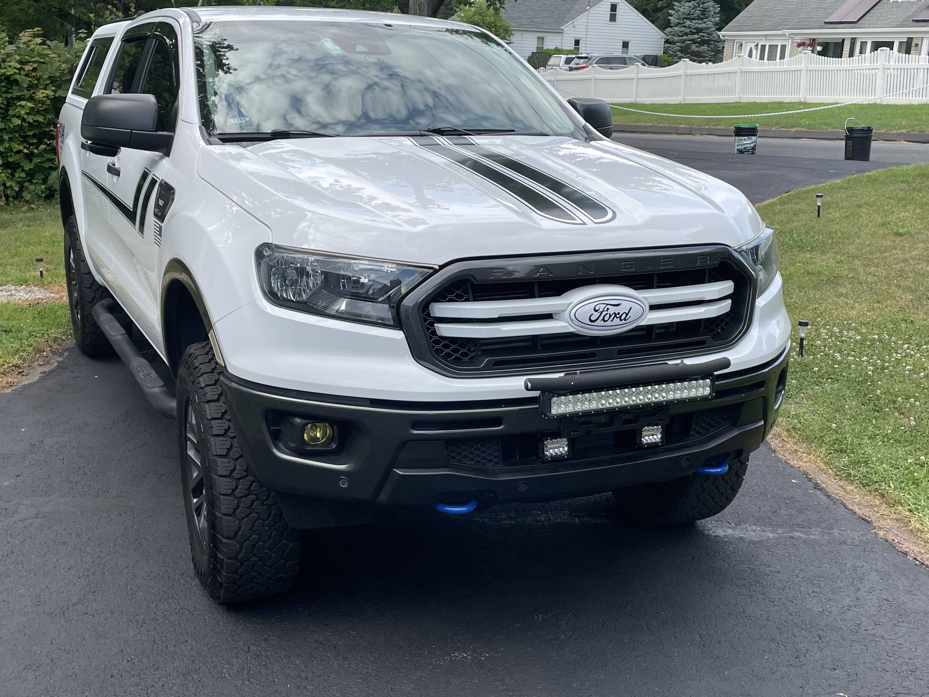

I did just that on my 2019 Screw. Tremor wheels with 265/70/17 tires. I have the RC leveling kit. The tires poke out probably a half inch or so with the Tremor wheels. They have a +42 offset versus the +55 offset on the stock sport wheels. No rubbing or other issues except a little loss on the MPG’s because of the heavier tires.
