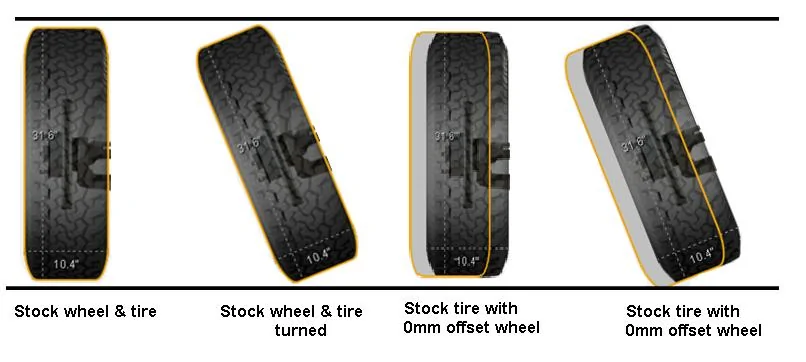

Our stock offset is +55mm, as you get lower, you push the tires out. When you get to zero or to a negative offset, you’re pushing them out even further. Offset is the distance from center of wheel to hub interface - someone call me out if that’s not exactly right.
Zero offset means the hub interface is at the centre of the rim. Negative means it is closer to the inside lip.
As you lower offset, you increase backspacing. At the same time, you push your wheels toward the wheel well and crash bars - it’s a delicate balance.
Lines represent crash bars - shaded tires show pushed out position.
Here’s a helpful link - scroll down to read the definitions...

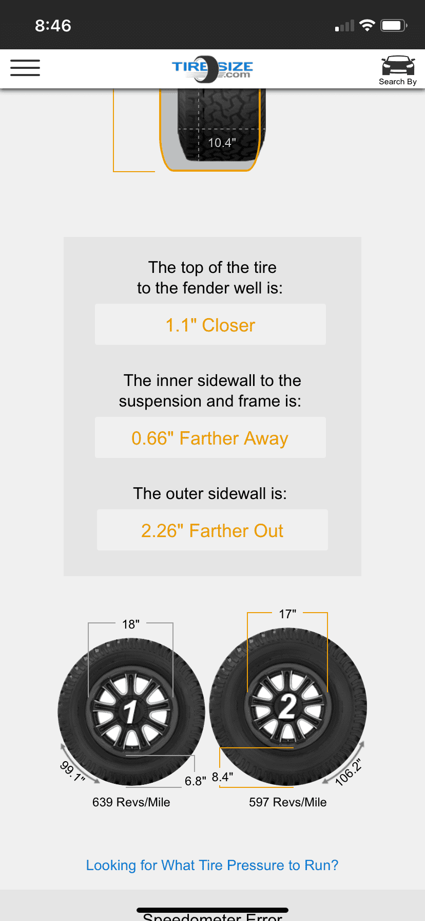

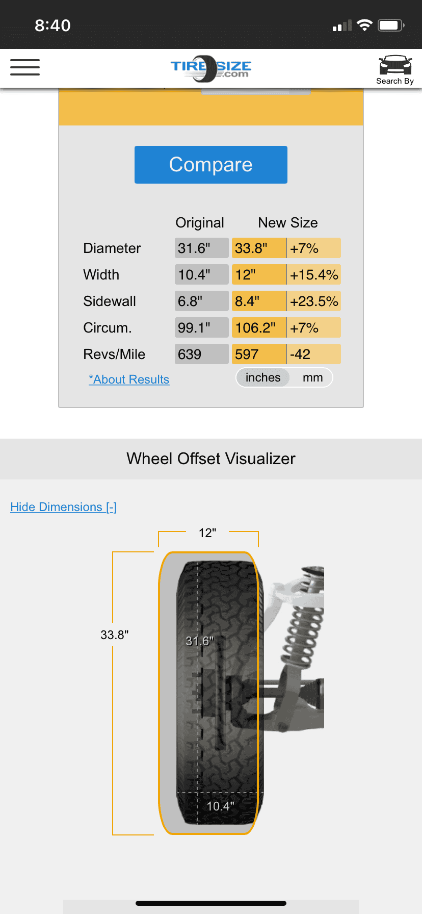

Rather this makes me feel better

Whoops did 265/65R18 on the original size. Either way I think itll be good. Ill double check tonight and eyeball it a bit.
