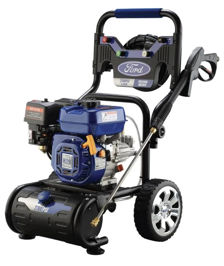

Brandon,
Forget about that washer Dave sent you a link for, this is what you need, right here…..
FFPW!

Brandon,
FFPW!
Man that sucker is SWEEET. But if I get that, I’m quitting my current job and starting an auto detail business. XD too bad all nice things cost a lot hahah.
