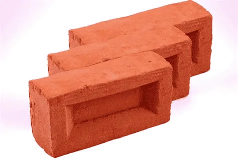

Well, if you want CHEAP, you COULD use the cube to handle your paint swirls and to smooth out the surface (somewhat)... has built in compound cavity to evenly distribute whatever... :giggle:

Did you just post me one of those Tik Tok Supreme Clay Bricks that kids these days waste money on? Haha doesn't look very... malleable to me... :thumbsdown:

I think it's regular NC fired clay brick myself, but...
