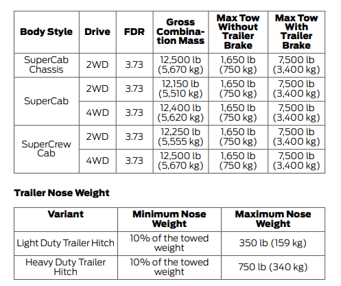

Is the 7500 pounds with the trailer towing package only? What will it haul if you just use the bumper attached to the frame as is? 2022 Ranger.

I think some of the confusion is from the phrasing of my question, my apologies . I have no doubt the engineers at Ford came to this number carefully and backed my models and testing.
Everyone's comments have been very helpful and I think the best way to approach a final number is to work backwards.
1. Take the truck max payload capacity and see how much that will cut into your max tongue weight.
Example: Payload capacity - (human weight + things in the cab you need + things you plan to put in the bed) = available tongue weight. Take this or 750lbs, which ever is smaller.
2. Take the the tongue weight from step 1 and compare that to the trailers GVWR. My reading says 10% to 15% of the trailer should be on the tongue so (tongue weight / .10) > trailer GVWR.
Example Say I only have 600lbs of payload remaining, staying on the safe side 15% on tongue means I should keep GVWR under 600 / .15 = 4000lbs
Assuming the trailer GVWR isn't exceeded, this setup should be safe to drive.
According to my owners manual, the bumper hitch limit is 3,500 lbs with trailer brakes. Otherwise 1,650lbs.
7,500lbs is unlocked with the heavier trailer hitch + trailer brakes.
Using the bumper/ball, your limited to a 3500 lb trailer weight and a 350 lb tongue weight.
However, the bumper on the Ranger's is so high as to make towing with a bumper ball unsuitable.
Your trailers tongue will be elevated to the point that you will be transferring a lot of weight toward the rear of whatever trailer/load your towing. Additionally, there is no way add a drop type hitch to the bumper to lower the ball.
You need a receiver type hitch platform, and even then you will probably need a drop hitch shank to lower the ball to the correct height, depending on your trailer.
