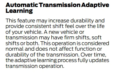

As others have mentioned, this happening when it's new (or after an extended power off situation likely), is normal. It's the "adaptive learning" that our transmissions go through to determine the best shifting points/etc based on specific hardware and driving patterns. You can find it on page 154 of your manual.
2020-06-01 18_08_08-2019-Ford-Ranger-Owners-Manual-version-3_om_EN-US_04_2019.pdf - Foxit Rea...webp
