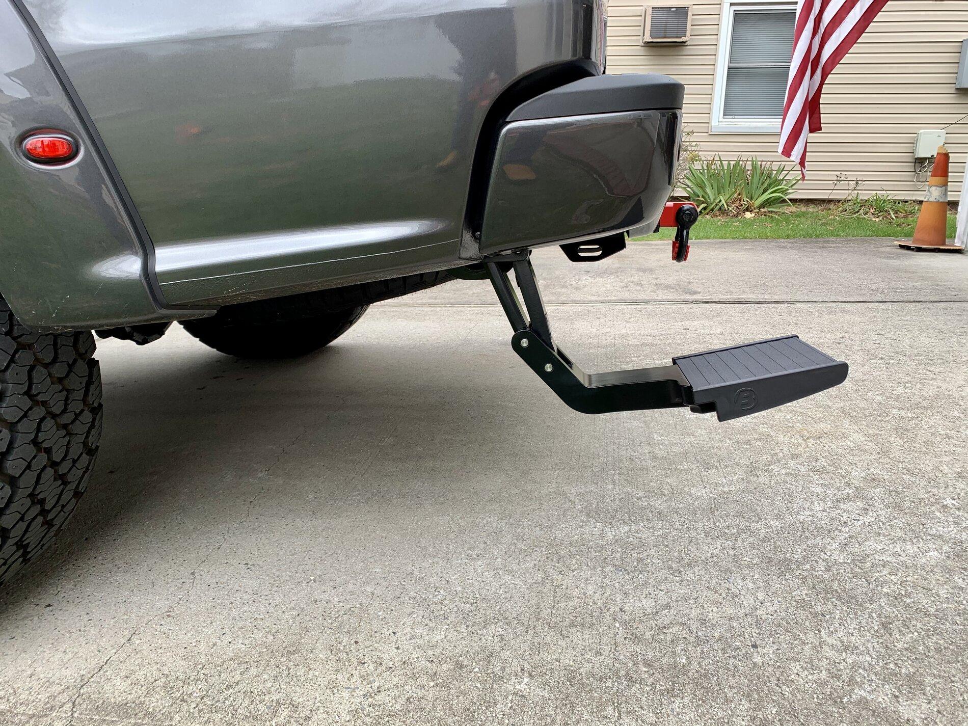

I received the TrekStep for Father's Day and just finished the install. With my basic tools, it took about 2 hours. It is not complicated, but the biggest PITA is getting the bed bolt back in. It would be much easier if the step frame had a hole to allow an extension to get through. I'm a pretty lean guy and there is not a lot of room to get an arm between the frame and the body. It is also kind of tough to see if you are laying on the ground like I was. I had to do a lot of it by feel followed up with a visual inspection.
If you have a wide frame for your 2" hitch and you want the step to be under the truck as far as possible, I recommend using both shims. Adding shims is very early in the install and, because of the design, they are difficult to add or remove once the step frame is mounted. I used one shim, but it was not enough to keep the step from hitting the hitch frame, so I moved the step out a little more than I originally wanted to. I will probably go back and add the second shim at some point for the aesthetics of having the step be less visable, but the step works great and the 10 y.o. daughter and 5' tall wife both like it.

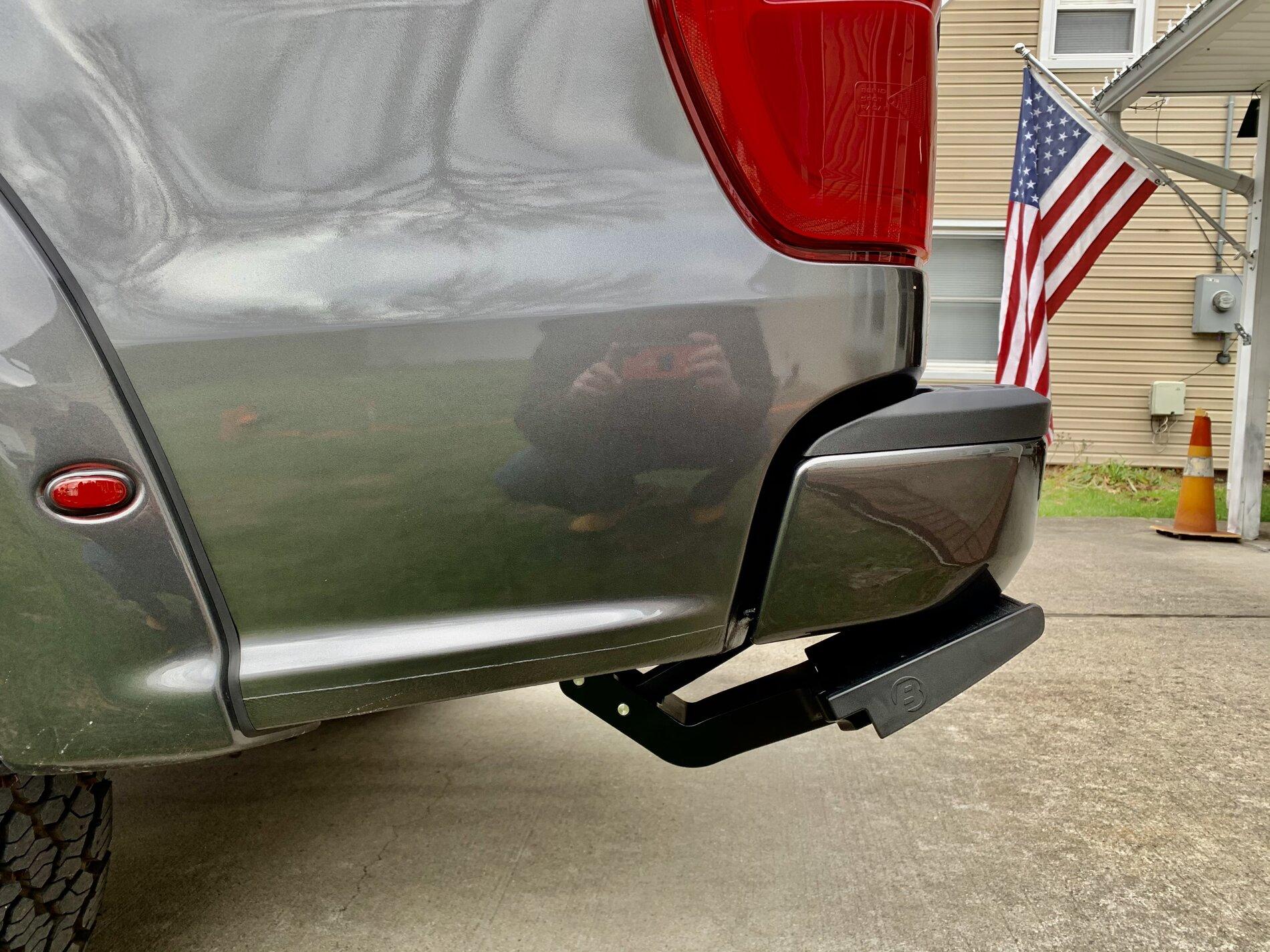

I guess third time‘s the charm.
My first order from Amazon, turned out to be for an F150,
The 2nd was missing the upper bracket.
So Third...I ordered straight from Bestop. :like:

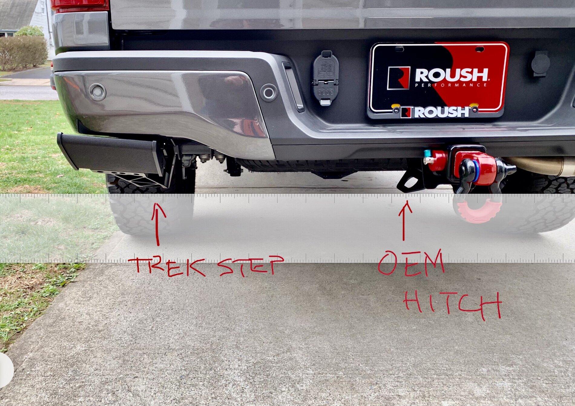

Anyway,...It works well and holds my weight (198-200lbs).
Just a smidgen higher when folded, compared to the bottom center of
the oem hitch.
One thing worth mentioning is that, I had to remove one of my Baja S2 aux rear light because it would interfere with the step. ( not a big deal atm )
