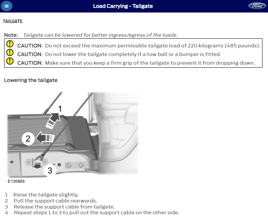

I would not use tail gate ramps, I think they said the max weight on the tailgate is about 485lb and I'm not sure that is to all be on the top (back while open) of the tailgate. I would suggest removing the tailgate and getting ramps directly into the bed, if the bed is not long enough with the tailgate removed... get a trailer.
Good point! Never even crossed my mind.
