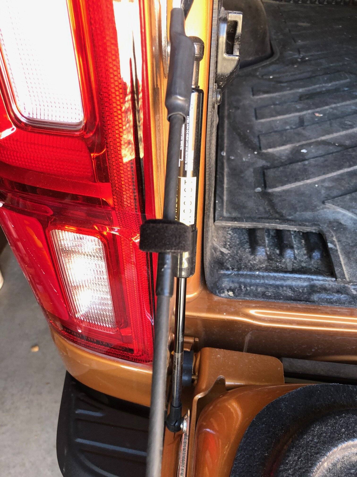

Are you supposed to remove the driver side steel braided cable support after install of damper? I noticed mine is getting beat up after damper install.

No but you can put a velcro wrap around the cable so it doesn't get pinched between the damper and the side. I added a piece of black electrical tape to the bottom to keep it from sliding down.
Velcro:Tailgate Strap.jpg
