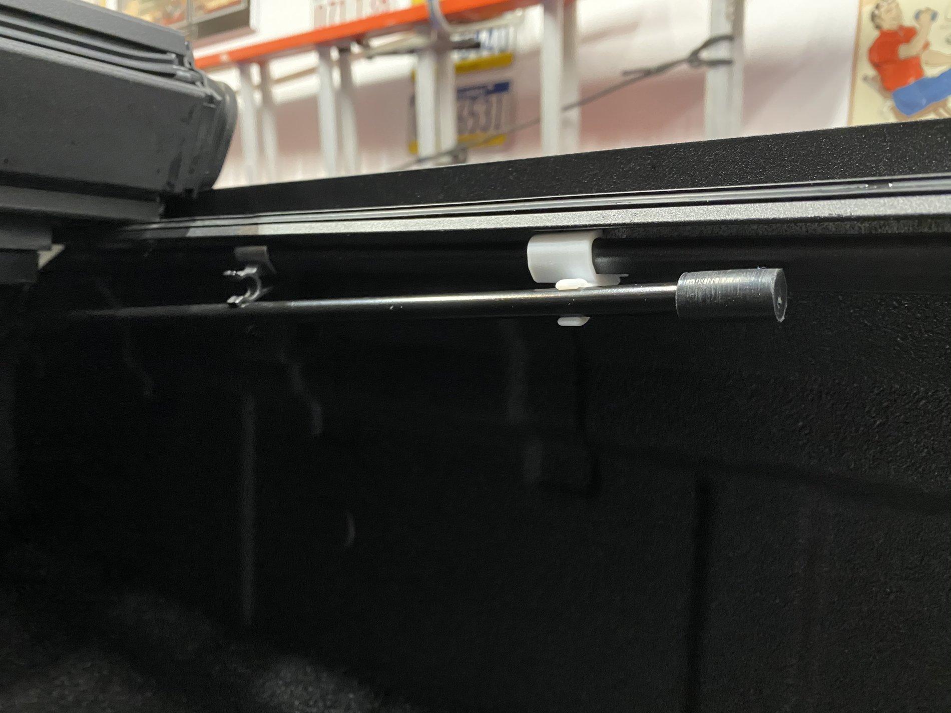

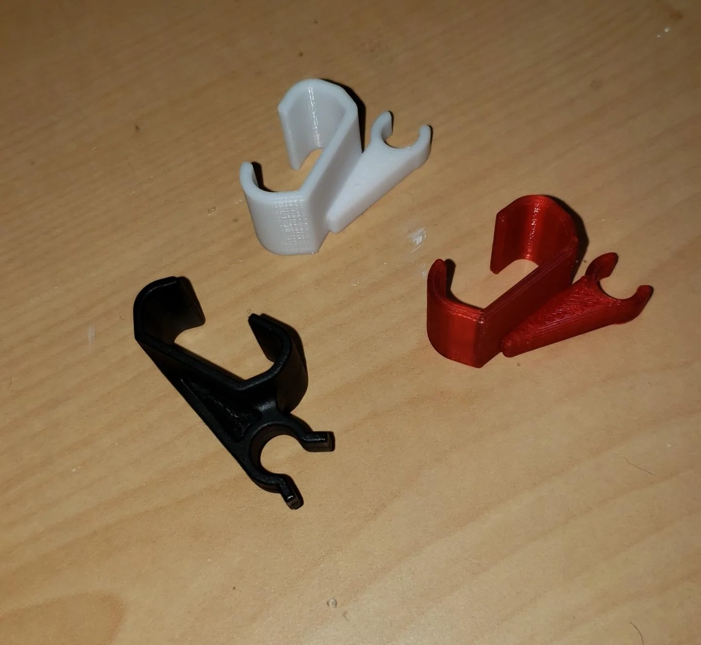

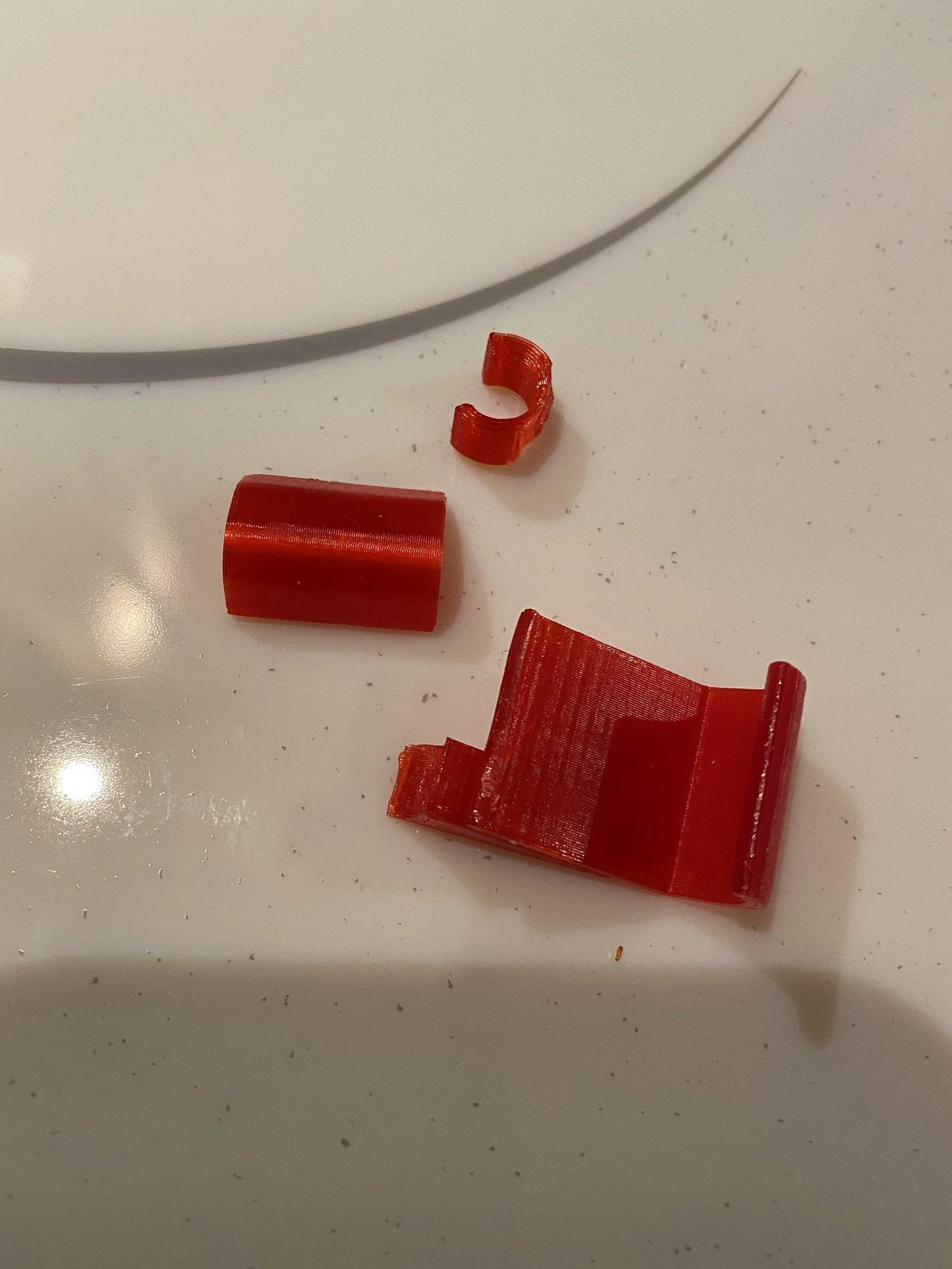

Version one in test. The red one we tested first broke but is a different material. We snapped it on no problem but snapping the rod in caused it to break in three pieces. He made the rail part that is a little thicker. He has to offset the clip part due to the way the 3D printers need to print.
The white I believe is PETG. Will get details when we know it holds up. Weather-wise in Pennsylvania is perfect for testing temperature fluctuations. We’ve gone from 60’s to 20’s in short order in the last few weeks.
One thing he took notice of is that the prop rod comes up at an angle. He’s going to try a V2 that builds the angle in.
