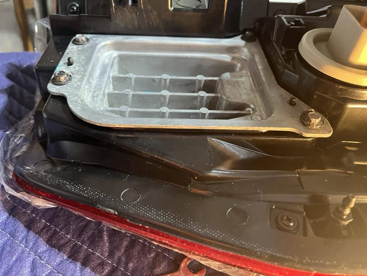

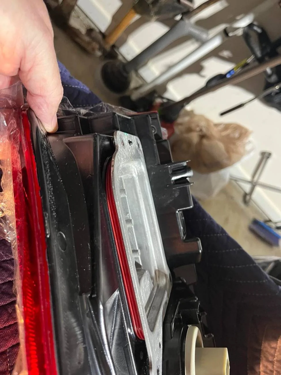

About five years ago, I came home from a grocery run and discovered a hole in my left taillight about the size of a nickel. When I learned that replacement from Ford was $1200, I slapped a piece of red duct tape over it and forgot about it. Last week, I chanced to look and found an aftermarket taillight that would accept the BLIS module for about $145. I just put it in, following the directions from the OP. 8mm socket to take out the screws holding the light, had little trouble with the red connector lock - pressed the release with the end of a knife and it slid right out, the connector itself had to be pried off. The four plastic-coated bolts came out with a 9/32" socket -no 6mm socket - and lifted the T-20 Torx bit for the two screws holding the BLIS module, then got the sub-connector off much more easily than the main plug. Reversed the procedure and my first problem - minor but still a pain was fitting the the metal BLIS assembly back into the taillight. The LED guts on the left side of the taillight protruded and assembly refused to go in flush. Being fearful of breaking something, I tried to get the BLIS assembly out and it was now stuck. So I sprayed a little bit of silicone spray on the red weather strip and gently pressed until it dropped in place. I zipped the four bolts back in place to secure it before it changed it's mind, got it plugged in, but did not have the proper zip tie to keep the wire in place so shoved it out of the way with my knife as I pushed the taillight over the pins and into place, holding it as I ran the two 8mm bolts back in. Here is a link to where I got the taillight. https://www.ebay.com/itm/186246429354

Sounds like that aftermarket tail light was not accurately made. I broke a tail light lens on my 21 Lariat and I wound up buying a used OEM tail light. I don't think it took me more that 10-15 minutes to remove the broken light, swap the BLIS module over to the used one and put it back in the truck.
I worked in the auto parts retail business for a few years, and can attest that OEM is the best way to go - IF you can afford it. The specs are usually off a bit, but within SAE standards. It's on, it's getting sold later this year before the extended warranty runs out and the broken taillight was glaring.
