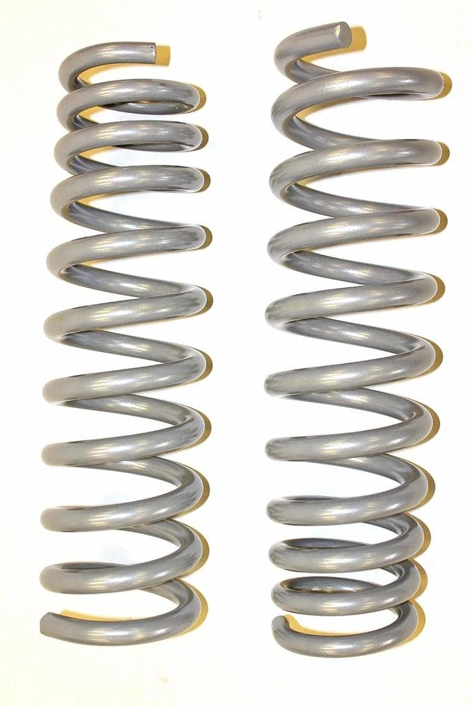

Starting with ride quality I would say its all relevant to the end user and their expectations. My opinion on the truck from the factory was that it was far to soft , so the addition of pre-load really helped with cornering and break dive as noted in other posts while also giving the truck a better stance / appearance. I will say as more of these units get on to the trucks in the upcoming weeks we will begin to get more feedback for the 5G community! As for the coil I have my engineer confirming this currently, from the looks of it, seems to be linear as typically a progressive spring has visual difference in spacing. Visual below of some of the progressive rates being used on the raptors.
d251f8_250dc7dd5d09488980a2537bc69d8515_002372a8-8dce-49f1-8d6d-abfe80cfcff4_1024x1024.webp

Thanks for the info! I'd like to hear some more feedback from others before I make my decision but I don't think it will be long before that happens like you mentioned.

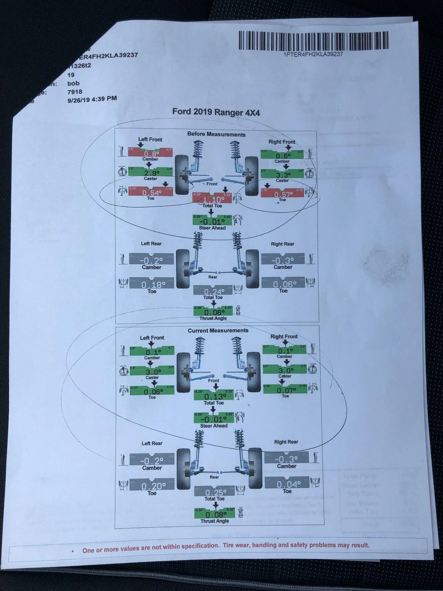

Got the truck aligned today. They were pleased with the SVC kit and the caster angle with it installed. I noticed a 2 mpg ish highway drop, we will see how the alignment changes that now.
