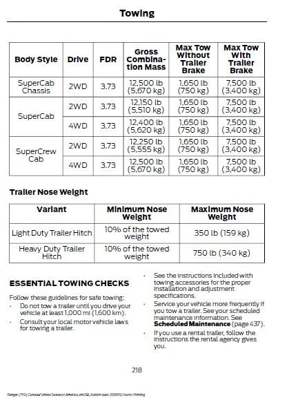

Explain to us how it's beefier?
Logic would dictate that the folks at Ford have a better Engineering staff than the folks at etrailer.com
Unless somebody at Ford has signed off on extra tongue weight, 750 lbs is the maximum tongue weight, based on the stock suspension of the truck.

Tongue weight rating involves the suspension and frame of the truck not just the hitch.
You are trying to justify to yourself pulling a trailer your truck was not designed to pull.

I'm assuming you measured them. Curious what the actual thicknesses are.
But nonetheless that really means nothing, if the 750 lb maximum rating is based on the truck frame and suspension.
Using your rational, if you built a strong enough hitch you could use the payload rating as the tongue weight... which we all know just isn't the case.
