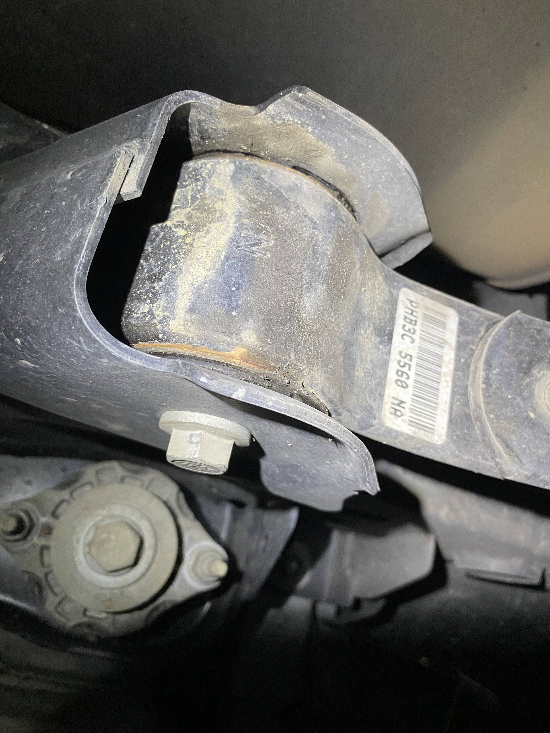

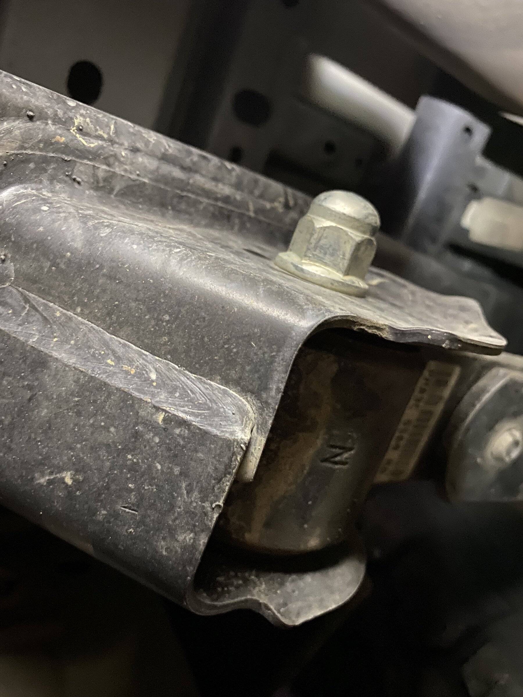

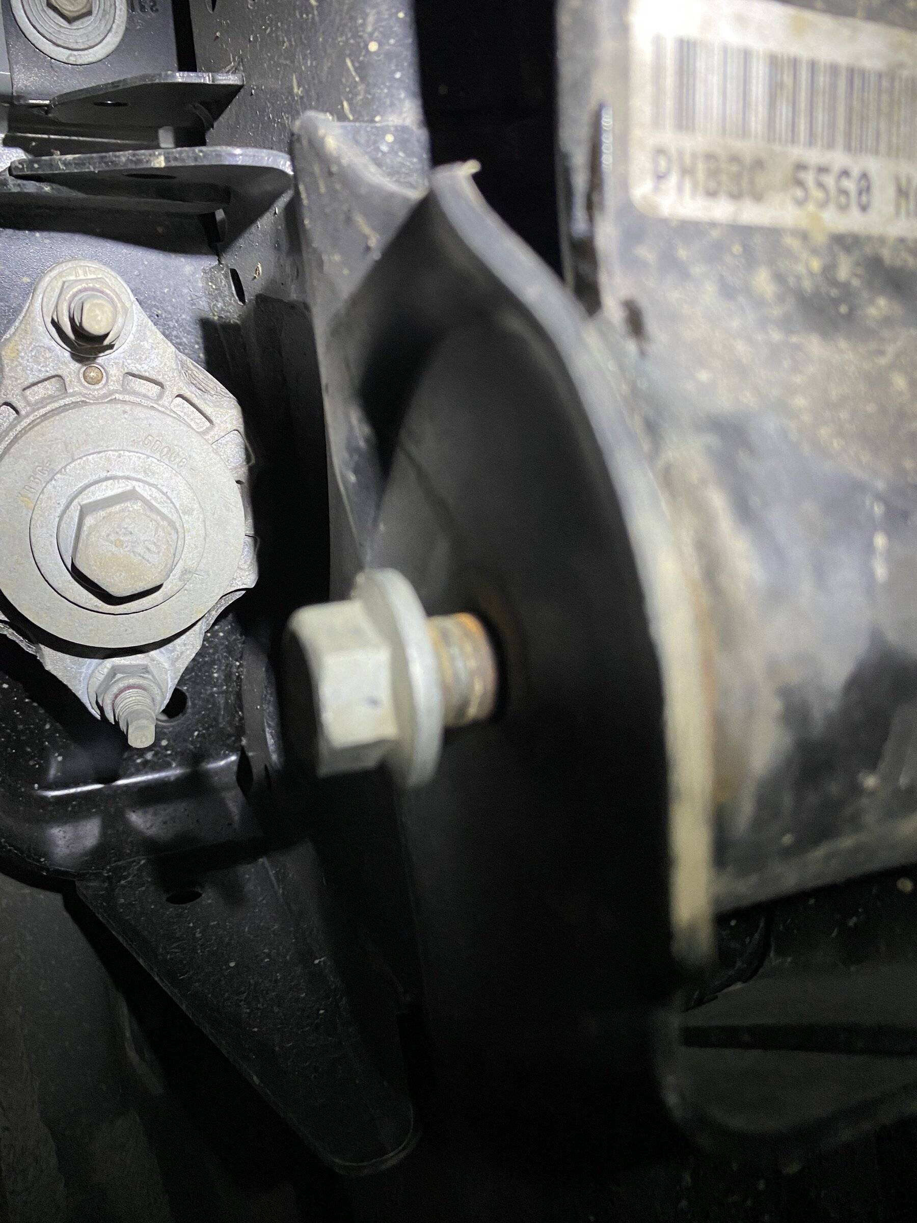

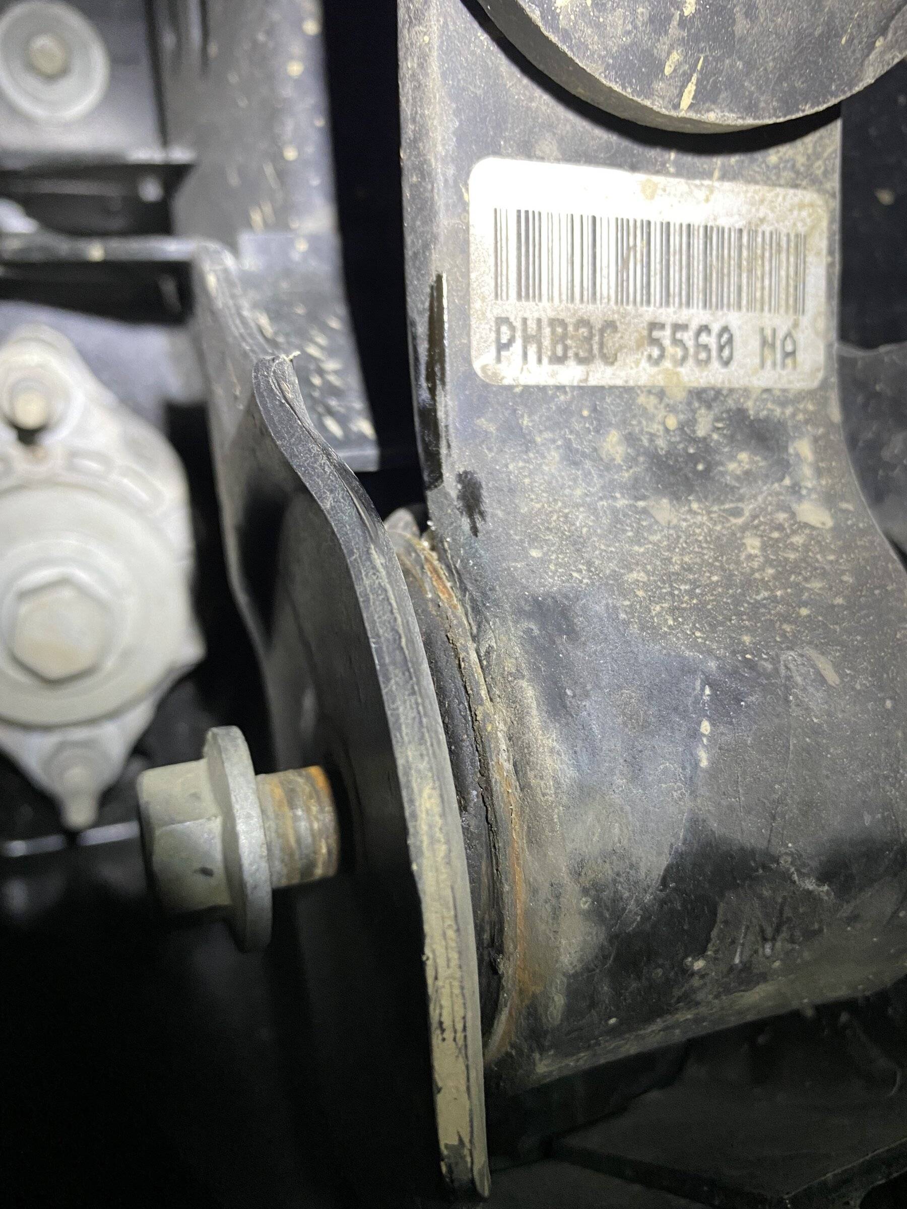

As someone who had this happen on my Tremor with just a few thousand miles on it, the fact that bolts were loose does not surprise me one bit.
Note that this is my driver side leaf spring bolt. The nut completely fell off. I had to tap the bolt back in and drive about 50 miles back to civilization, pulling over every few miles to check that the bolt hadn't backed out. I am running a nylon lock nut from an Ace Hardware with plans to go to dealership to have nut and bolt replaced (since bolt is torque to yield) as well as have them check every suspension bolt on the truck.
Definitely caused me to lose some confidence in the build of this truck..
Update to my situation (similar to OP): Nut, bolt and bushing replaced in rear leaf spring @ dealer. Dealer checked every suspension bolt via factory torque spec and everything else was correctly tightened. Spoke with tech and none of the bolts/nuts moved.
