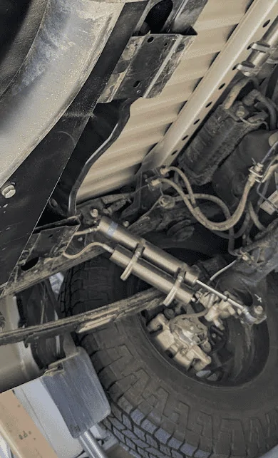

Aw man, you got 5160s. How do you like them?
They've been out of stock for ages and I got impatient, just grabbed 5100s.
Those are 7100's. I swapped the spherical bearings for rubber. The guts started with 360/80 shim stacks but they've been through a few revisions. I like them, lol.
I also liked 5100's on other vehicles. I doubt you are missing much.
