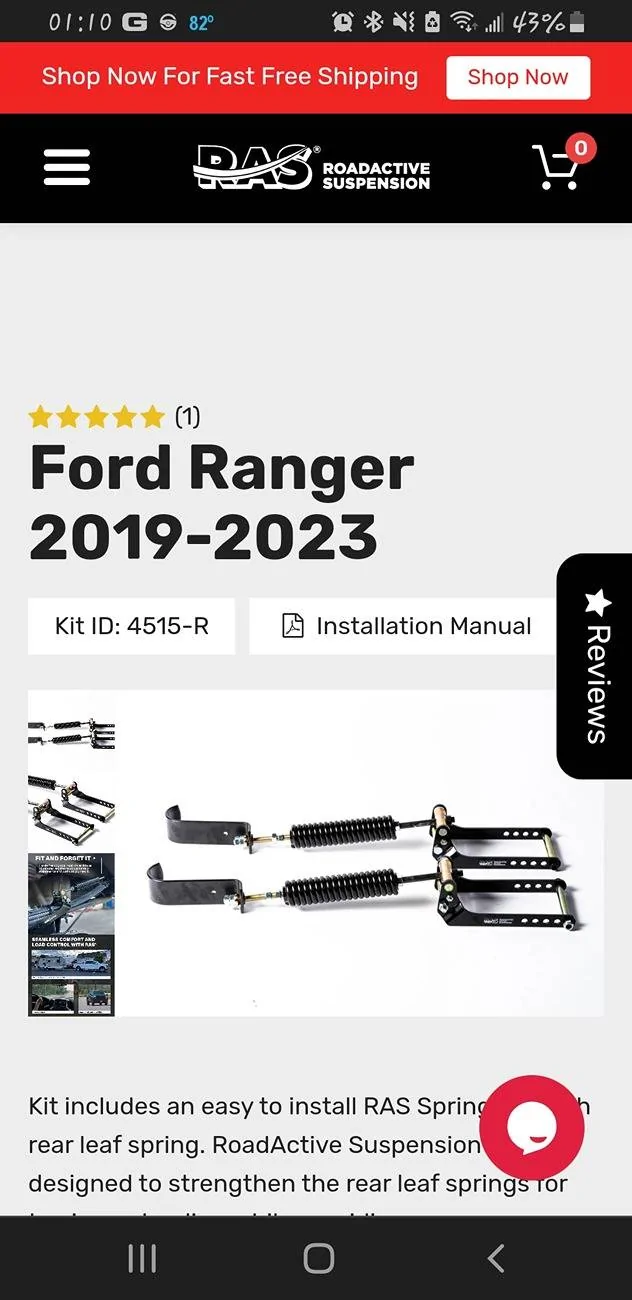

Air bags? Used them successfully on my 2005 F150 to level with trailer hauling. Allows adjustment, at least on the rear.

I'll second the Roadmaster Active Suspension set up. I believe I was the first to install a setup a few years ago to help with towing our travel trailer. The rig as loaded has around a 700 lb tongue weight, along with the stuff carried in the truck bed.
After using for several years, I wouldn't be without it.
The RAS system acts like an air bag set up, a sway bar, a traction bar, and a track bar all in one. You can set up the springs to compensate for heavier loads. And, the system costs less than just the sway bar by itself, and also less than an air bag system.
But it is a passive system meaning when running empty/solo it still gives a good ride...not harsh at all. Start loading the truck up and you will notice there is no sag to the rear...the systems springs compensate for added weight. There is a bit of "squat" until the springs in the system start to compensate for the added weight.....same as adding more air to an airbag system, but it is done automatically.
Along with a good set of shocks, and you probably won't notice the weight being carried.
Also, consider a pair of Sumo Blue Bump Stops.....much much better than the OE bump stops. Prevents the "jarring" when the frame contacts the bump stops.

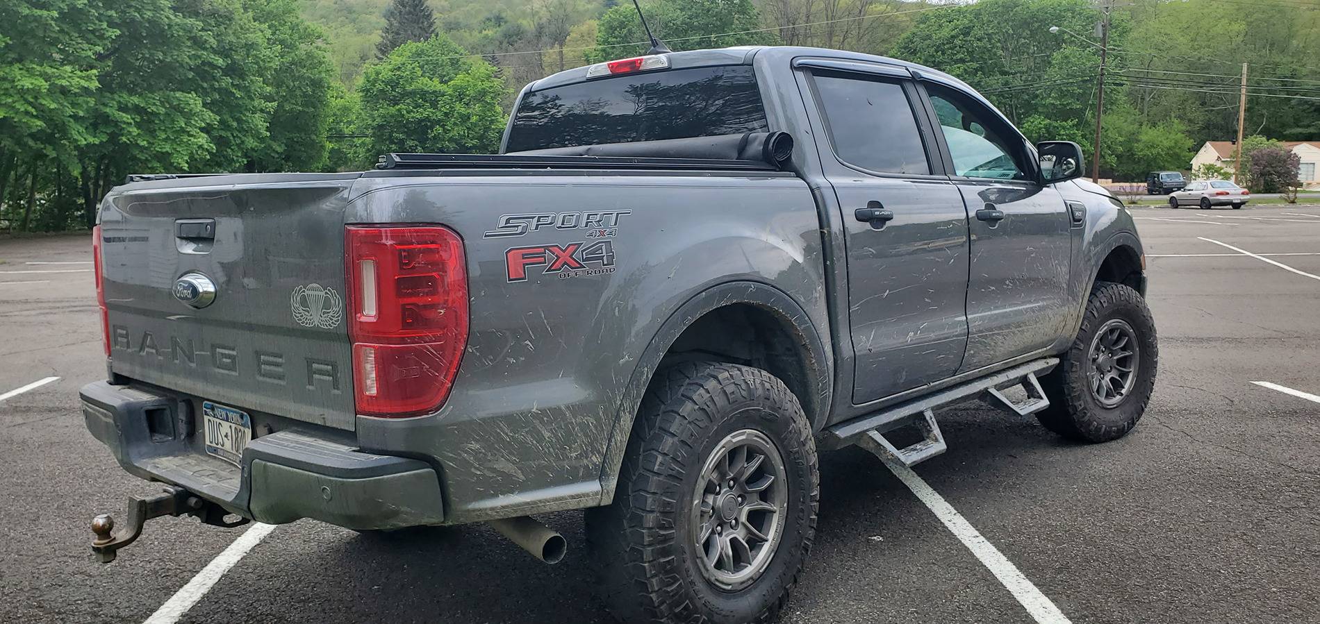

I have Rough Country all around, (the one everyone laughs about) I use it daily for heavy loads, I have had 1100lbs In the Bed and didnt notice, and it did not squat!, without a load I dont think its rough and the only one that bitches is my 80 year old mother, I keep telling her buy me a Caddy or next time call UBER!
