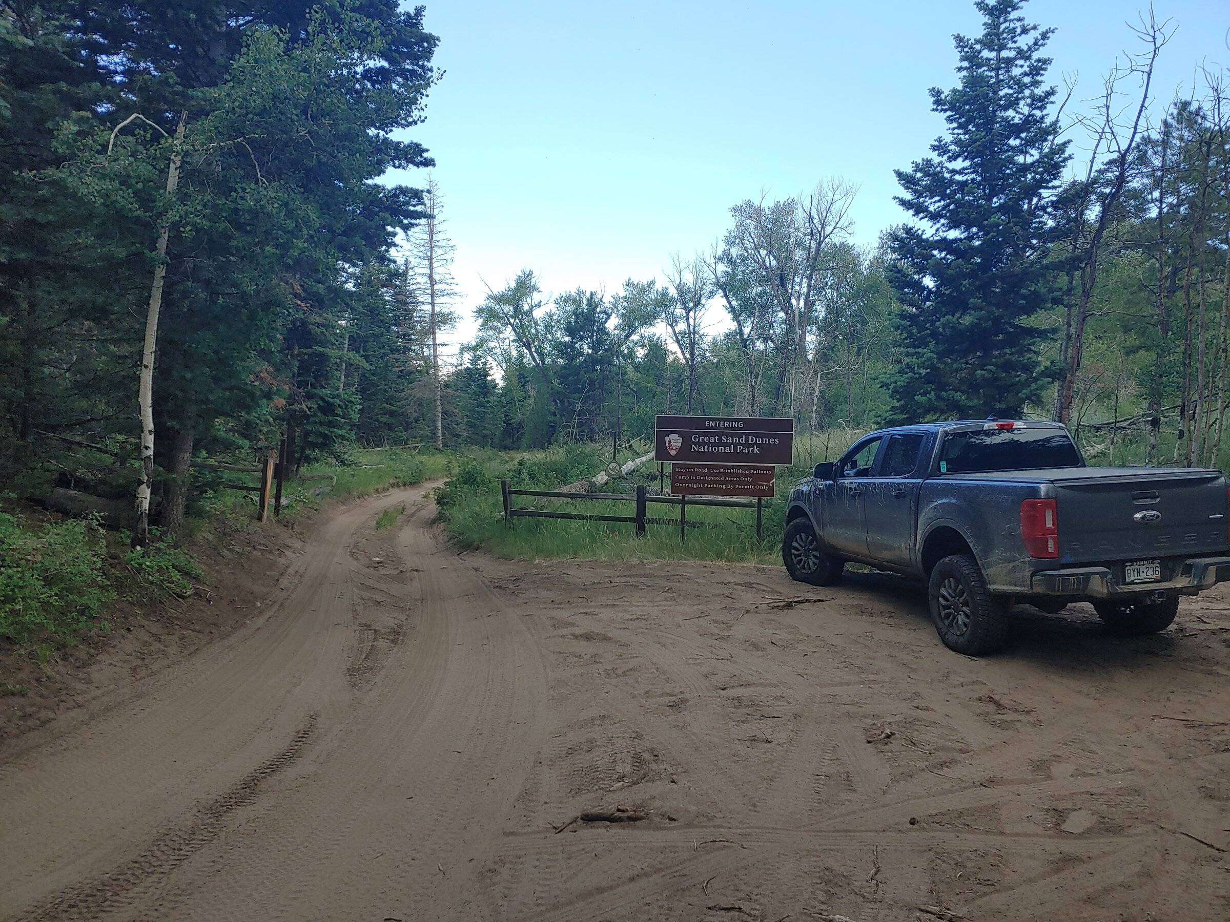

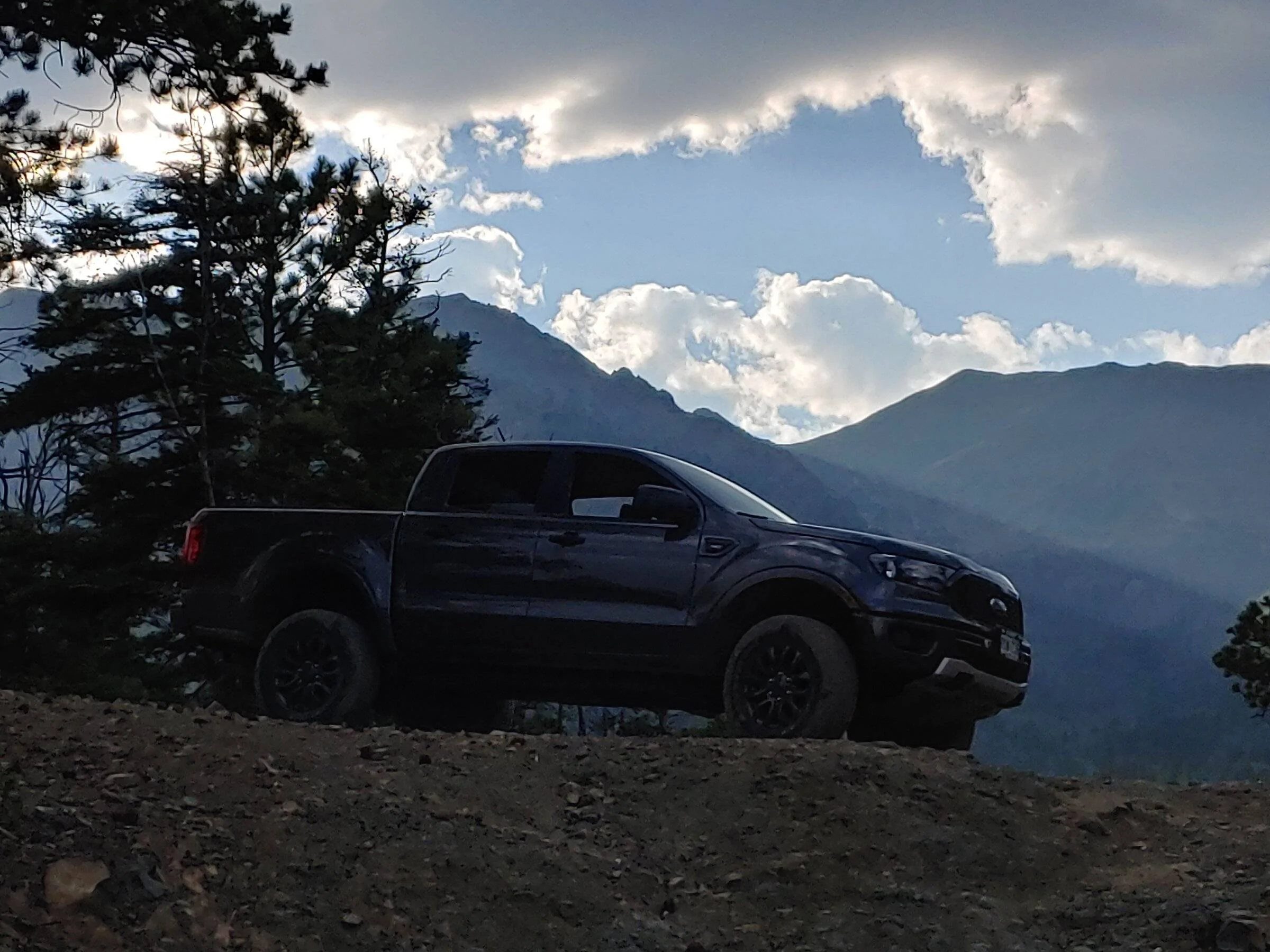

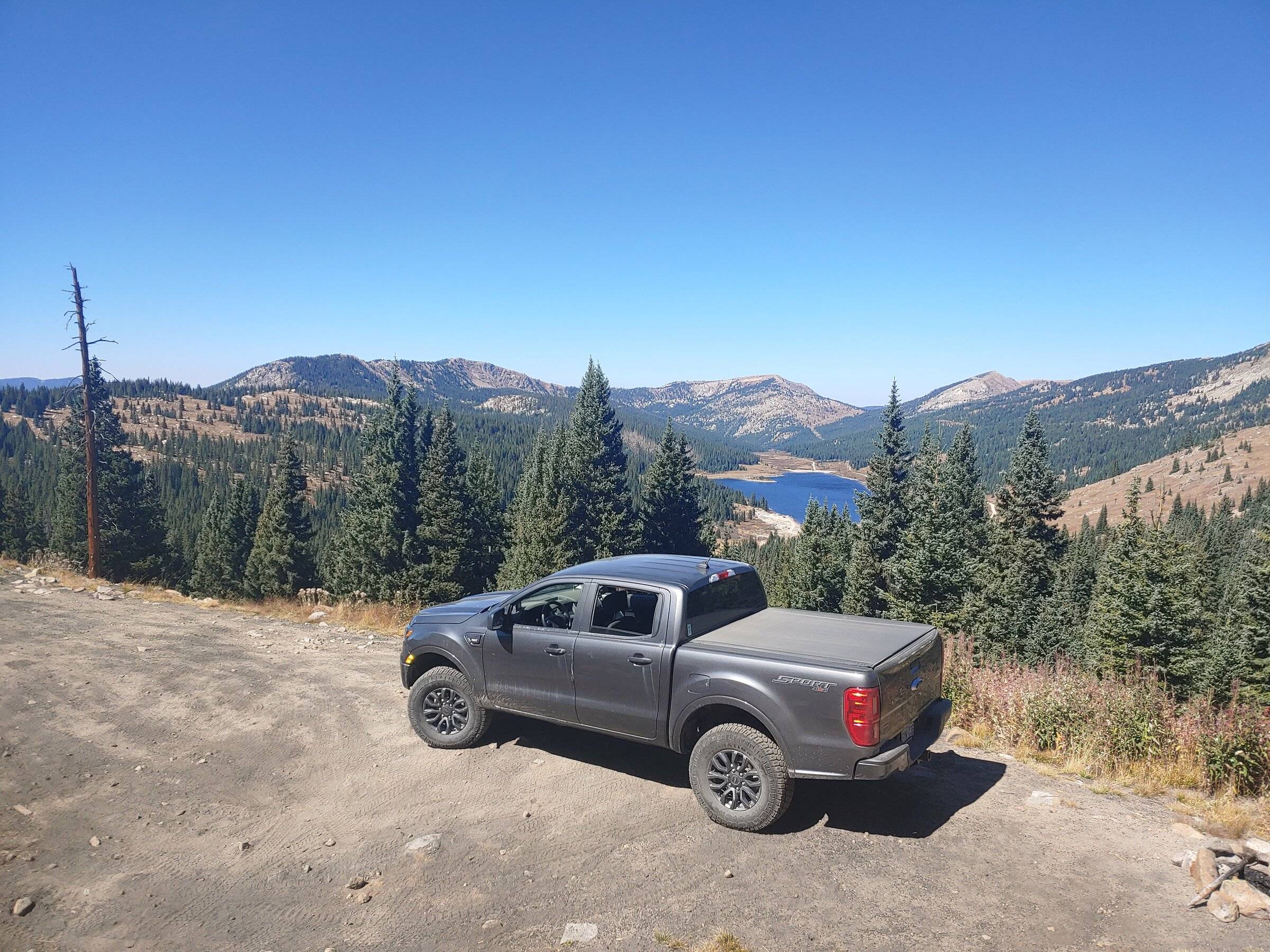

There are a few different kits and depending on your willingness to spend will depend on the route to go. I myself chose the Nitrocharger Sport basic kit for my truck. The total lift was 2.4 inches front and 1.6 inches rear. What that is in MM I have no idea. The basic leaf springs will allow up to 780 lbs in the rear before leveling the truck. The next level leaf will allow a constant load of 660 Lbs while at lift height(and probably up your alley). In general I really liked the suspension as it had a nice ballanced feel.
The next option is the BP-51 kit. That is the best but also.most expensive kit available through ARB. The shocks are far superior to the Nitrocharger shocks(and other non adjustable shocks). I was hoping to run this on my truck in the future but the truck didnt make it unfortunately....
Here are some pictures of my truck with the kit including towing and with 32 and 33 inch tires.
The cool looking tire is the Firestone Destination XT in 285/70-17(very nice tire to say the least)
