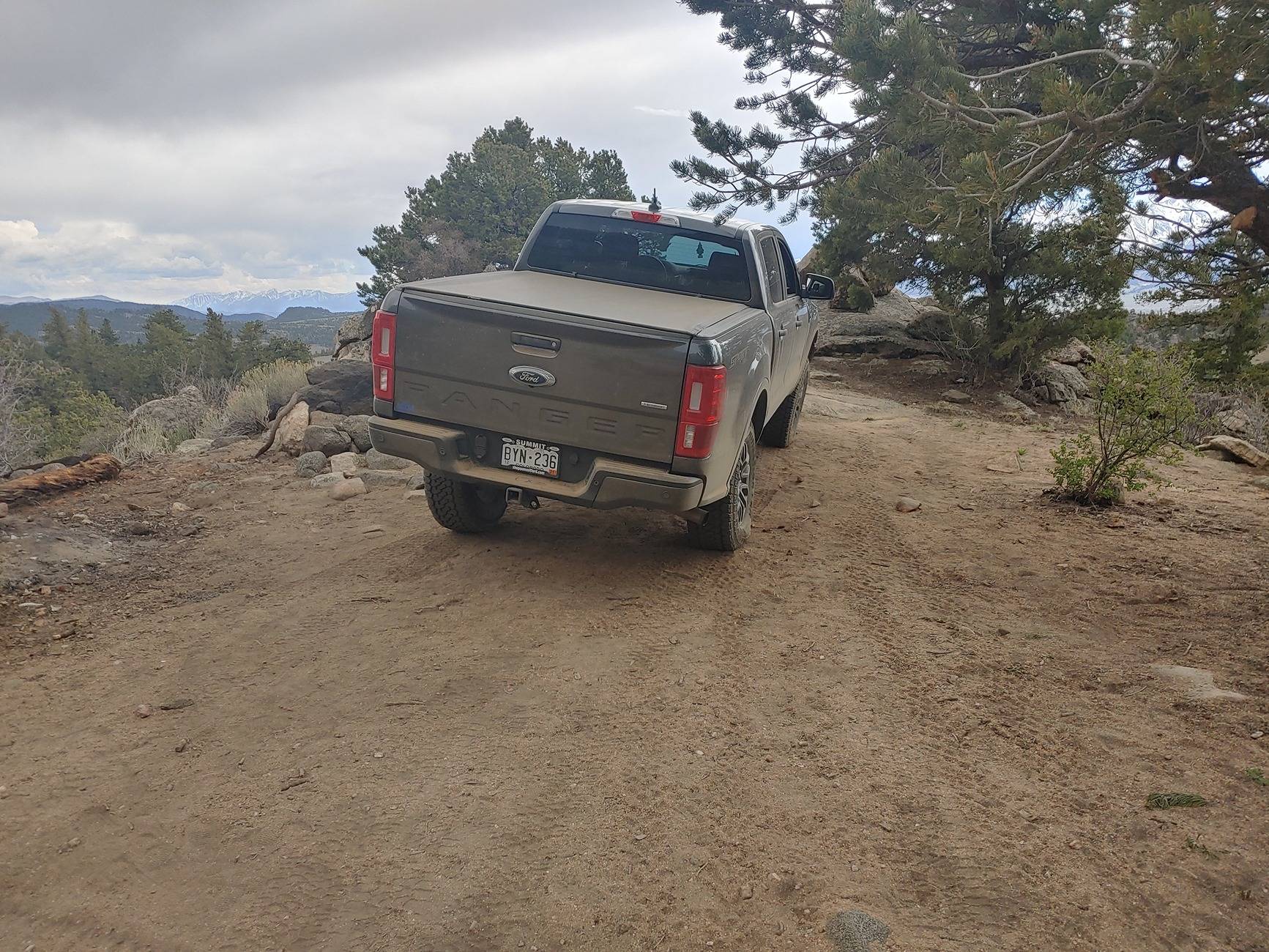

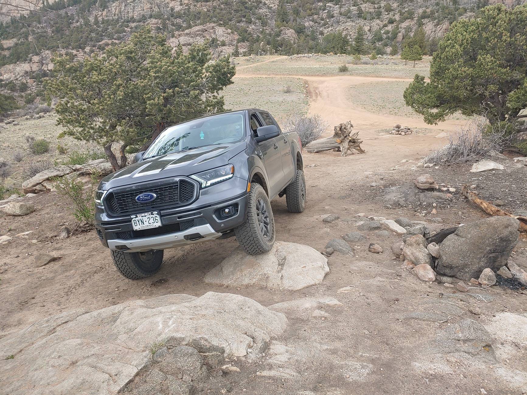

Seriously?! Even you should know this one. Assuming you don't have one of the OffRoad Flex Ramps that sometimes go to car shows, you simply start jacking up a front tire until the rear tire on the same side starts to come off the ground. It's that easy. At that point you get the measurements front the top of each tire to the top of the fender well.
In pictures below you can see an example if you were to simply drive up a good rock and get the same results. This was with 32's and the Old Man EMU Nitrocharger Sport lift(yes that includes the leafs).
