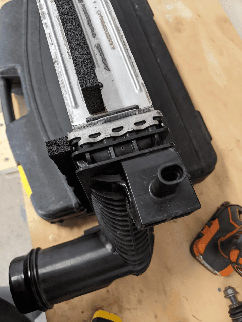

I took my inter-cooler off yesterday and a slight amount of water and oily residue came out. It was mostly clear, not dirty looking like i've seen in other photos online. I decided to put the weep hole in it and see how it reacts going forward. I figure I can always just plug it back up if I have issues. If you know what you are looking for, you could do this without removing the intercooler i'm sure.
Here's a photo of the bottom of my intercooler (drivers side) with the hole in it.

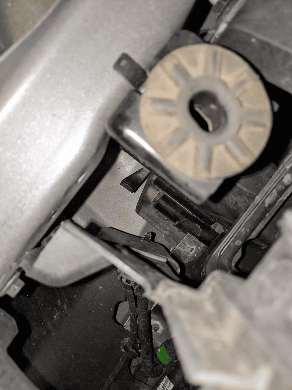

Here's the gap that the 'crud' will be blown down into. The gray metal at the bottom is the skid plate.

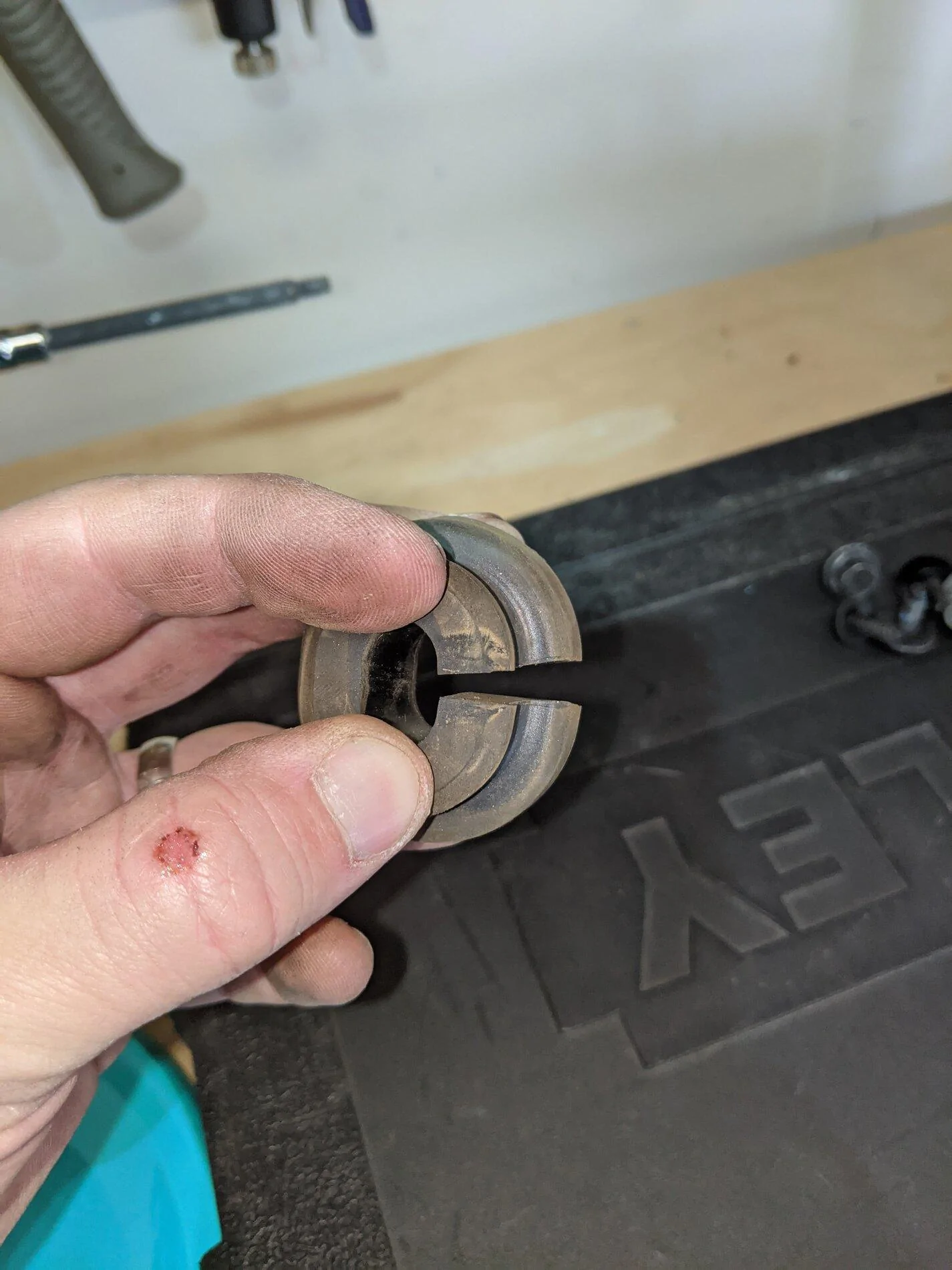

Had to remove the front grill and then press down on the intercooler really hard while pulling outwardly on the top of the intercooler. It still didn't want to come out and took some serious force. I honestly don't know if I removed it how ford intended because I tried for a long time to reinstall it and couldn't get it to go back in without removing the upper rubber gromits, cutting them and sliding them in after the intercooler was back in position. See photo for what I mean by cutting the gromits. I really did not enjoy this process.
